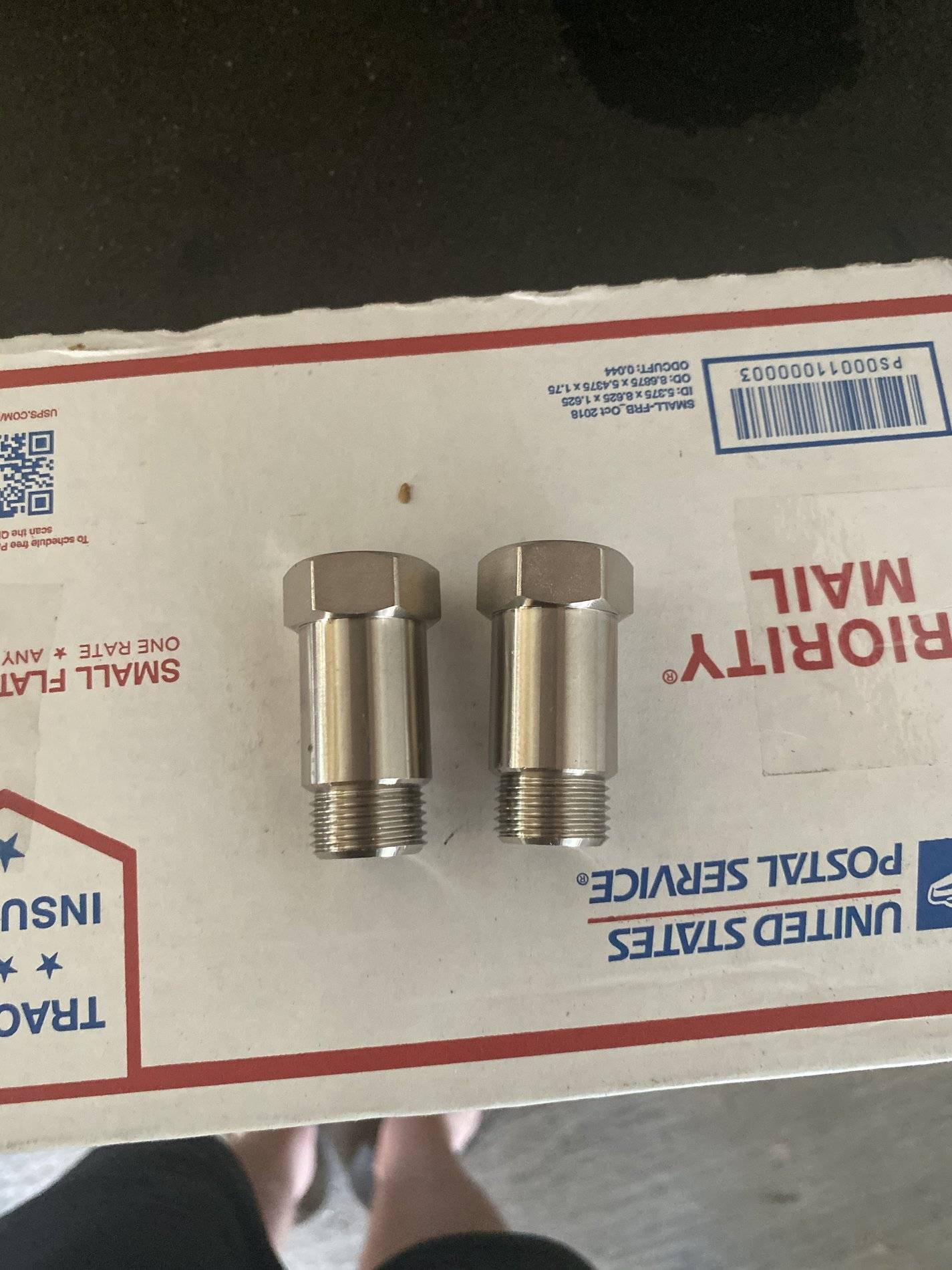

As promised, I do have an update. I got around to getting the spacers in about a week and a half ago. It took me longer to jack the car up than it did to pop them in. They’re nice, quality pieces that BLine machines in house; which is to be expected from them. A picture is attached of the spacers. As of the time of writing, my CEL has yet to turn off. I’ve only started and drove my car maybe 6 or so times since install, so it’s possible it hasn’t gone through enough key cycles yet (I’m kind of ignorant when it comes to the intricacies of ECUs and readiness monitors). I’ll be sure to update again in a few weeks once I’ve had a chance to drive it more.

@MikeMM but you had no cats, correct? Not the high flow cats? From what little knowledge is out there, seems no cats are hit or miss and have not heard of anyone with the high flow cats getting a CEL.

That is correct, I do not have cats. The high flow cats have been out of stock for a while, and will be for the foreseeable future per BLine. The CEL doesn’t really bother me personally, but good old Vermont inspection laws say a CEL is a no-go for inspection.
