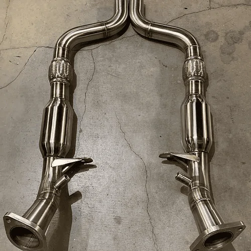

B-Line has a resonated cat delete pipe. But again, guys are getting a CEL from those as well. I personally just don’t wanna deal with that, thus I too am waiting on the B-Line high flow cats.

B-Line wants $1k for resonated test pipes? .... Hard Pass
Can buy M2 headers (made to order in the USA and known good fitment) for much less - about half.
Hell, big brand headers aren't much more. If I'm spending $1k I'd just buy M2 headers and pay for the install. My goal was to buy something not terribly expensive and do the install myself to eliminate the cost and time of installing headers... Seems like that's simply not possible.
