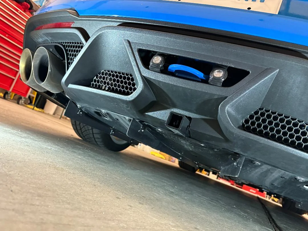

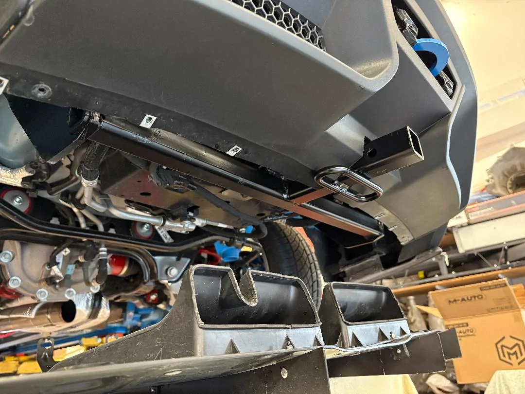

A lot depends on your rear bumper diffuser panel, the straight across Drawtite style might show more than a curved Curt style on a base bumper. I used a Drawtite on my Mach 1 because that particular style is almost completely concealed and simple to remove and install. A two inch receiver might look out of place on a Mustang.

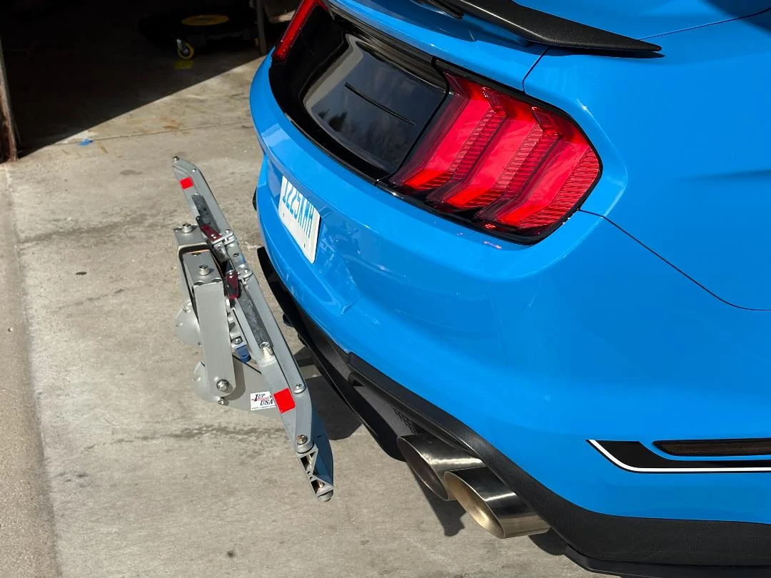

For carrying bikes (as opposed to towing), I would really not recommend an hitch adapter that extends the tongue weight and lever length. It will add a multiplier to forces that are not welcome here.
I agree though I posted the device as one could use it with some caution, it is one thing to carry a couple road bikes (50 lbs) vs a couple e-bikes (120 lbs). I personally would do the former but not the latter with the adapter though I have no experience in this matter.

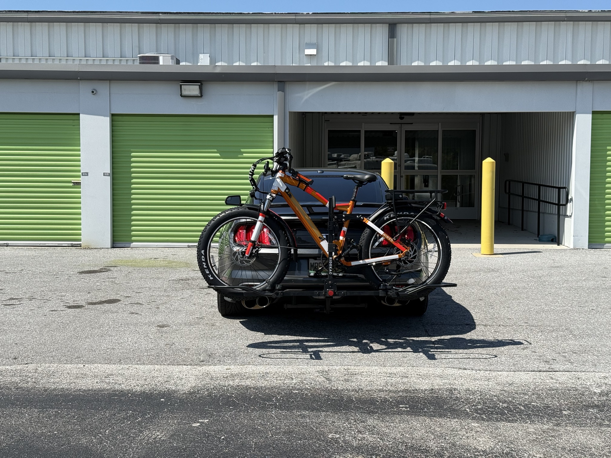

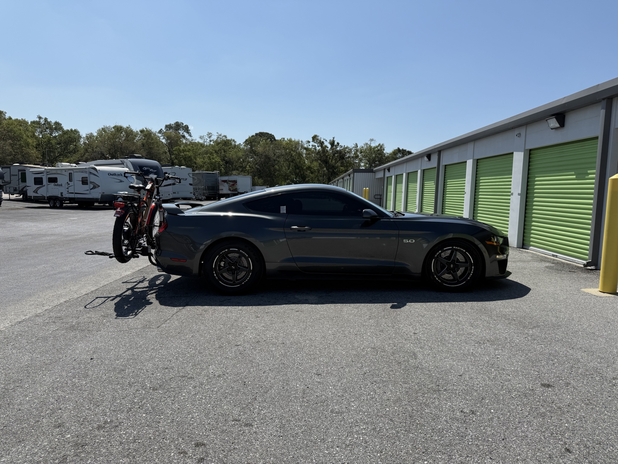

1.25 inch hitch works great on my mustang with my heavy ebike. Also the weight of the hitch helps a bit with traction and overall balance of the vehicle.
I think a 1.25 to 2 inch adapter could work. Depending on how heavy your bikes are. Also get some anti wobble braces.
