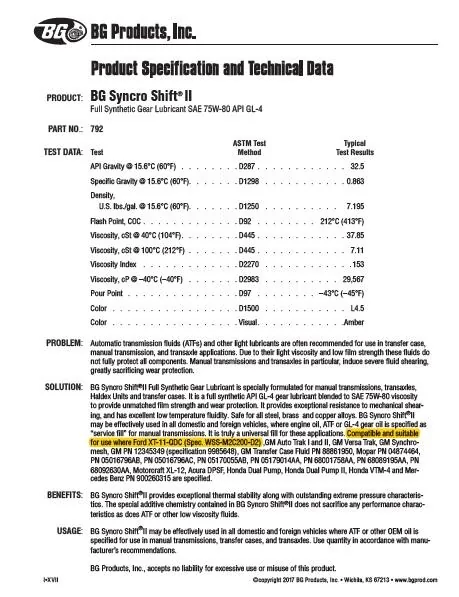

BG Syncro Shift II Updated Spec Sheet
So we are happy to announce that officially BG Syncro Shift II now lists The Ford Specification WSS-M2C200-D2 in the spec sheet (attached)
What does this mean as far as warranty implications from using this product? they are now officially non-existent :cheers:
"Compatible and suitable for use where Ford XT-11-QDC (Spec. WSS-M2C200-D2)...are specified."
:thumbsup:

Tommy, did the product change or was the original product just now certified?
The Product is the same. I just came across this update in their system last night so I have an email into my rep to find out the details. This update was just released last month.
Other than API certifications and Licensing from say GM, for their Dexos label most of the specifications from Manufacturers are just that. Specifications. If the oil meets the spec. that's the end of it. BG has been in GM and Ford dealer service departments for years and most consumers would not know that the service department used BG or OEM oil unless they specifically asked. Syncro Shift II has always been a universal fluid, so service departments like that simplicity, it avoids screw ups and stocking every specific oil for every model.
:thumbsup:
Do you know if the same spec applies to the GT350?
No that transmission uses LV ATF :barf: The spec is for ATF (WSS-M97B44-D2)just like the GT500 which used a Tremec and required Mercon V ATF BG suggests Syncro Shift II. BG absolutely will not recommend an ATF for a manual gearbox. The Tremec 3160 in the Shelby is also in the Cadillac ATS which uses Syncro Shift, OE fill is Dexron VI ATF.
So you will never see a an ATF specification on the Syncro Shift Spec Sheet. Two different animals all together. Keep in mind that Syncro Shift came out due to market demand when manufacturers began using ATF in manuals. Yes ATF has great properties that make it add to efficiency of the system but not so ideal for an air cooled GEAR box. The reason newer manuals use similar materials for syncro's as auto's do for clutches is a universal fluid that keeps cost down.
