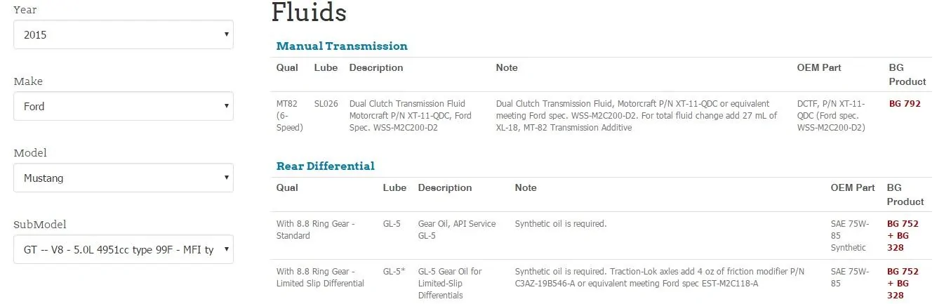

Updated Recommendations From BG Products
I have included a screen shot from my BG Application Guide. They Actually are recommending the 75W-140 for the Rear Axle.
To Help Understand The Part Numbers Listed:
792 = BG Syncro Shift II
752 = BG Ultra Guard Heavy Duty 75W-140
328 = BG LSII Limited Slip Axle Additive Concentrate
We carry the 753 BG Ultra Guard Heavy Duty LS 75W-140 Products which is the 752 with the Limited Slip additive already added in. This eliminates a separate product, service step and the chance for the incorrect mix ratio.
The reason they specify 752 is because Ford Factory Fluids always require separate additives. As seen below the 752 meets the Ford Spec. for 75W-140. The 753 includes the additive so it 'technically' doesn't meet the spec even though it's the same thing once you add the LS additive to the 752. :confused:
"BG Ultra-Guard® Heavy Duty will withstand the punishing effects of extreme heat and arctic conditions and is one of the few polymer-free gear lubricants to meet the stringent requirements of Ford engineering spec WSL-M2C-192-A. It can be used in all conventional and limited slip differential hypoid gear rear axles."
If you look at the Ford Product Information for the 75W-140 it says "It is recommended for conventional and limited-slip differentials of passenger cars, light trucks, vans and buses that operated under mild to severe service conditions"
So if anyone had doubts about running BG Products in the Mustang, BG stands behind it and recommends the products we offer.
Now if you are running our 75W-90 please don't panic, it's a large improvement over the factory fluid, and will be the most efficient fluid. If you plan on tracking your car obviously go with 75W-140.
