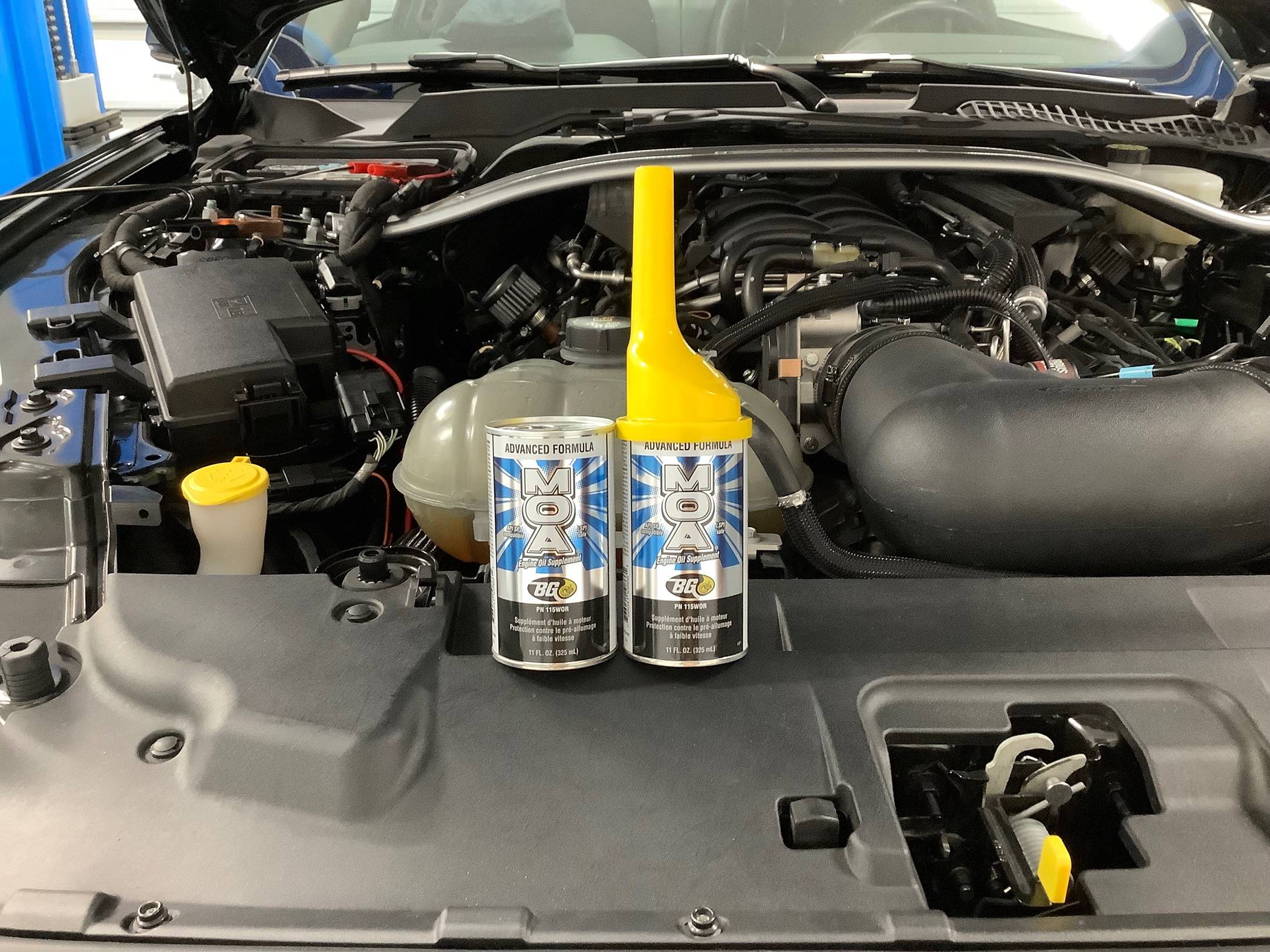

I conducted a search and saw that several years ago, there was a brief mention of the opinions of some, who thought BG MOA oil treatment was good and others, who thought it was a scam.
I just changed the oil in my car yesterday and put in 5 quarts of 5W20. I think I’m going to try the BG MOA (at no cost to me) and see what it does for the engine. With the oil capacity being 10 quarts, BG says add 22 ounces of MOA, which is roughly 650 milliliters, so I’ll add that amount with a little over 9 quarts of oil. My mileage is currently at 8500, as the car has been sitting for about a month and a half.
One thing I am hoping will happen, is the chirping noise at idle will disappear. I read where BG talks about the product being good for VCT components, so we shall see over time.
Has anyone been running MOA recently and if so, what are your thoughts on it? Thanks

If you car is running good with no issues, why would you want to add anything?
To see if there are any good qualities in the product that may be beneficial to my engine. My buddy owns a BG Distributorship and he’s allowed me to try their products (currently running tranny and diff. fluids) in the car, so I figured it couldn’t hurt to give it a try. If the oil analysis that I do on the oil (post MOA treatment) shows that there are no benefits, I will return to my regularly scheduled programming.

Picked up the MOA from my buddy this weekend (two 11 oz cans of it). Upon opening the two cans, I immediately noticed a very familiar and unpleasant smell. Strangely, the MOA smells exactly like gear oil or limited slip additive, although the color was about the same as motor oil. It’s in the motor now, so I’ll be taking the car out this week for a test drive.
I also have my oil analysis test kit in hand, so whenever it’s time to change the oil, I’ll be sending it off to see how things shake out with.
