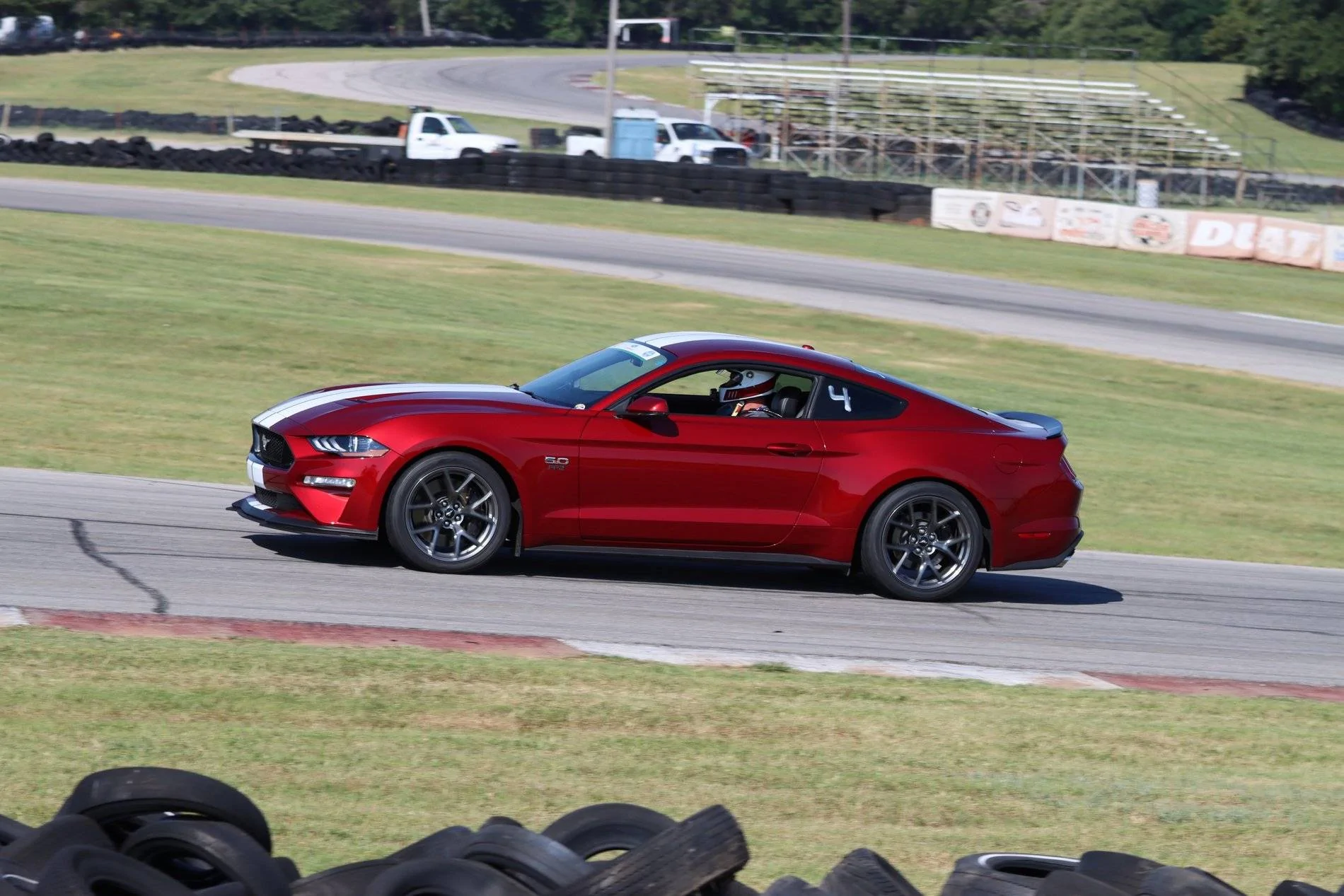

I was really wondering how much better a narrower wheel would be up front for cruising/ride quality. I hear such a wife front tire can cause some harsh trammeling (sp?). Those wheels are sexy tho...
Got a pic of how the nitto's look in the wheels?

I dont have a problem with bad tramming....not saying it won't do it but the road has to be pretty bad and even then its managable.
