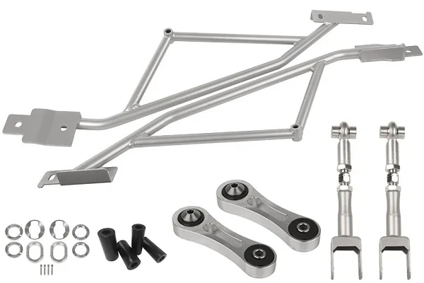

If you are a drag racer at heart & are going to be enjoying the car at the strip - then we have the following packages available:
https://www.steeda.com/steeda-mustang-ultimate-irs-stop-the-hop-package-2015-all-555-2129.html
We have this kit on our Steeda Silver Bullet Drag Car:
Plus, you can see what BIlly Johnson said about it here:
https://www.steedablog.com/2017/07/25/tested-steeda-anti-wheel-hop-package/

My 19 A10 I did the BMR lockout kit, the one that looks like mini traction bars then did upper control arms, vertical links and drag springs from BMR also. Feels way more solid. I did ride in a friends car that had them all but he also had the bushings installed that really lock the rear end. Those I wont be doing because the noise was really noticeable and I did'nt care for that. That was all done the first week of owning it, ha

If you are going to drag race, the key solution in my opinion is drag radials. With street tires, I could launch OK on a prepped surface without hop but it would hop insanely on the 1-2 shift in drag mode. BMR lockout and vertical links didn't eliminate the hop but DRs did.
I have no experience with Steeda's stop the hop kits but their reputation is excellent. If I didn't already have the BMR pieces, I would go with Steeda.

Those steeda products are known to increase vehicle noise. They're more track focused. If you want a balace between little road nosie and reducing wheel hop start with BMR IRS lockout kits.
Btw, I have no wheel hop at 700hp with R rated tires and no stop the hop kits of any kind

I did the Steeda Stop-the-Hop Starter package a few months ago, and it made a huge difference. I'm not much for going straight, as I'd rather have to work for my fun, but it definitely tracks straighter, feels way more planted in the rear end, and has much less hop than it did before. I also swapped the garbage Pirellis for Pilot Sport 4S tires, but you already have those.

Doing those mods also improves handling, not just straight-line acceleration. I have no idea why Steeda doesn't market/advertise those benefits more, but IMO the handling benefits were even more impressive than just stopping wheel-hop.
When that rear-end is truly laterally solid, it makes a huge difference.
