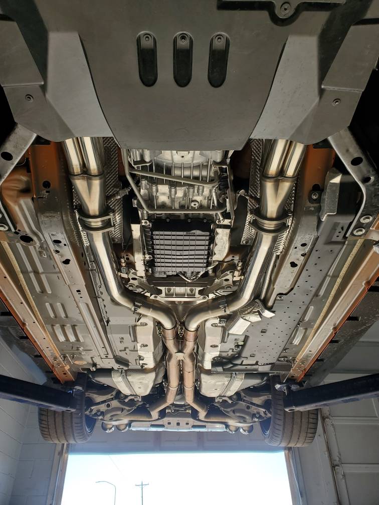

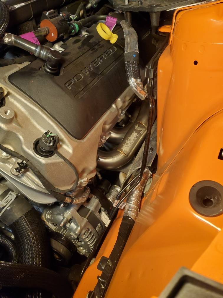

Headers are 2" x 3". Header install on these cars are not for the faint of heart. Takes time and patience. I have zero issues living with this setup. Cheers, Eric

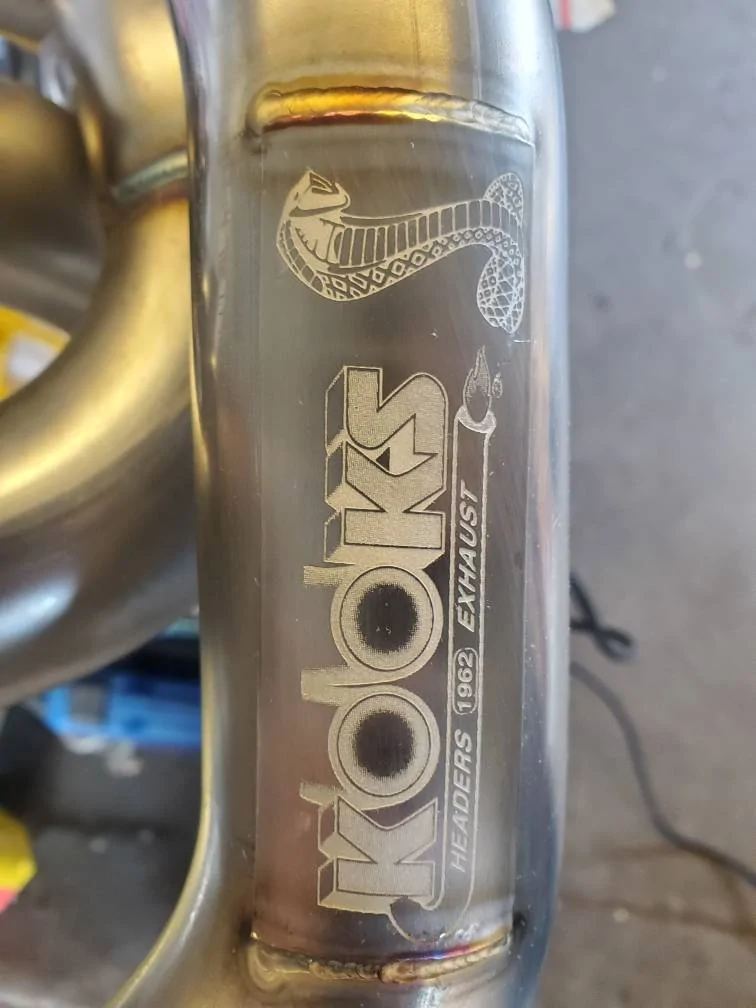

Kooks is the direction I'm going, had a friend do ARH on his 350 and they had clearance issues, believe they eventually resolved it but Ill stick to kooks. I do want to keep or add in better resonators.
