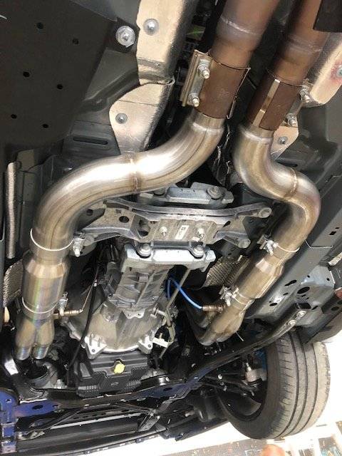

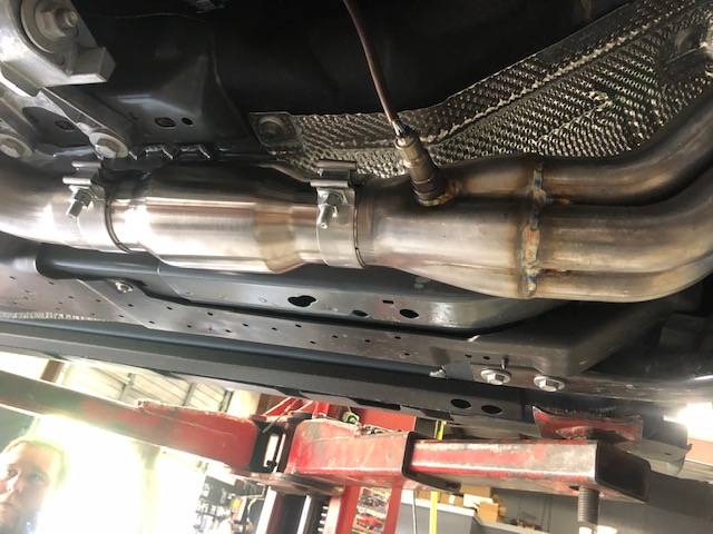

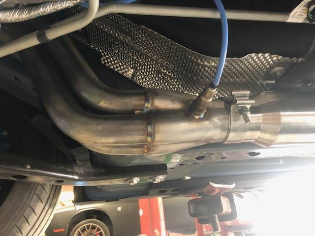

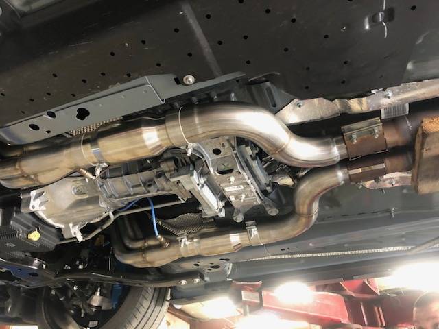

Here are some picks of the headers during install. The Stainless works are beautiful pieces. Aslo pretty cool how modular they are. You can see the high flow cats there clamped up. I have the catless pipe as well. A swap would be about 5 mins. Kinda cool.

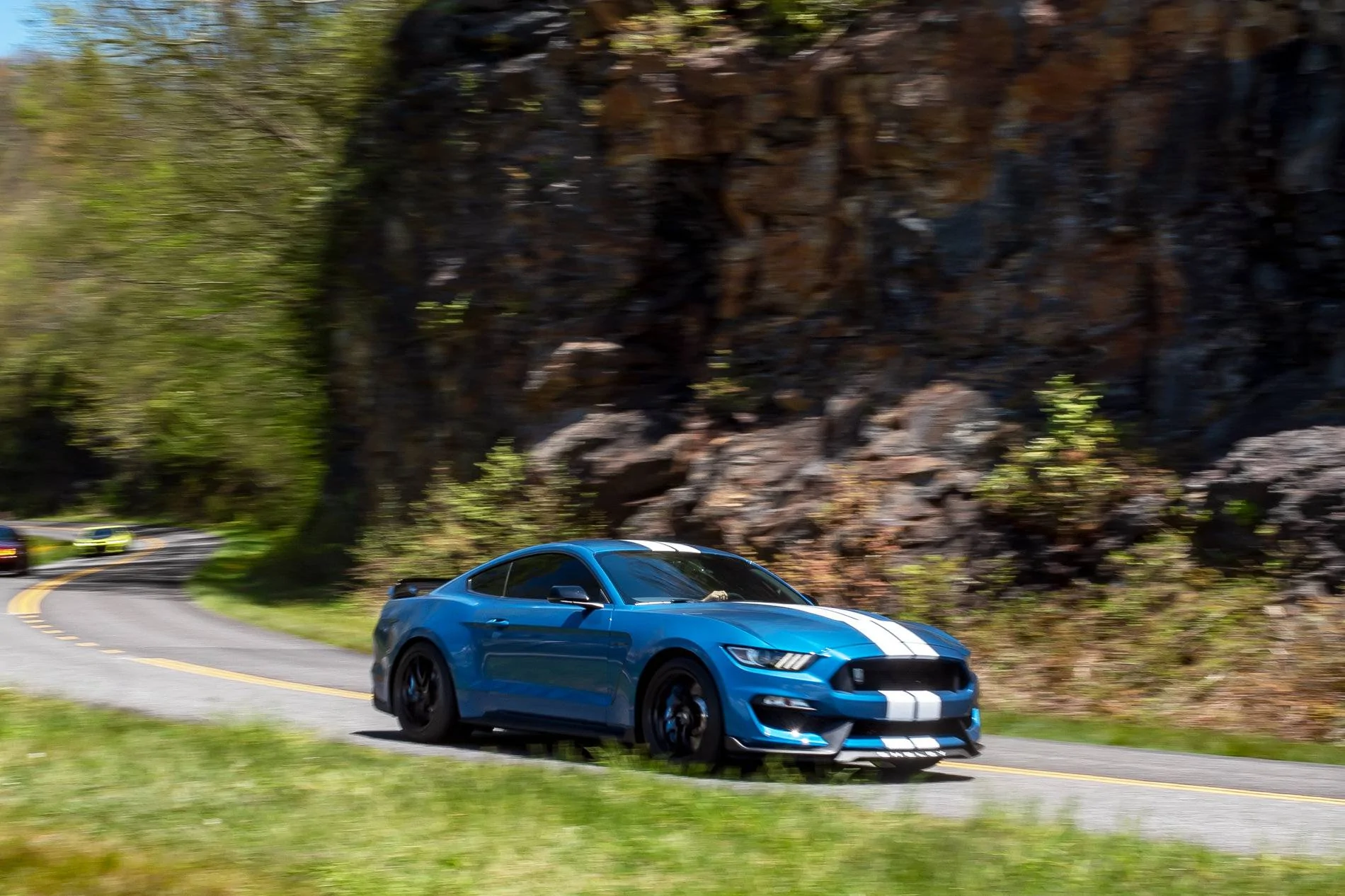

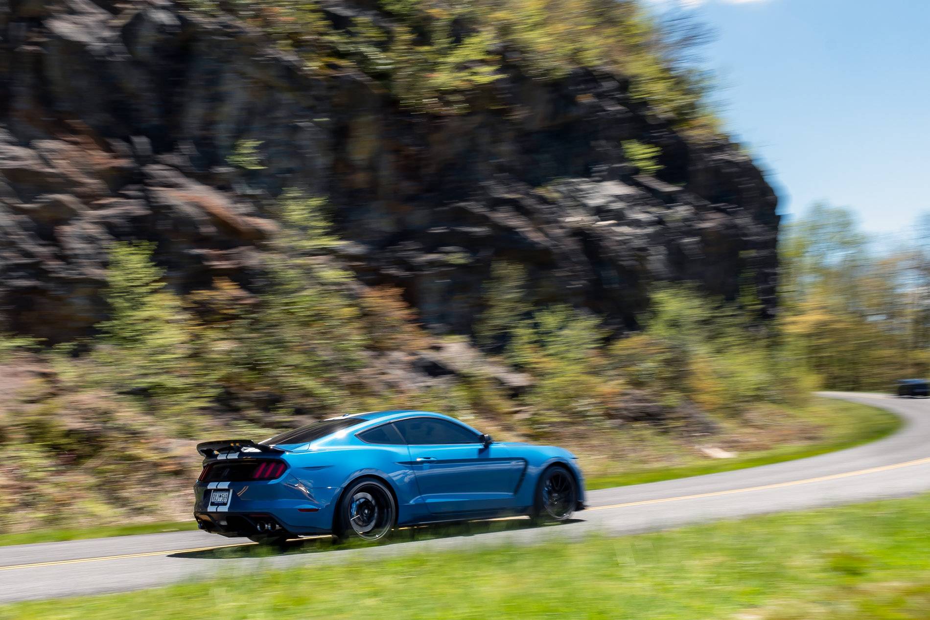

Took her up to the NC mountains. 2.5 hours up with some highway and good roads. 2.5 hours back. Got some good pulls and the top end is phenomenally better than before. I remember thinking the car kinda layed over when you start getting into the triple digits much past 120 coming from big power forced induction cars. Not anymore...she pulls.
Met a group of friends to drive Diamondback (226A). GREAT ROAD! Car sounds unbelievable, better low end torque and had no trouble keeping pace with a ZL1 or a Hellcat Wide body accelerating out of corners. Unfortunately after doing the route a few times I had to head back to SC before we could line them up on the highway. Also the E85 sauce was depleted! Closest station was 64 miles from our start point. Filled up on 93 and drove home. Love that flex capability.

Awesome photos, looks like a great ride with awesome company. Did you dyno the new combination?
