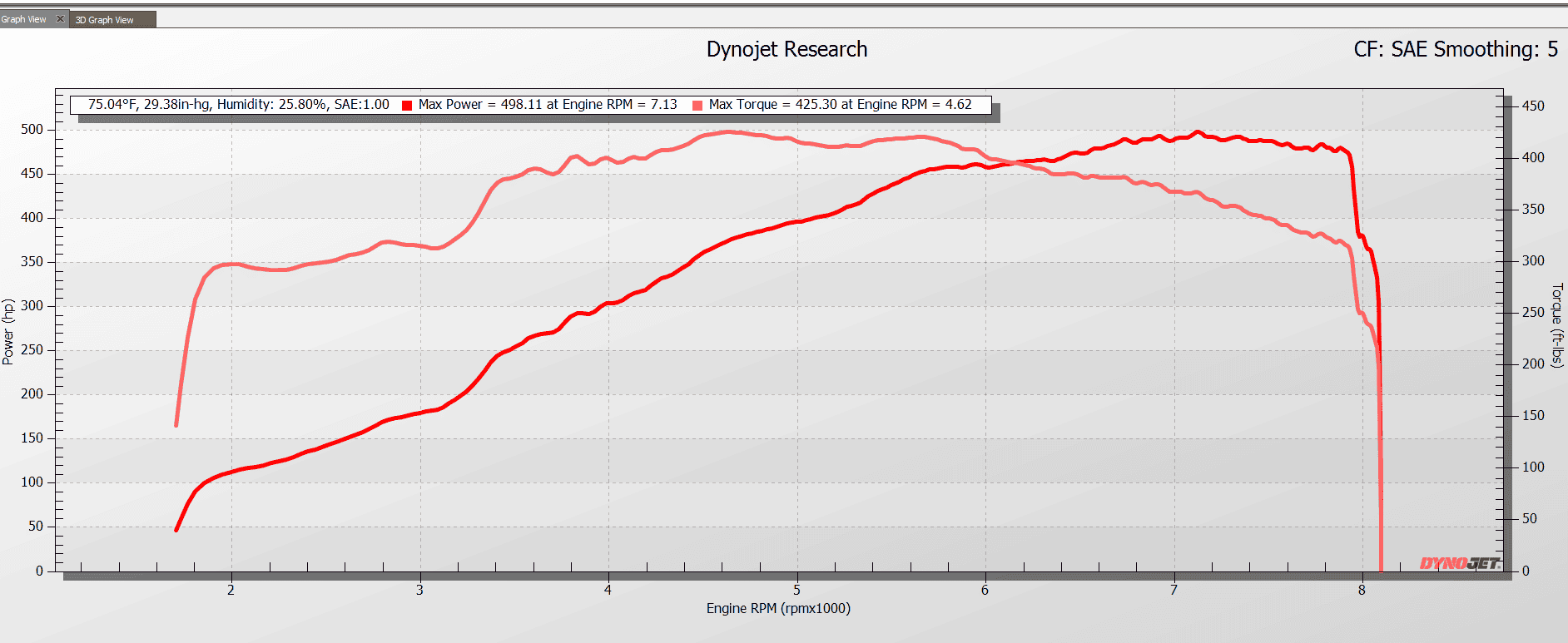

    Since this was posted as STD #'s instead of SAE, what was the correction factor on these runs? Ambient air temp? Coolant temp? That's conveniently hidden by the video window when the dyno chart is posted and none of those other factors are discussed or disclosed.
    Also, was this run on "pump" E85 or "race" E85 like Ignite or One Ethanol? That definitely matters because the latter can allow for additional timing to be thrown at the car that it normally couldn't safely see otherwise.
    How much timing was seen by the car and is this a calibration that you would supply to every customer or is this simply a "wring it out" calibration to where it's only really something to show dyno #'s and not be real-world liveable?
    The reason I ask these questions is that posting stuff like this can be deceptive and leave customers disappointed when they don't get the same results and/or within a reasonable percentage of it.
    Not attacking you guys as I like seeing your videos and stuff, I'd just like those items I pointed out addressed so everyone has a clear understanding of what you're claiming.

    We attached the SAE graph with conditions. Nothing was conveniently left out. I do understand that most people try to hide stuff but with our reputation we don't do that kind of stuff.
    [/QUOTE]Also, was this run on "pump" E85 or "race" E85 like Ignite or One Ethanol? That definitely matters because the latter can allow for additional timing to be thrown at the car that it normally couldn't safely see otherwise.[/QUOTE]
    Pump E85 and from what Dan said you can't throw more timing in the other fuels. Unless you have bad or low grade ethanol like E20-30 or something. Once you get to a certain point the knock effects from Ethanol start to diminish as the content goes up. Dan Said there is a SAE paper explaining most the gains are when you cross the E30+ threshold.
    [/QUOTE]How much timing was seen by the car and is this a calibration that you would supply to every customer or is this simply a "wring it out" calibration to where it's only really something to show dyno #'s and not be real-world liveable?[/QUOTE]
    This car came off the dyno and the customer is still rolling with this cal. We don't do "Dyno number cals"
    [/QUOTE]The reason I ask these questions is that posting stuff like this can be deceptive and leave customers disappointed when they don't get the same results and/or within a reasonable percentage of it. [/QUOTE]
    Remember all dynos are not created equal we are constantly not posting number under other people. We make the calibration right and the numbers what they are.
    [/QUOTE]Not attacking you guys as I like seeing your videos and stuff, I'd just like those items I pointed out addressed so everyone has a clear understanding of what you're claiming.[/QUOTE]

    Thanks for posting up the SAE chart showing those results with the temp/humidity included. The charts used in the video clearly show it being "STD Smoothing 5" so that's why I made the comments/post asking what I asked.
    Not saying you guys did this, but too many people out there post SAE Smoothing 5 baseline #'s and then post STD Smoothing 5 post-mod results making the gains look exceptionally exaggerated like you have some sort of magical tuning trick that some other tuner doesn't have.
    498rwhp SAE Smoothing 5 seems a little closer in-line with what others have seen with a dedicated E85 tune on an otherwise stock vehicle.

    Not a big deal, we would rather you ask questions and get the proper answers! Baseline was also done in STD as well
