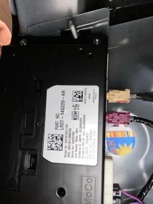

2020........Trunk, behind the drivers tail light, found this wire with white connector just hanging out.....electronic black box in pic had
no openings for it..........any clues as to what it's for?
Thanks

Yes. What year is your car?

While you have it all opened up, pull the other coax out and zip tie both of them back.

Edited.......so would that unused wire be for a radio NAV option GPS antenna?
Again, its all in the thread I linked you to.
No, it is one of your cellular data antennas. Do you have a shark fin roof antenna or a low profile antenna?

23 pages.........just looking for the simple answer.....smh, sorry, but I don't know the secret handshake.....it's the shark fin......so if it's unhooked I guess I don't need it as that's the way it came from the factory.......was just curious.......thanks

Searching within the thread is an option. Really narrows it down.
Edit: Ugg, with the new style forum, I don’t have the experience to further advise. Good Luck!

One lead goes to the planar F cellular antenna in your shark fin and the other goes to another planar F celljlar antenna on your parcel shelf.
Good luck to you whatever you decide.

Thanks Tom.....finally finished reading that and all the sub-threads.....my head hurts....thanks to you all that helped with the heavy lifting on that topic........

All the best. If you have any questions, give me a shout.
