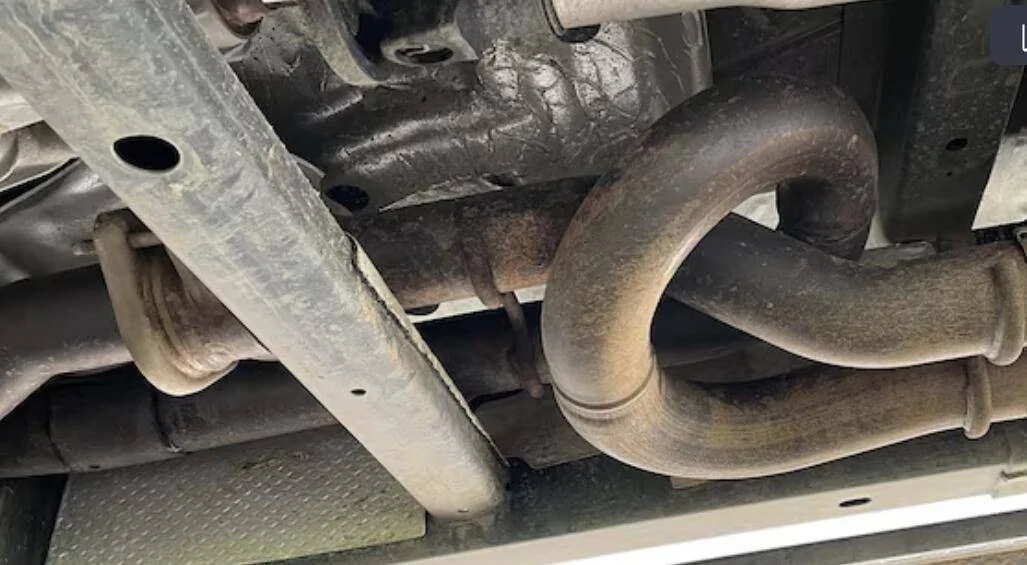

To transfer the F150 firing order to the mustang would have a lot of, uh, challenges. Especially if you consider the individual cyl knock control, GDI timing, cam grinding, etc. Plus I really don't think the firing order change, short of an FPC, would change the sound much. The real reason the F150 sounds different is that the length of the exhaust from the head to the tailpipe is different for each bank.
In any 90 deg crank v8, the firing order is L-R-L-L-R-L-R-R, thereby having 2 cylinders on each bank on the exhaust stroke simultaneously. Since these have 90 deg of exhaust stroke simultaneously, the exhaust pulse at the collector comes through as one big pulse that, of course, alternates between banks. These big pulses exit the mustang tailpipe alternating evenly since the Left and Right banks have basically the same distance to travel to get there.
In the truck, both banks converge into a single pipe on the passenger's side, so the driver's side bank has a longer distance to travel to get there. This means that at times, the big pulses from both banks collide at the Y-pipe, combining to make one even bigger pulse every cycle.
Some like the sound of this, but in the case of a V6 it can sound rather nasty. This is why the latest Raptor and certain Jeeps have what they call a "trombone pipe" that just adds length to the passenger's side pipe by making an exhaust loop, evening out the piping lengths from both banks. IMO this sounds much nicer, especially with a V6.
I've actually been tempted to build something like this for my Roush truck to get it to sound more like a Mustang, but I see that opinion isn't popular in this thread.
