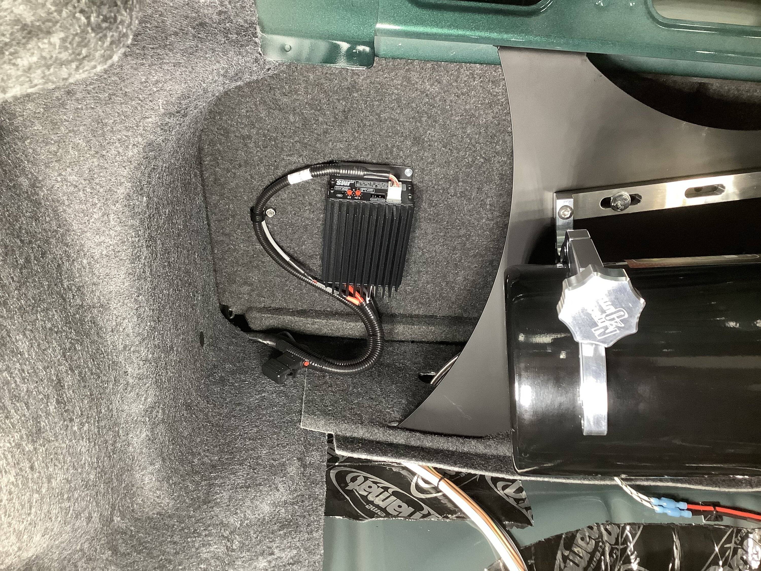

I mounted mine on the back of the left rear seat, where it has plenty of air to stay cool.
Looks clean. I'm leaning towards the trunk area too, but under the package tray area mounted upside down. Where it looks like your bottle mount is located.
Is yours programmed to hit 22V, or did you limit it to 18V only?
Thanks. Under the package tray is also a good spot. I’m programmed to hit 22V.
