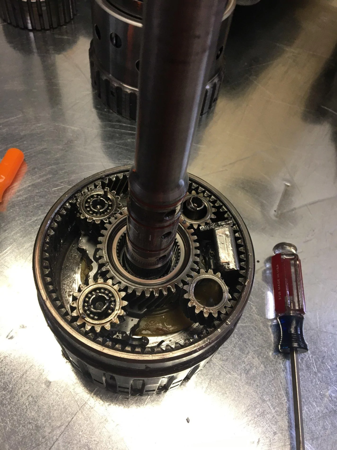

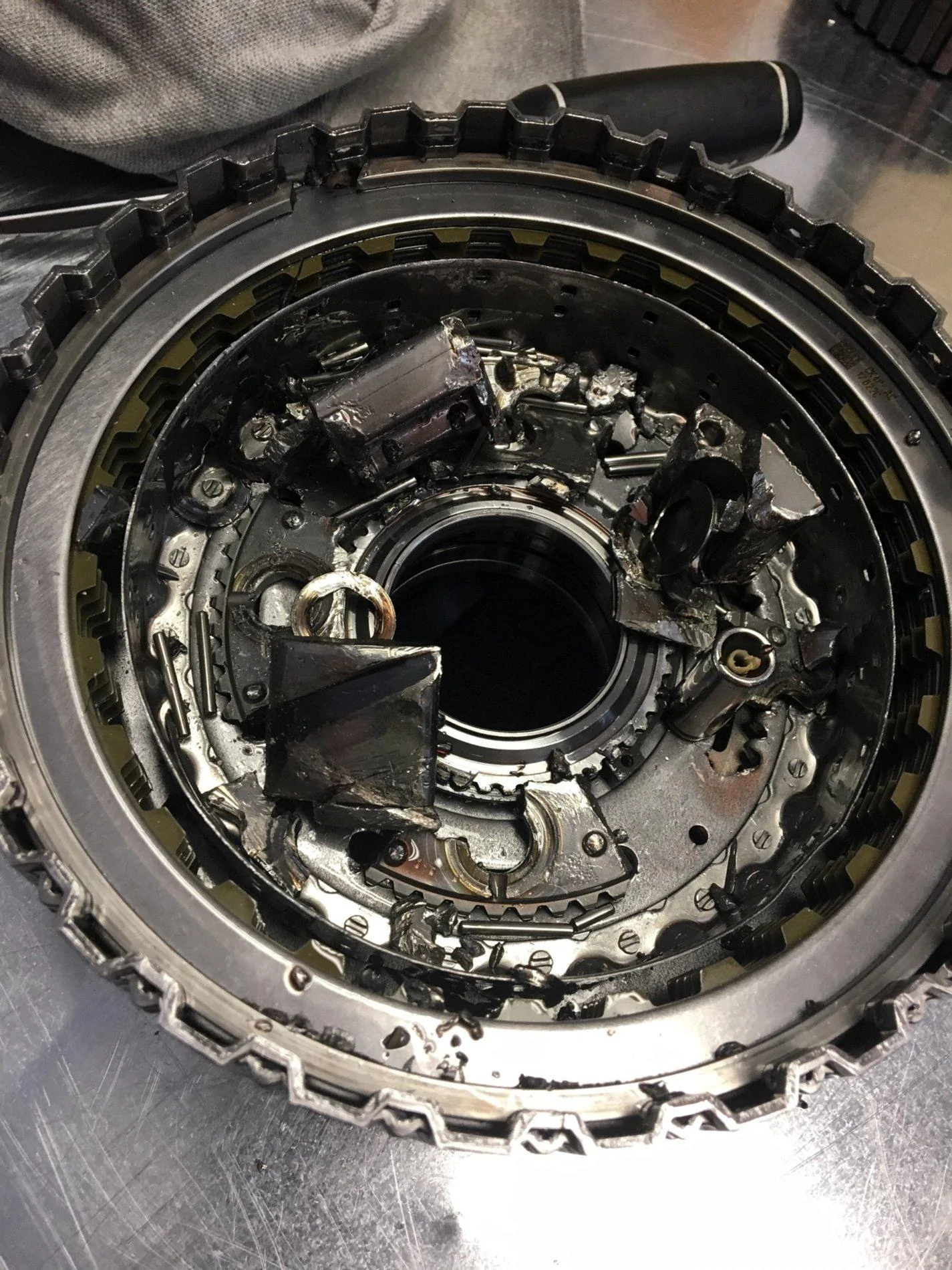

UPDATE!!!!.Well took the trans apart today.Planetary blew apart.5k miles on trans 750 rwhp 90% of its life,the last month and at the track the car was probably making close to 850 rwhp.Just a heads up,if your planetary goes u will likely need a spare parts trans for some of the hard partz that also get damaged.My buddy Kens took and some pics and i will see if he can upload them so u guys can see what it looks like when the forward planetary lets go.

Damm man yea sounds like u have bad luck like me.Car had 1000miles on it and broke convertor and now going to cost 3k to rebuild the trans and thats with me and me buddy doing all the labor.My 15 pp i wiped the motor out and just got rid of it lol.

Yea man billet planetary input shaft and clutches and steels.Listen to what the trans tech who builds yolo's trans,at power by hour.What he says in that video sums it up.These trans are not gojng to hold up lkng at 800 plus rwhp.Actually he says less but take his word for it lol.
