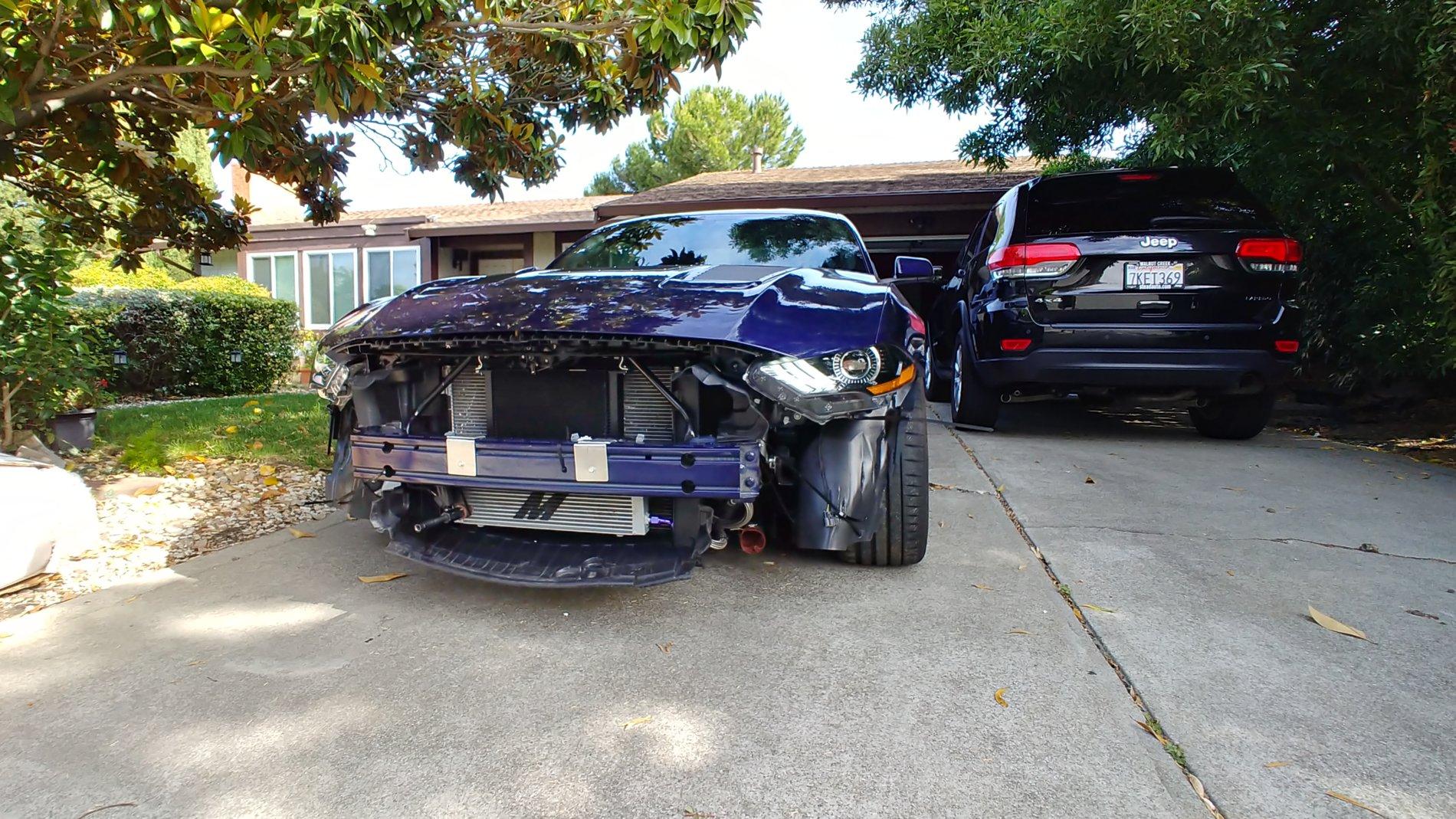

Mew trans cooler installed for my new 10r80. Test on track(roadcourse) june 30th .
Stay tuned .
