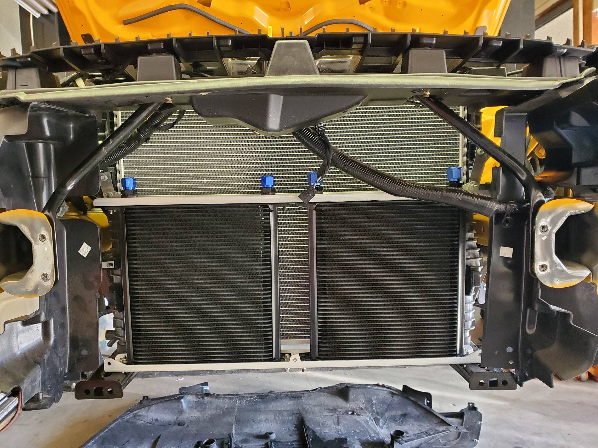

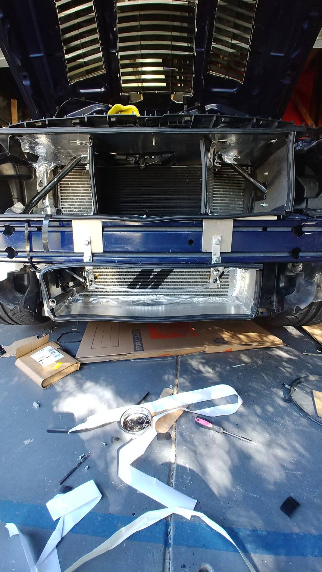

I feel your pain.
Ducted everything
Oil cooler
Bigger radiator than pp
Hood vents
Water spray on coolers.
Still overheating.
I'm installing a second oil cooler soon. Still figuring out where. You luckier cause i have a big trans cooler too for the A10.

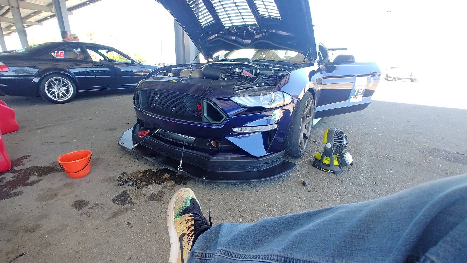

I stopped before going in limp mode. I now can track the car in normal weather, like 60 / 80 f, without any issue. Unfortunately when the weather is hot like 90 to 100, the car suffers. CHT goes up to 240, and like Brian said he's mainly due to the fact that you pile different coolers in front of the radiator. The 2018 front bumper doesn't really allows you to have side pockets in 350 Style, so the only way to set up coolers on the side is 2 cut or open the front side bumper. I have a real gauge for the oil temp and I know that's the algorithm calculating the temp in the Mustang is at least 10-15 F wrong when you have an oil cooler. So one of the problem to fix will be, after keeping better under control the oil temp, find a way to bypass the limp mode created by too high oil temp. I must say, Camaro platform especially the 1le is a way better platform for the track. I really don't understand why ford engineers did this without considering a real Track Pack.
