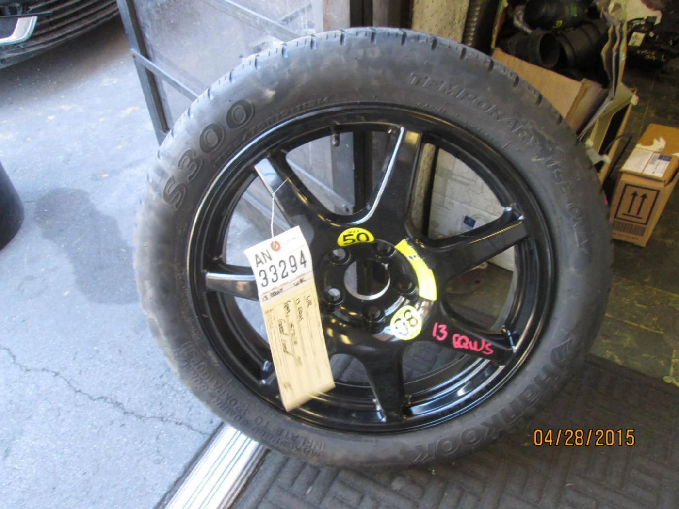

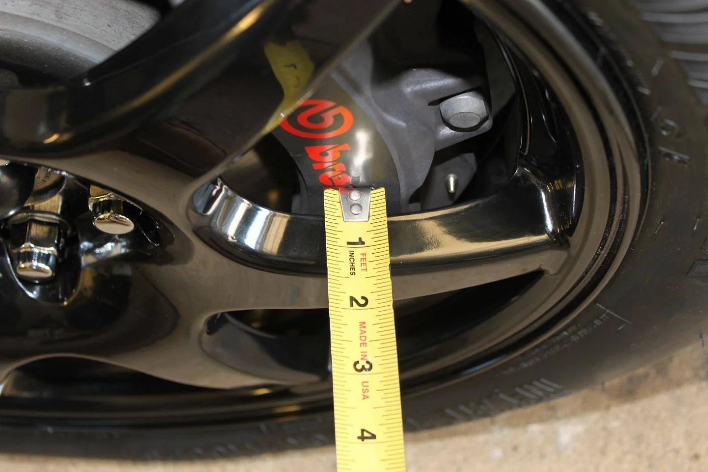

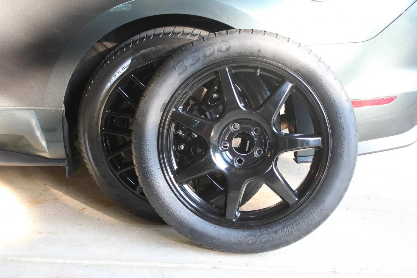

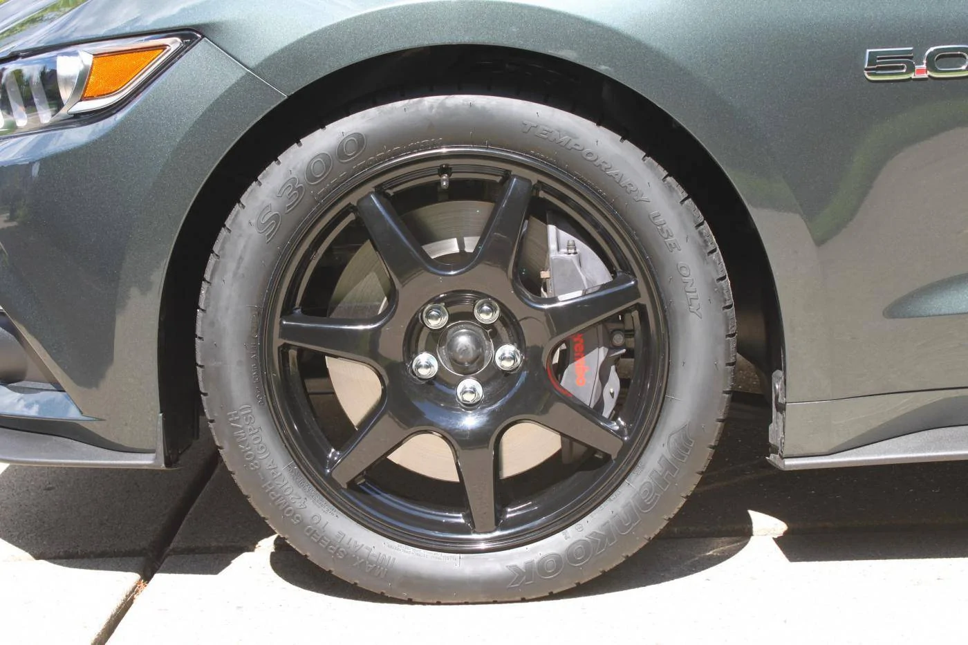

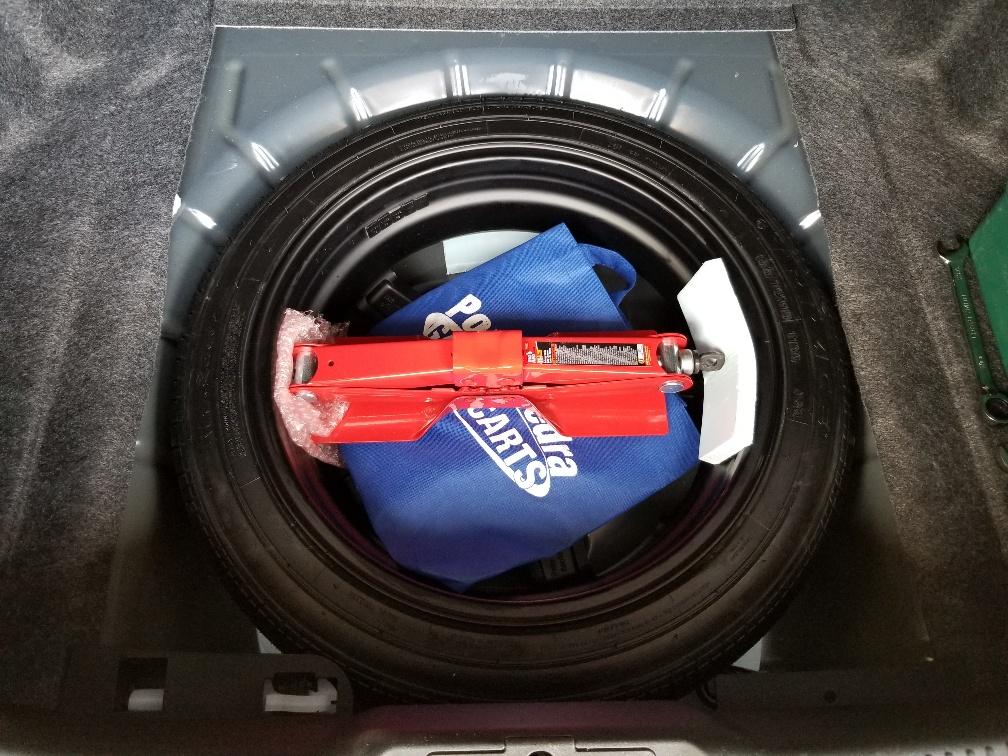

I know this is an older thread. But here are some pictures I found of the Hyundai Equus 19 inch spare posted online.
9546756_9162493372330998090_o.jpg?_nc_cat=111&_nc_ohc=IkDpd5OfhB4AX_EwuZR&_nc_ht=scontent-lga...webp
7906715_8374280958950400622_o.jpg?_nc_cat=104&_nc_ohc=Piu3Uq0S_yIAX9gaKiV&_nc_ht=scontent-lga...webp
7186697_2690723892896864077_o.jpg?_nc_cat=103&_nc_ohc=IWuGIg2Lbl0AX-D33xR&_nc_ht=scontent-lga...webp
6066669_8124248742358440394_o.jpg?_nc_cat=102&_nc_ohc=-0vV47bkYgMAX84QR4k&_nc_ht=scontent-lga...webp
5146646_9190707187181493592_o.jpg?_nc_cat=103&_nc_ohc=HpAchaq1g80AX_pA7fE&_nc_ht=scontent-lga...webp

I know this is an older thread. But here are some pictures I found of the Hyundai Equus 19 inch spare posted online]
I got my Equus wheel/tire assy for $155.00 total shipped and hub bored.
