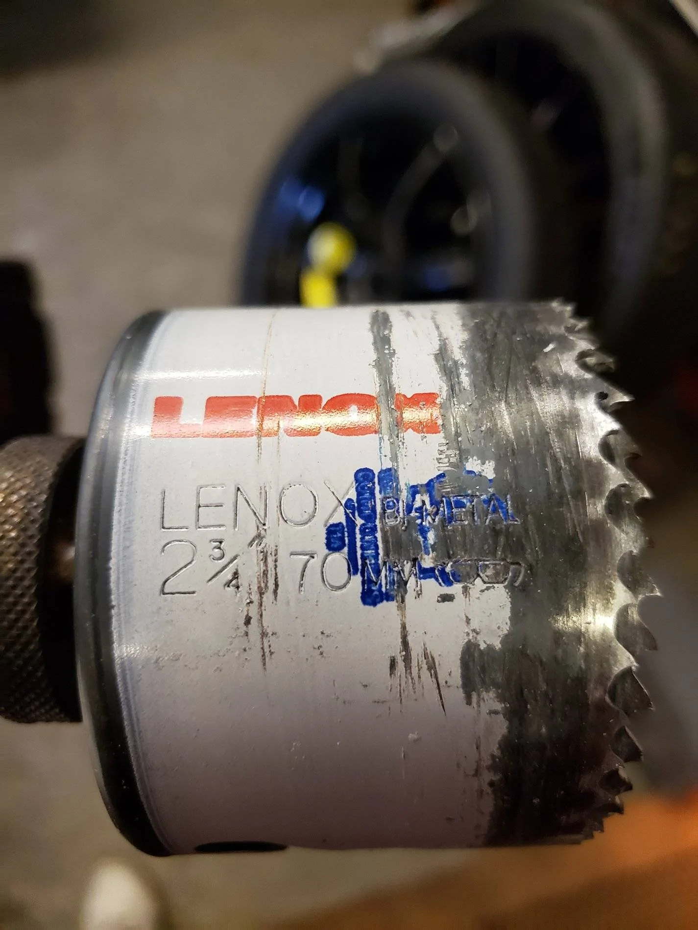

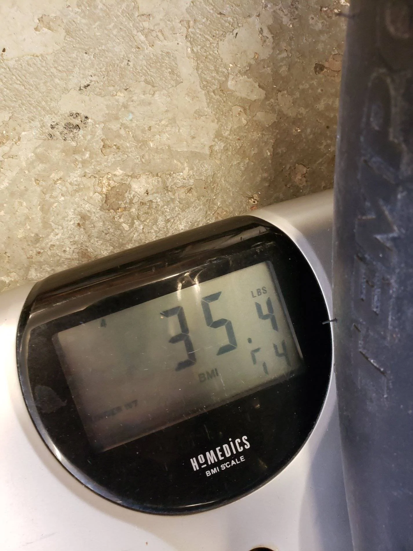

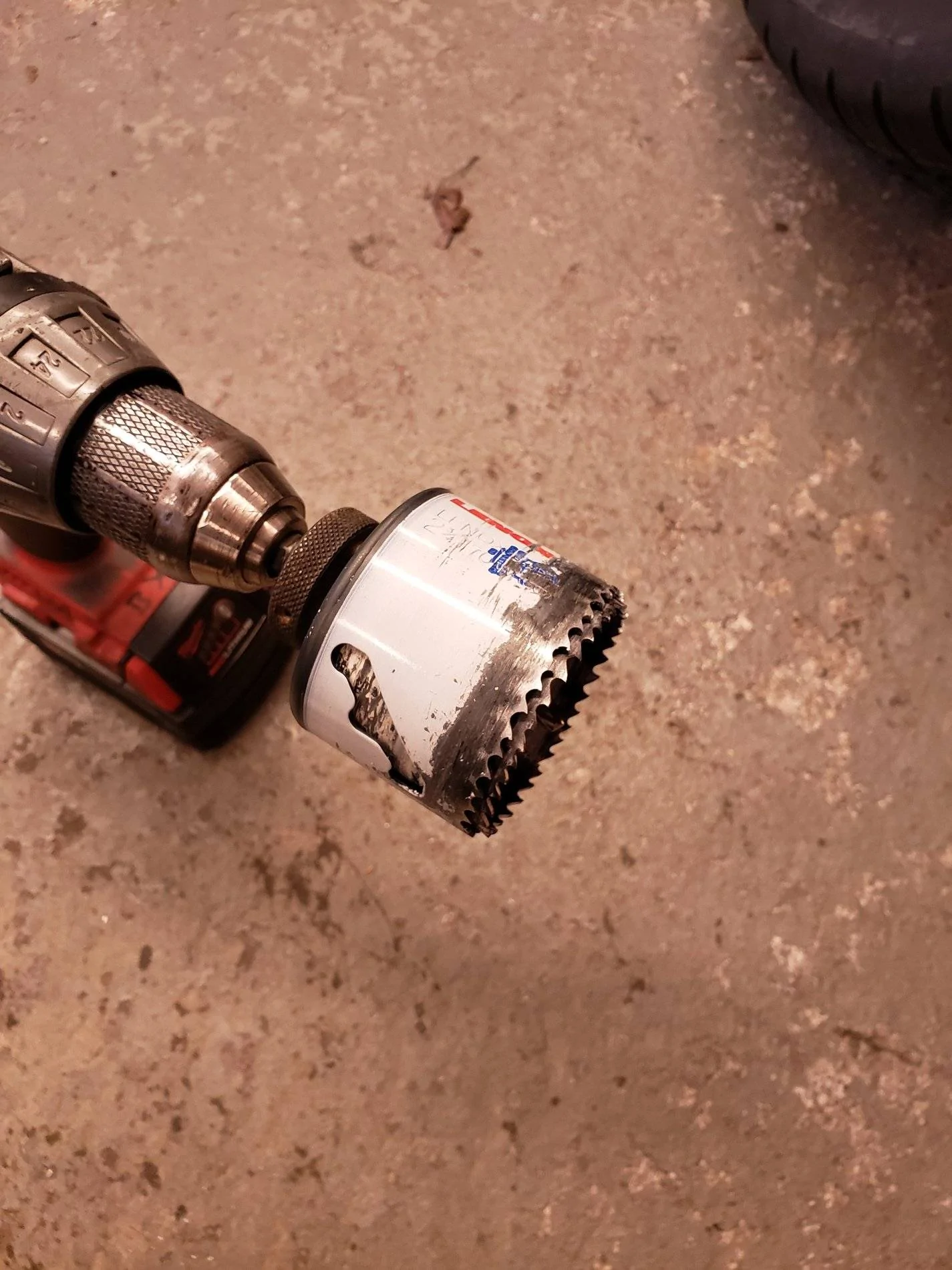

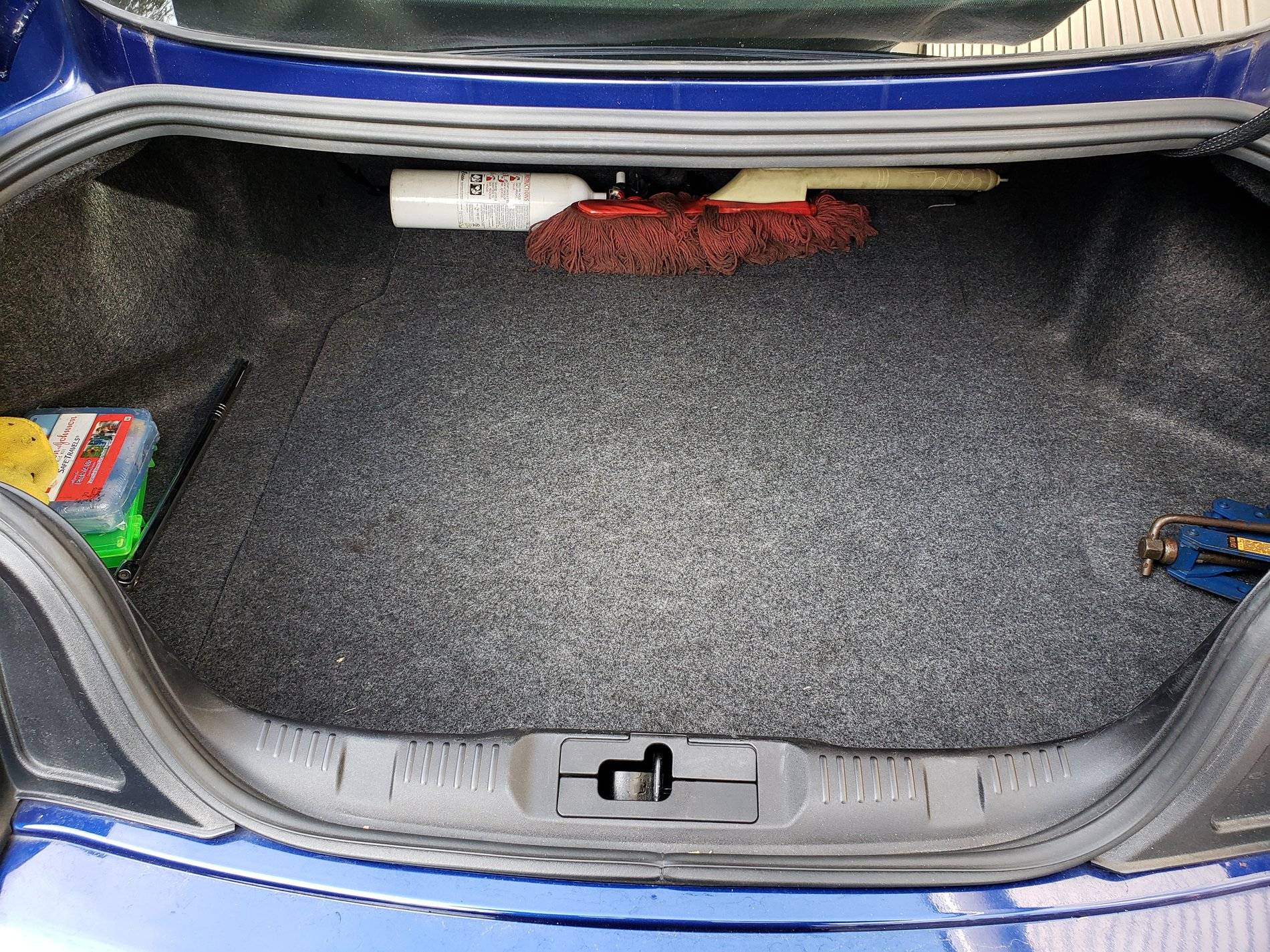

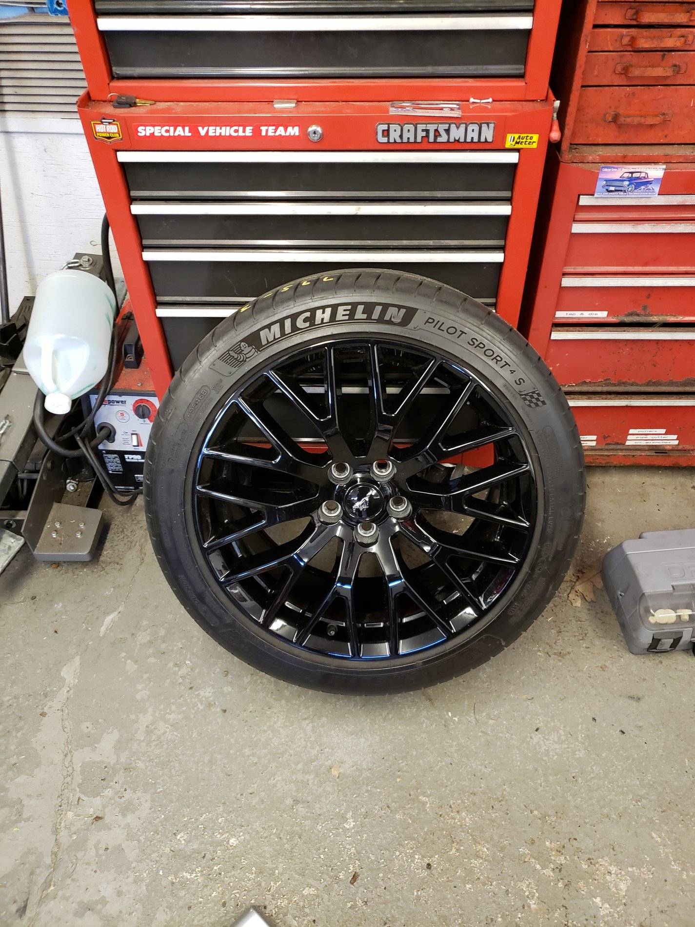

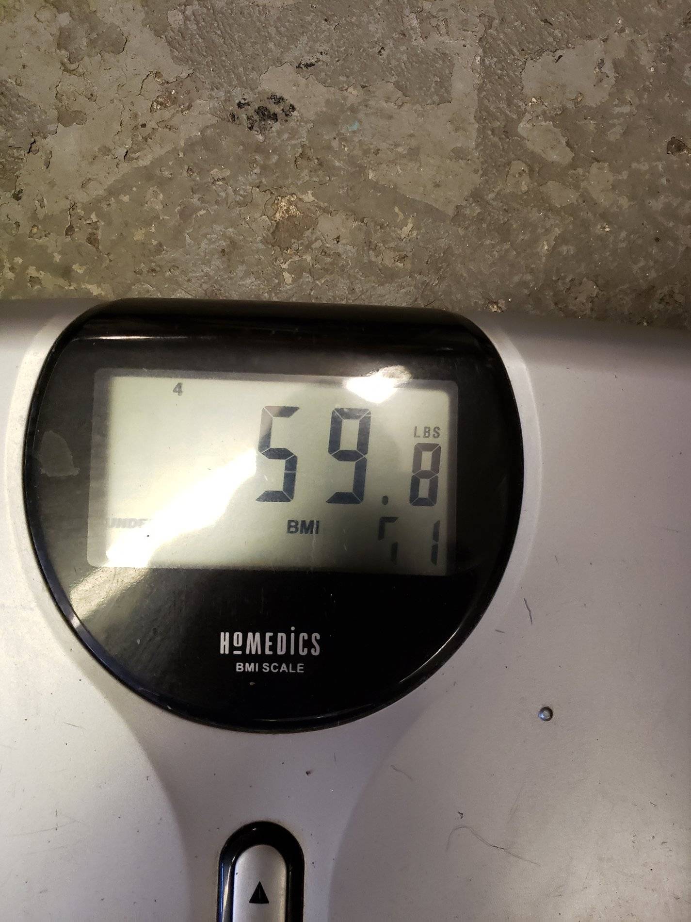

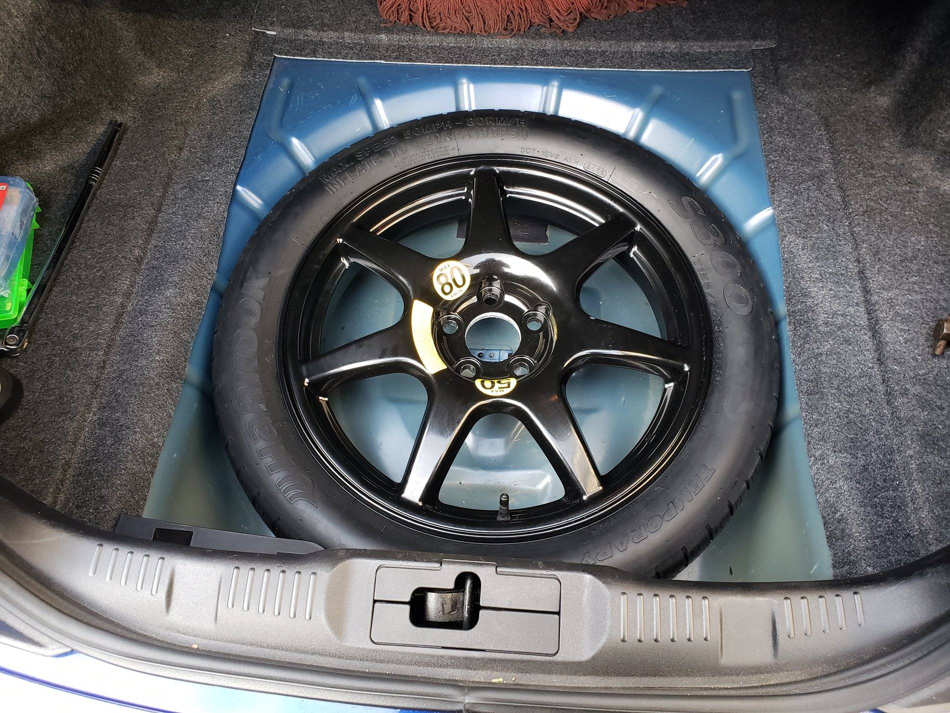

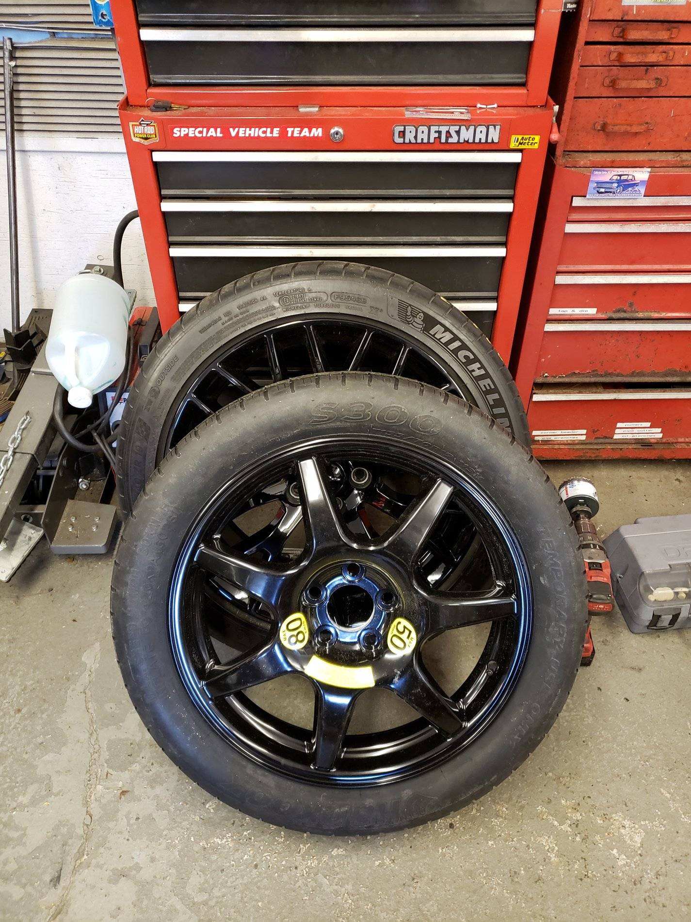

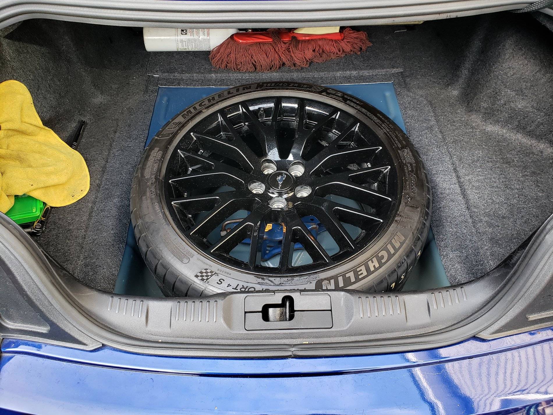

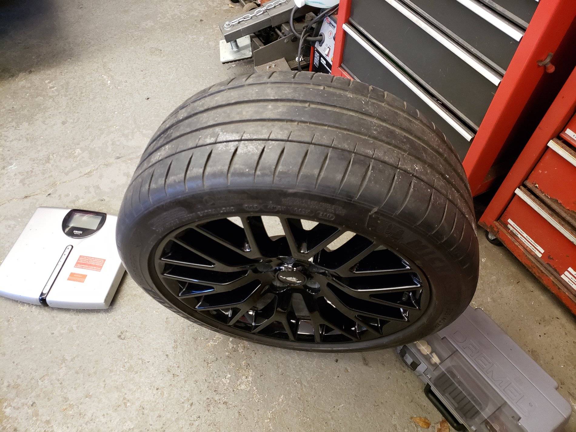

So I got an Equss rim off eBay. I just drilled out the hole in my garage and used a 2.75/70 mm hole saw. I also am posting pictures of the weight difference from a full spare to this mini spare and fitment in the trunk.
I could not wait for the Automotive Authority shipping backlog so found an Equus spare online.
After getting a quote from a local wheel refurb house for $180 to enlarge the center bore (and no bid from other machine shops) I decided to use the above method with two hole saw bits on one center guide.
The 2.5" guide bit in the middle was a little loose in the wheel center bore hole so I wrapped it with duct tape until it fit snugly in the center bore. I then lubed the outside of the tape with 3-1 oil so it would not bind in the bore. I took it slow and easy while drilling, used the 3-1 oil as cutting oil, etc. I then did a test fit and it was very snug on my hub. Very minimal filing for rough edges and a bit of emery cloth to smooth the bore and the fit was perfect.
