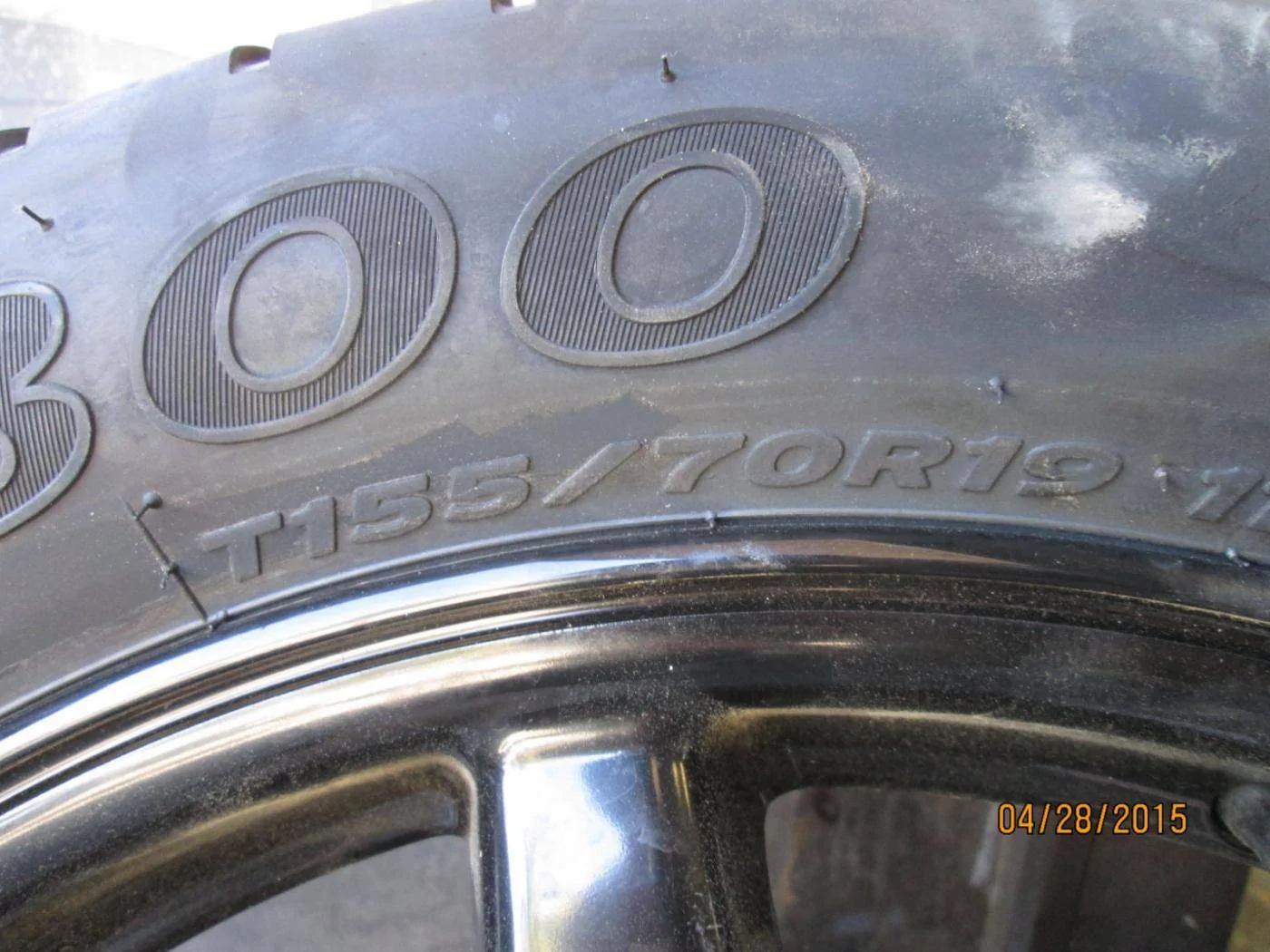

What is the tire size of that spare?

Thanks, 155/70R19 = 27.5" x 6.1" x 19" if anyone needs to know...
