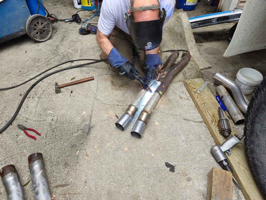

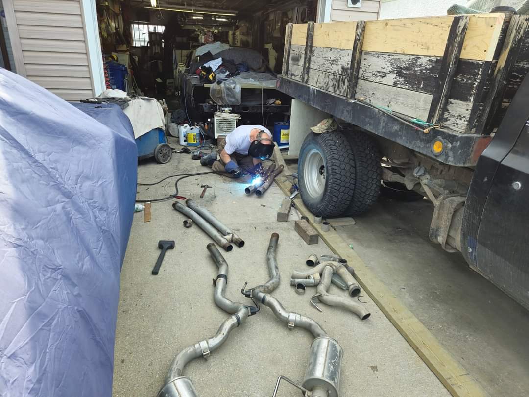

Its a butt connection but it seals perfectly. The neck down will not cause an issue on a N/A setup
We got rid of the neck downs on my X-Pipe.
More flow, the better.
