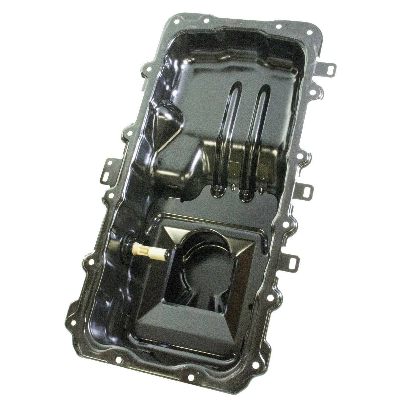

This make no sense. If the oil pickup in the sump loses oil supply due to hard cornering, where would this secondary pump system pickup the oil? The Coyote and Voodoo engines have deep sumps/pans, and with 10 quart capacity, so this is very unlikely with the stock baffles and windage tray, but you could fit a dry sump pan and oil tank reservoir or an accusump that keeps a pressurized reserve of oil in cases of starvation. I had one of these on my Saab as well, was a 3 quart capacity if I remember.
But IMO, this is unnecessary when looking at the stock pickup and pan. Even the GT350 R uses the same pan and pickup as the Coyote. The only way I can see the pickup going dry is if you were extremely low on oil and doing extreme cornering. This pic is from an 11 to 17 Coyote. You can see where the pickup sits, and the baffle/tray that surrounds and traps oil from sloshing out.

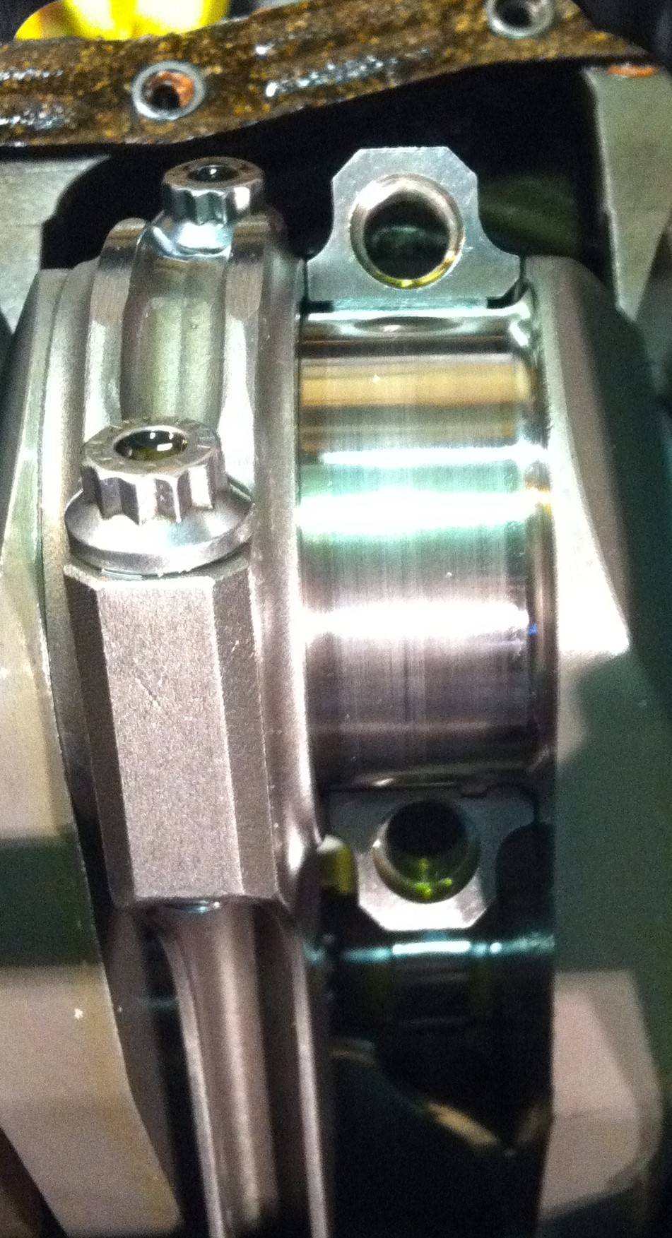

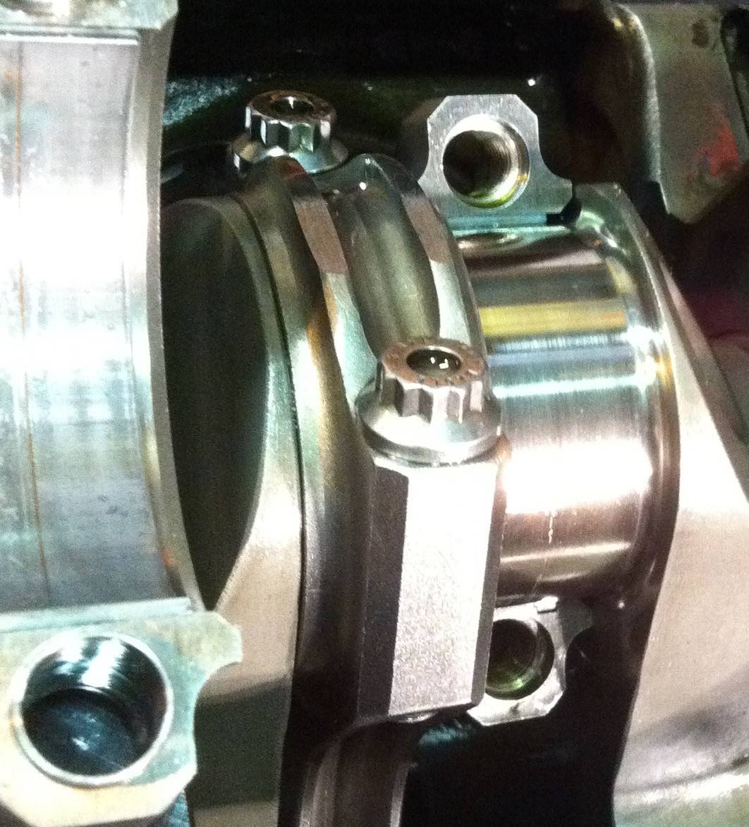

I've used an Accusump in my drag cars for decades and I'm not sure some people understand that as the oil drains back and the engine is cold the amount of oil on the bearings is so minimal that within one revolution the oil is gone. I've always used a 3qt Accusump and yes, during normal conditions the oil is stored pressurized, you have an electric solenoid that is wired to the ignition and a low oil pressure switch, so you have 3 qts of oil protection if you loose oil pressure and it drops below whatever pressure you choose. When you get in the car and turn on the ignition...not turning over the motor...the motor is pressurized to 30/40psi instantly, then you hit the button. Other than good machine work and and correct tolerlances, the most wear on the crank and rod bearings comes from startup, and if you didn't realize that, I forgive you from watching the internet too much and believing everything you read.
Here is a picture of one of my race engines and the condition of the rod bearings after 5 seasons of hard high 9.80's in the quarter...yes, if a 408w with a single carb and making 650hp@6800 and 544lbft@5700 and is in a 3200 Maverick. Oh yes, it had a 3qt Accusump on it since new!
Does this or would this work on a Coyote?, for the answer take a close look at the Mustang Cobra Jet drag cars.
This is incorrect. The pan you show is a BR3Z-6675-A for (I believe) 2011-2017 GT's and F150's.
The GT350 (all years) has a composite pan GR3Z-6675-E with an integrated pickup and windage tray. This part is unique to the GT350.
The 2018+ Mustang GT pan (JR3Z-6675-E) is similar, but not identical to, the GT350 pan. It also has an integrated pickup and windage tray, but less capacity than the GT350 pan.
The 2020+ GT500 has yet another pan, made from aluminum instead of composite. It is available in a kit as Ford Performance part number M-6675-M52S.
