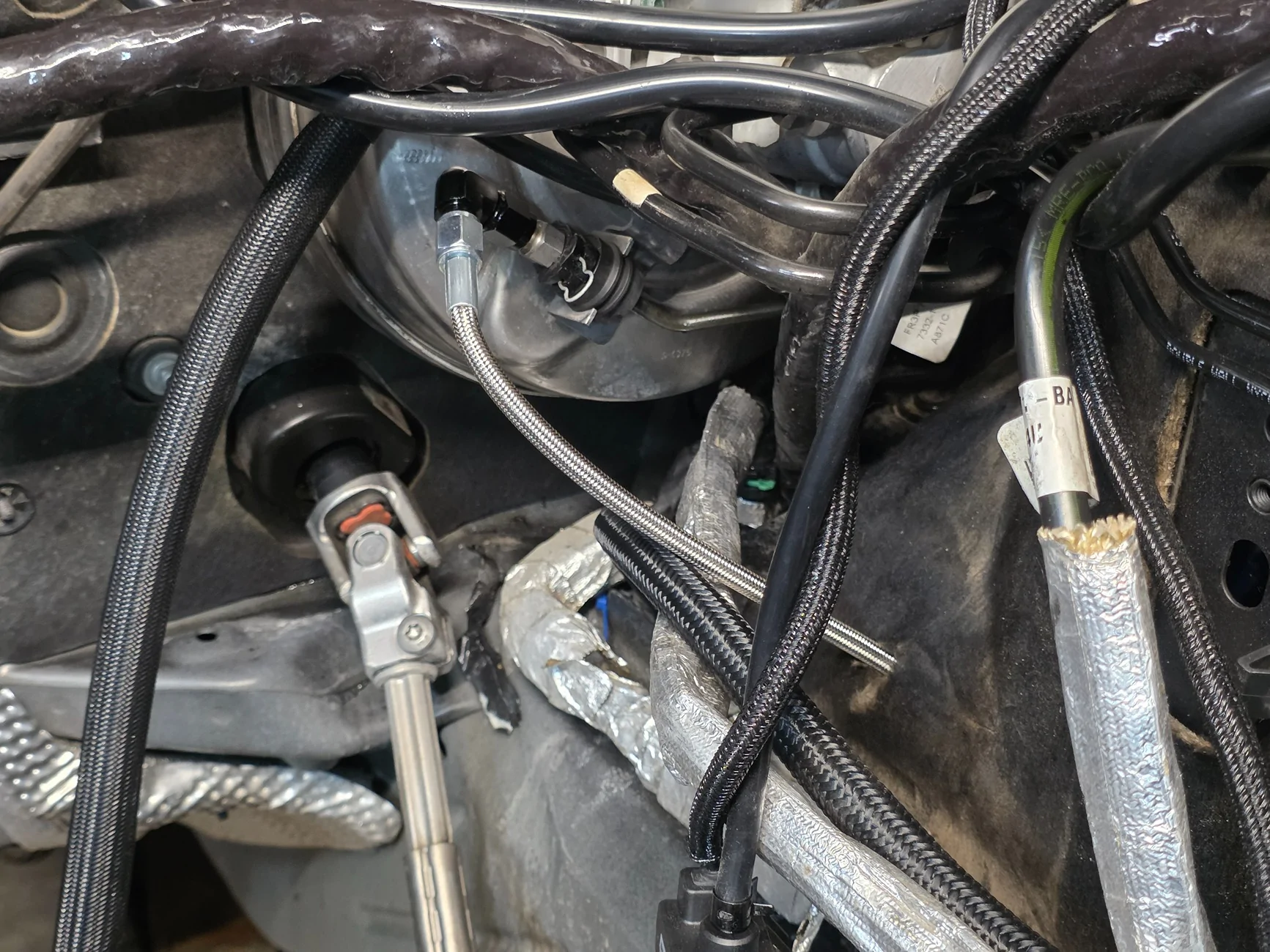

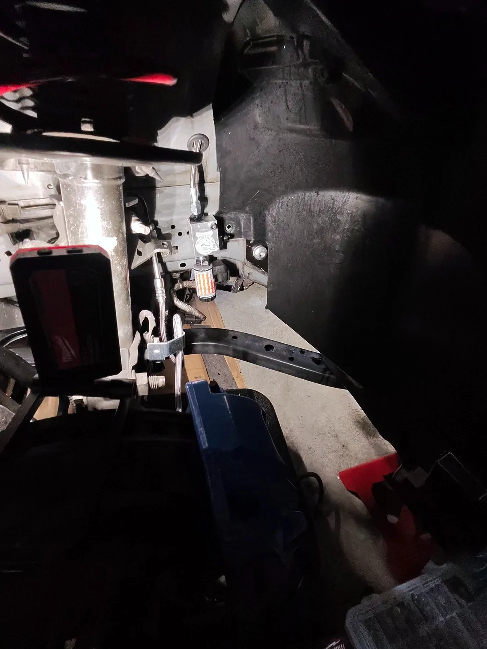

Man, that is some tough luck. I got it mounted for the most part. Plan on getting it wired up this weekend but I'm still waiting on my shortblock to give it a try. Ended up ordering a 12" steel braided brake line with -4 an females ends, a -4 male 90 to -4 female fittin, then drilling a hole through the wheel well and mounting it in the driver's side wheel well.

Great pics, thanks for sharing. I'm very curious how you like it once you get going. Definitely will look back at this to take notes from you.
