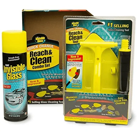

Been using Invisible Glass for a while now. Soak the towel and follow it up with an old 100% cotton t-shirt. Works pretty good but I need that kit ^ for the back window and for the sake of my own back.

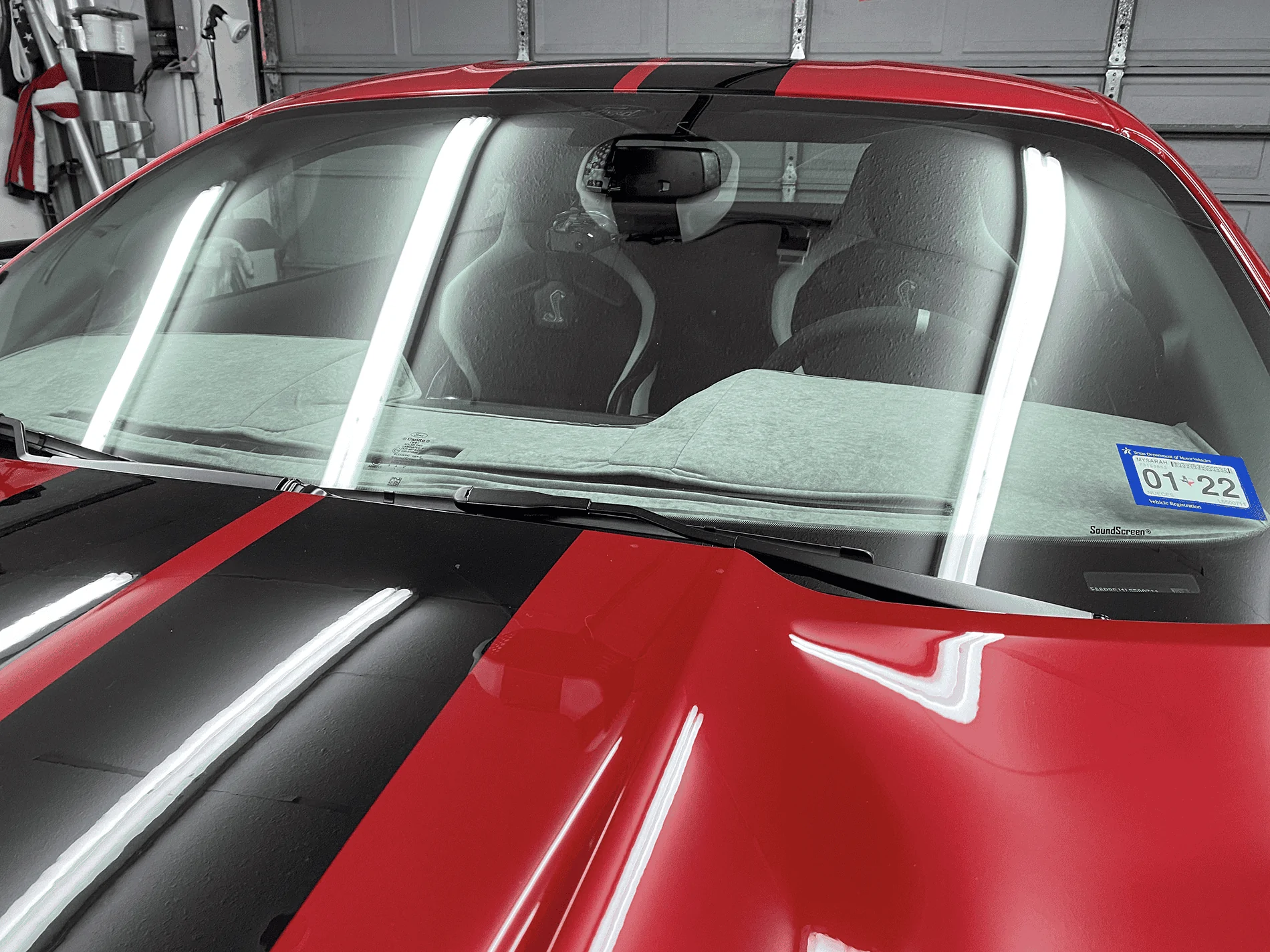

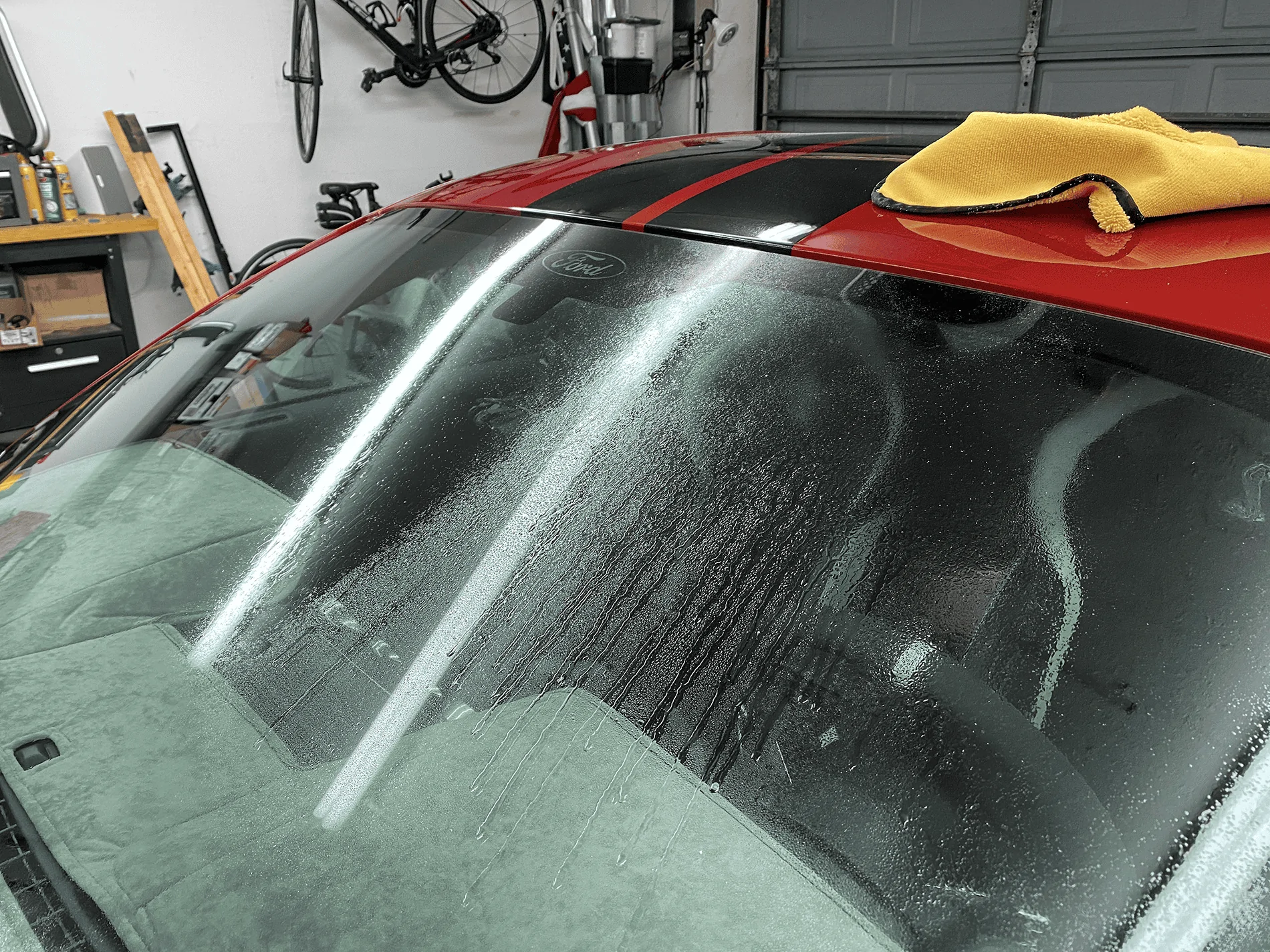

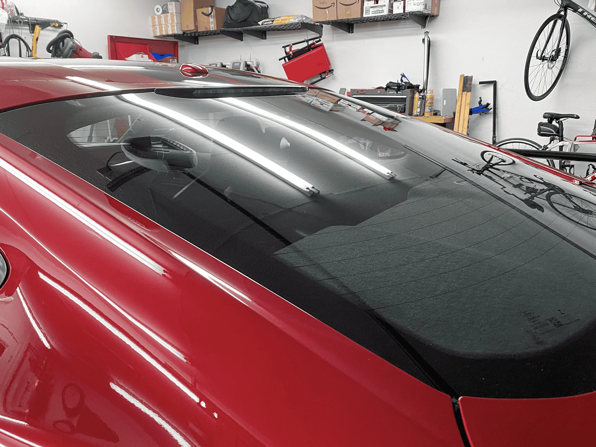

Kristian: I'm not sure anything short of a compound and a polisher will get it all and I'm also sure that's especially true if you put a fair number of miles/month on the vehicle. My car was right at a year old in these images with less than 2k on her.
In the first image, you can see the line of contamination after spraying the windshield with IPA. The passenger side had been polished but the driver's side had not.
The last two are after polishing and applying Wolf's. I used a 2" machine for the edges of the glass and a 5" for the larger interior sections.
