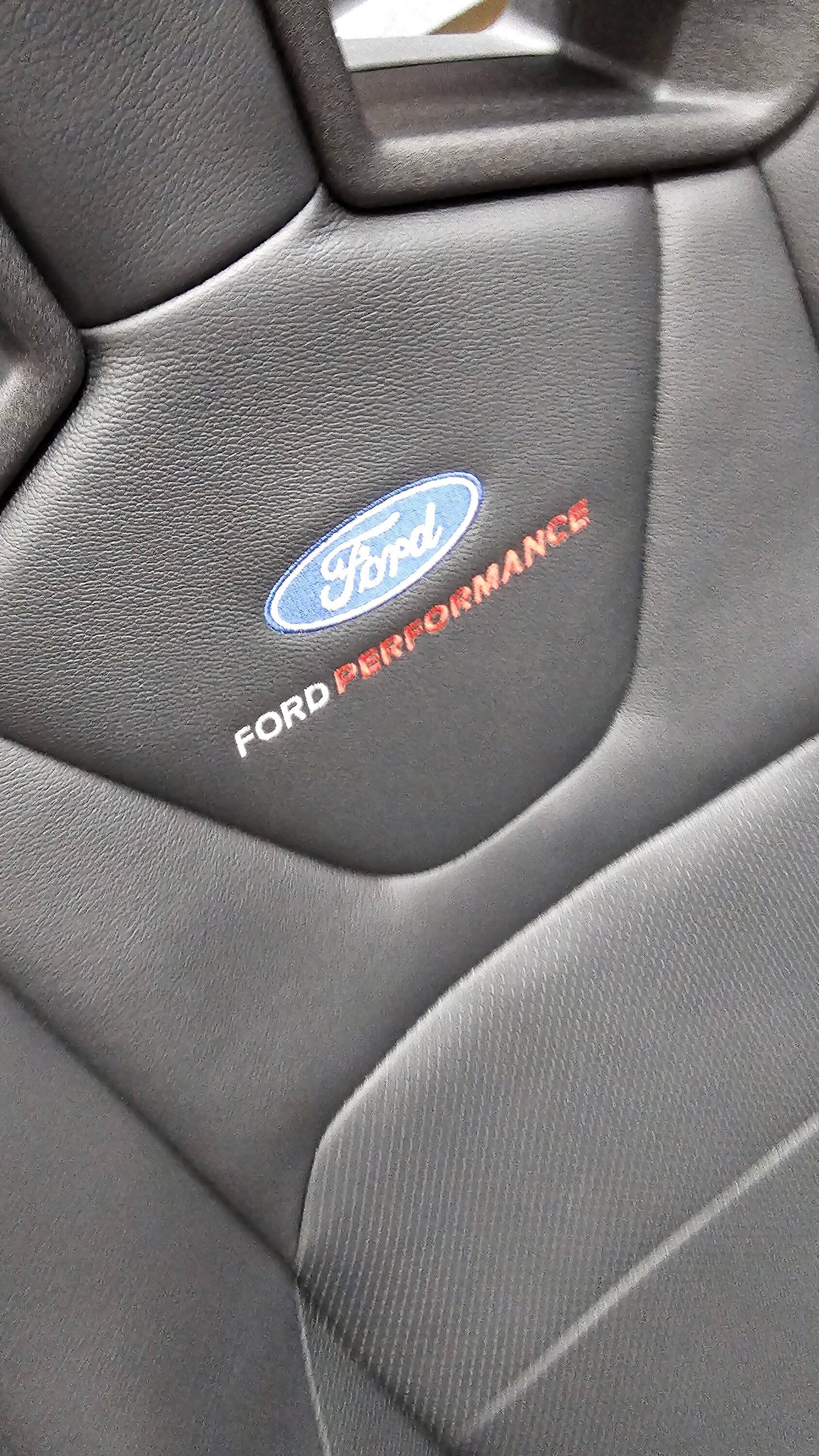

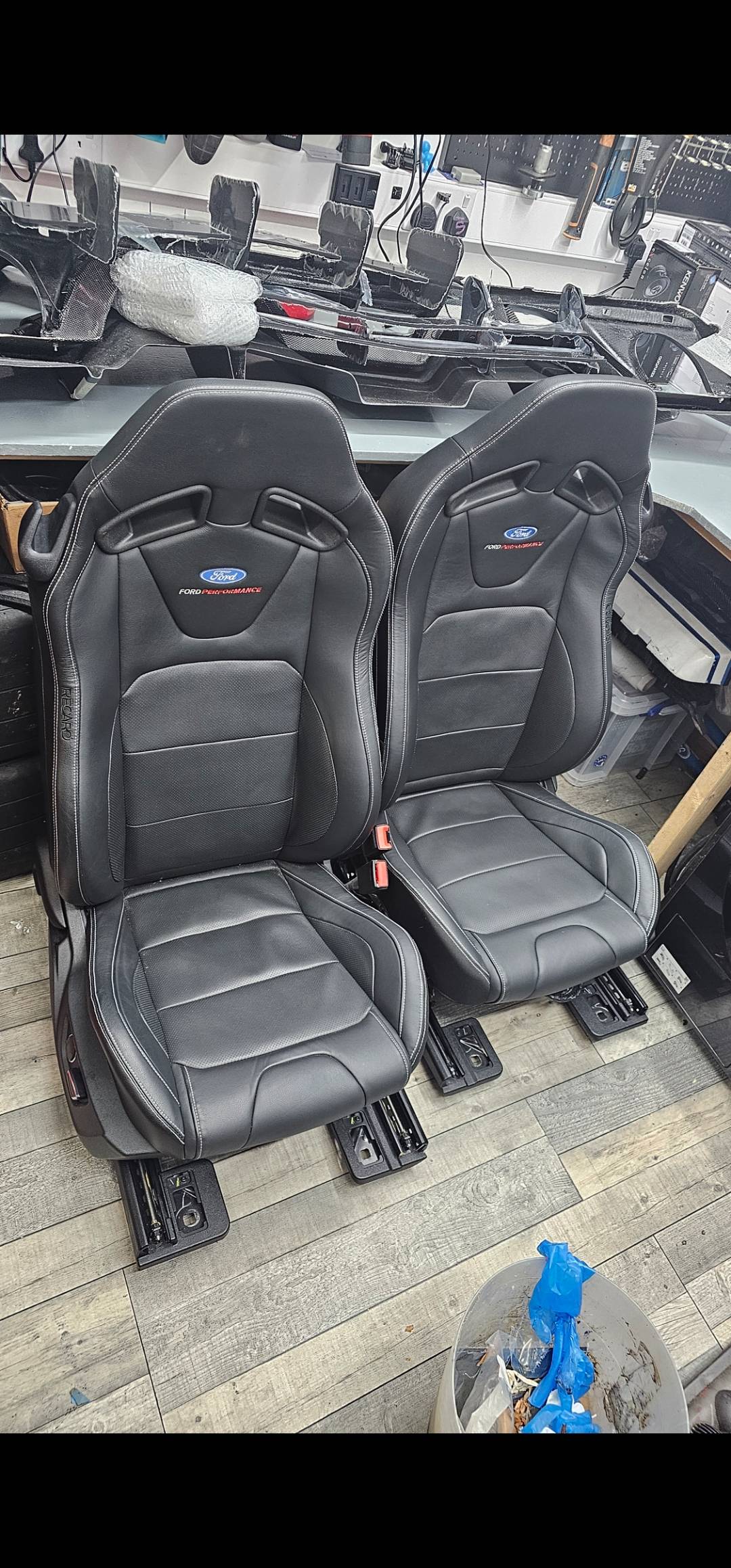

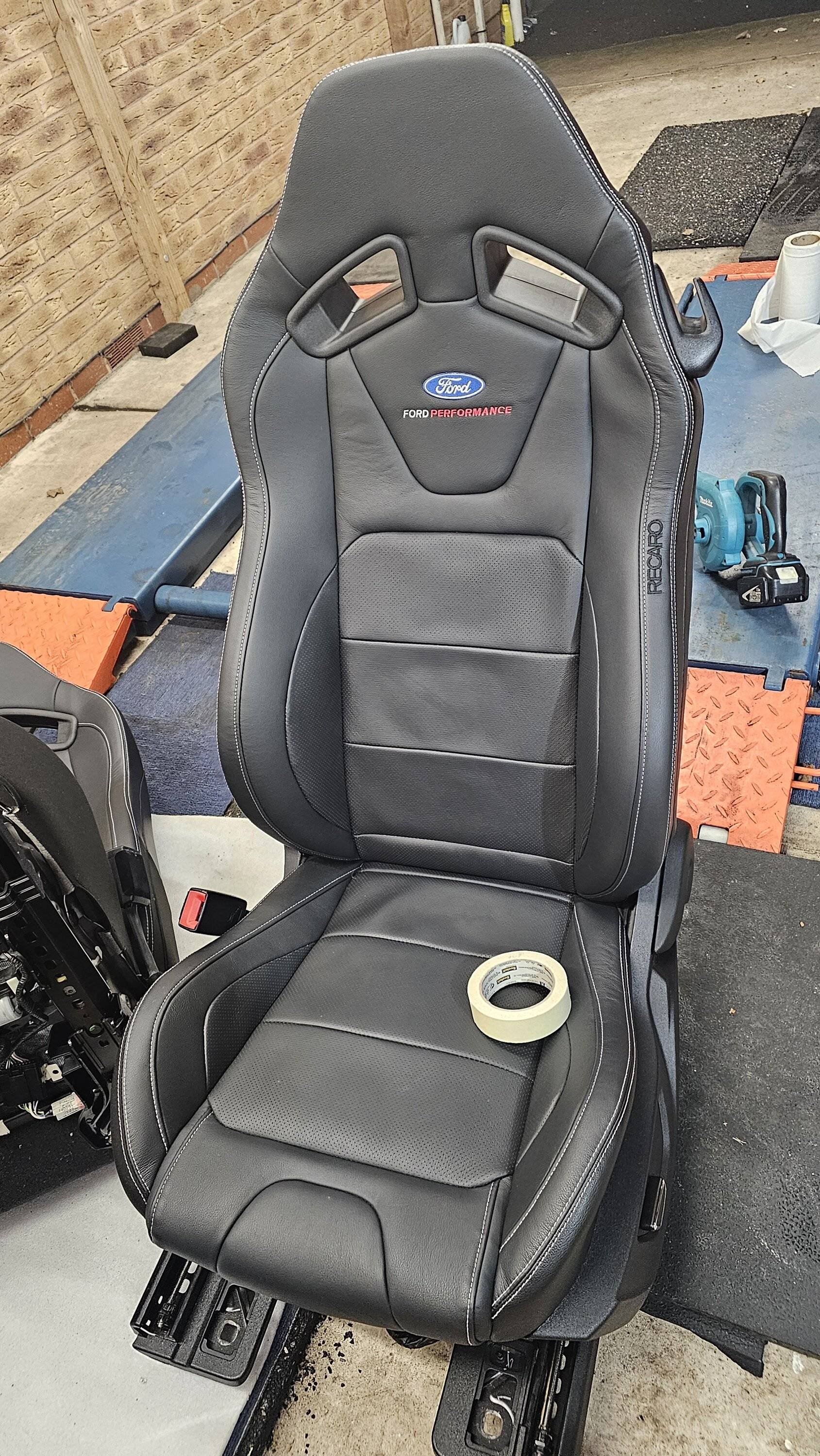

I acquired a set of Ford Performance Recaro seats (not to be confused with the standard Mustang GT Recaro seats) and I am contemplating running a 4 or 5 point harness.
I got very lucky with these as I have been on the lookout for a while. These also have heating and cooling function!

You’ll not be able to run 5 points properly on those, no hole in the base for the jewels belt!
Great seats though

These are available to buy as an upgrade from Ford under the ford performance arm but they are stupid expensive. The challenge I had was that the 15-17 had been discontinued and u really wanted to keep my heating and cooling function.
I have only ever seen one set and I was in touch with the owner of the car and we worked out a deal as they were selling their car and I had purchased their original standard seats to modify and part out so I could upgrade some Sparco R333 seats. Things lined up well and I got em.

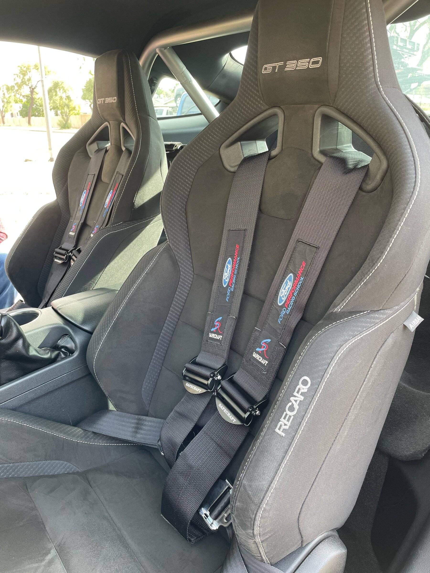

There is no workaround for the standard seats. You can't just add the submarine belt, even if you add an anchor point for it. It won't function as needed.
I bought Schroth Quickfit 4pt harness from a 6g member and bought a new SHR Flex Hans restraint.
My reasoning is that I wanted Hans for any hard frontal impact (and with airbag deployment). I don't want a bar inside my daily driver and I realize that a rollover is a risk without it (and perhaps worse with the 4pt).

I looked into all this years ago for a track car. Basically I found out that it’s generally safer to have the original set up than a part race setup. IE it’s all or nothing.
Four point harnesses are not safe. A standard three point is safer.
The lack of anti submarine strap means you will slide under the belts in an impact. A three point with tensioners will be far better then this. Also any racing harness has to be tight to work. If it’s tight you will struggle on the road to check blind spots and adjust controls. Plus insurance may have an issue/increase prices.
Five or six point are very safe. But still impractical on the road and due to keeping you rigid will cause more neck injury then a standard three point. So you then need Hans. Problem is if the roof comes down again you have increased the risk over a three point. So you need a cage/bar. But without a helmet that increases head injury risks so need a helmet…. Which is all far too OTT for a daily and would make Road driving a right pain/more dangerous.
Yes you CAN do any of the above and loads or Road cars have four points added because they look cool. But none of it is safe from what I read.
I’m sure opinions will vary. But it put me off.
