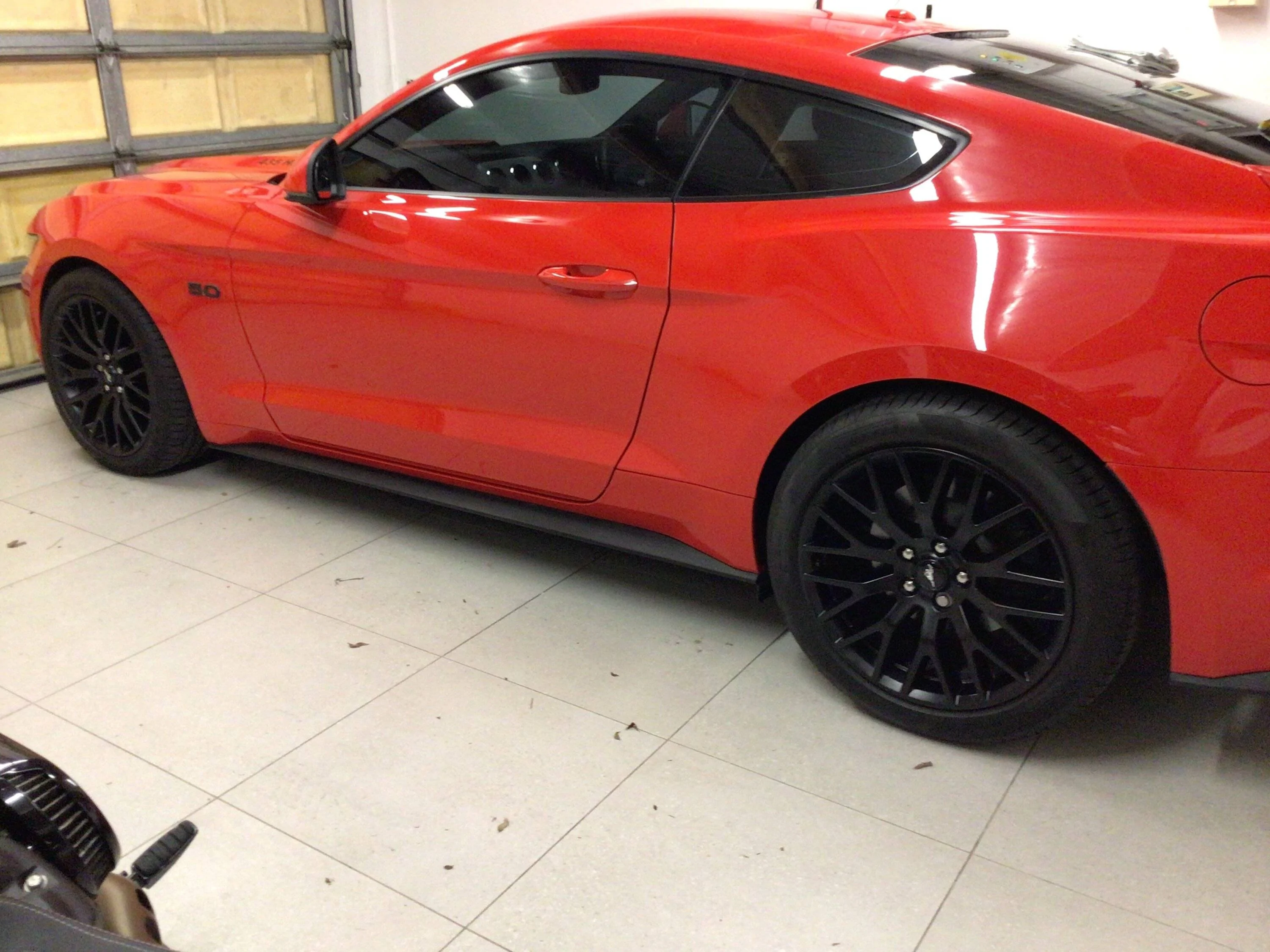

Captain Greg
Feb 18, 2023
75
77
Cape Town
Greg
Aston Martin N430 .Mustang GT .Mercedes Benz AMG,
What are you trying to accomplish by having spacers?
And which wheels and tires do you have?

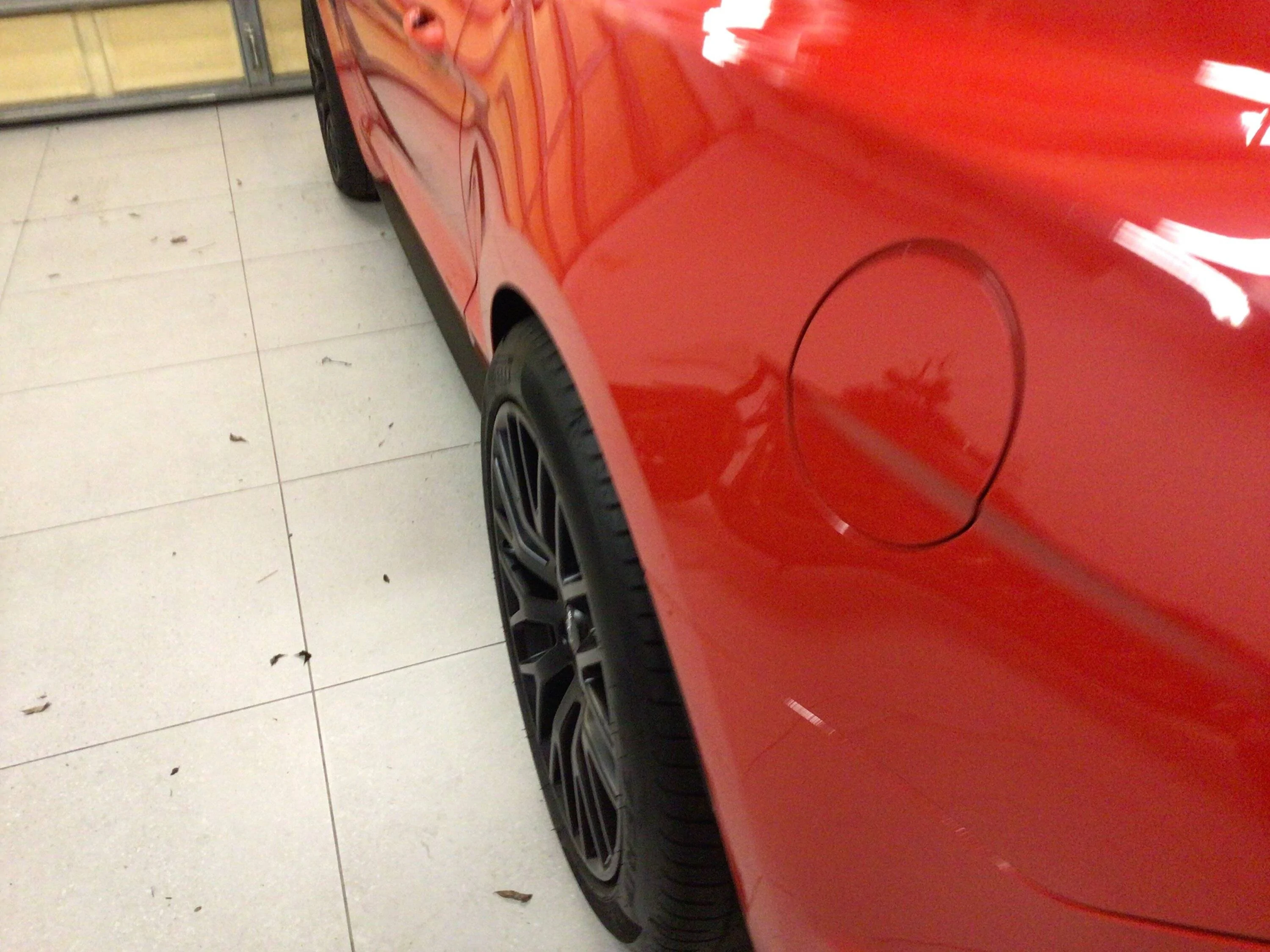

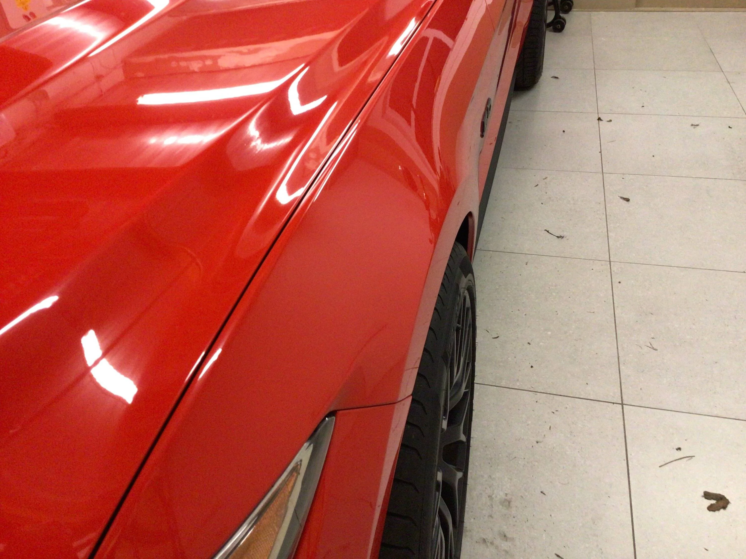

I wanted a more masculine stance I did not want to make a huge investment in rims and wider rubber ..also did not want a lowered car that adds frustration with basic speed hump’s and other road hazards …I added 33mm rear 24mm front …bolt in then wheel bolts to spacer aircraft aluminium ….so no risk of it breaking
it brings the tyre out making the car fender look like it’s been lowered ….parked next to a stock 5.0 it looks like the dogs bollocks IMO

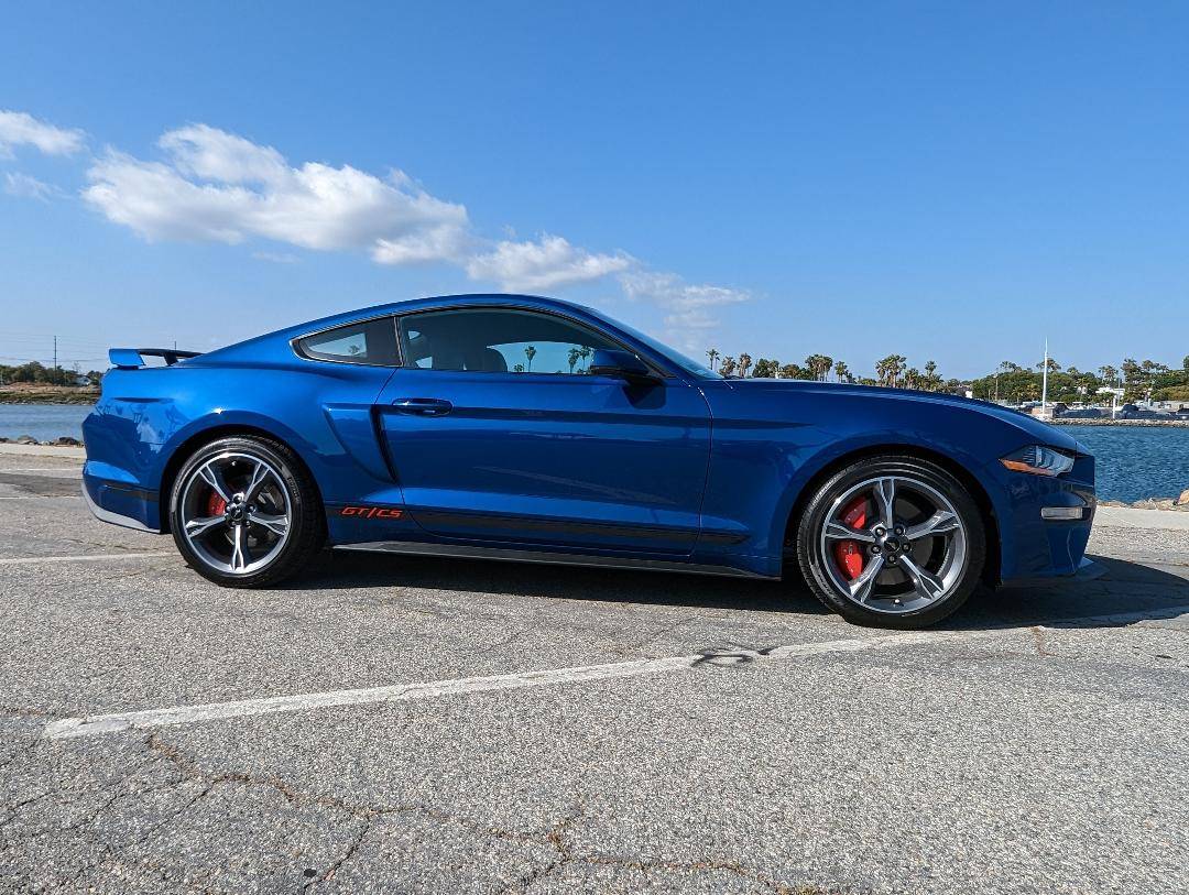

Tommy
May 1, 2023
Seal Beach, CA
Tommy
2022 Mustang GT/CS Atlas Blue

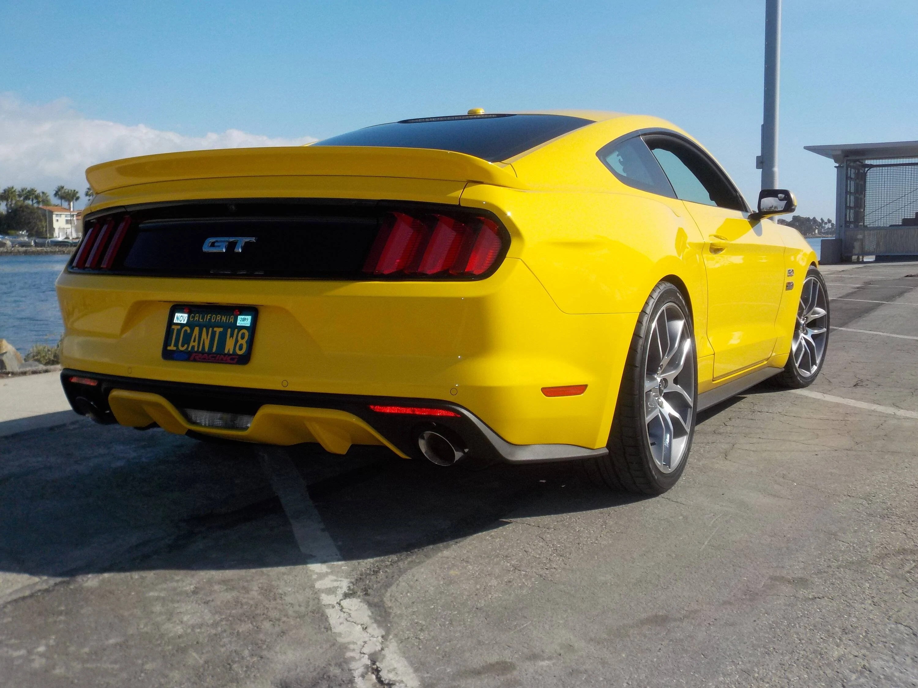

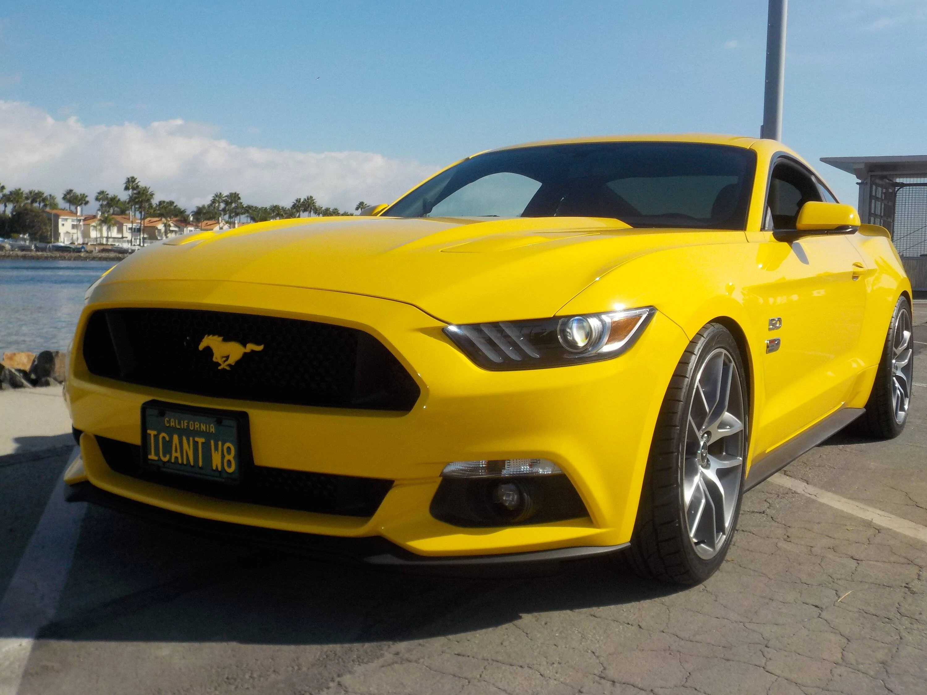

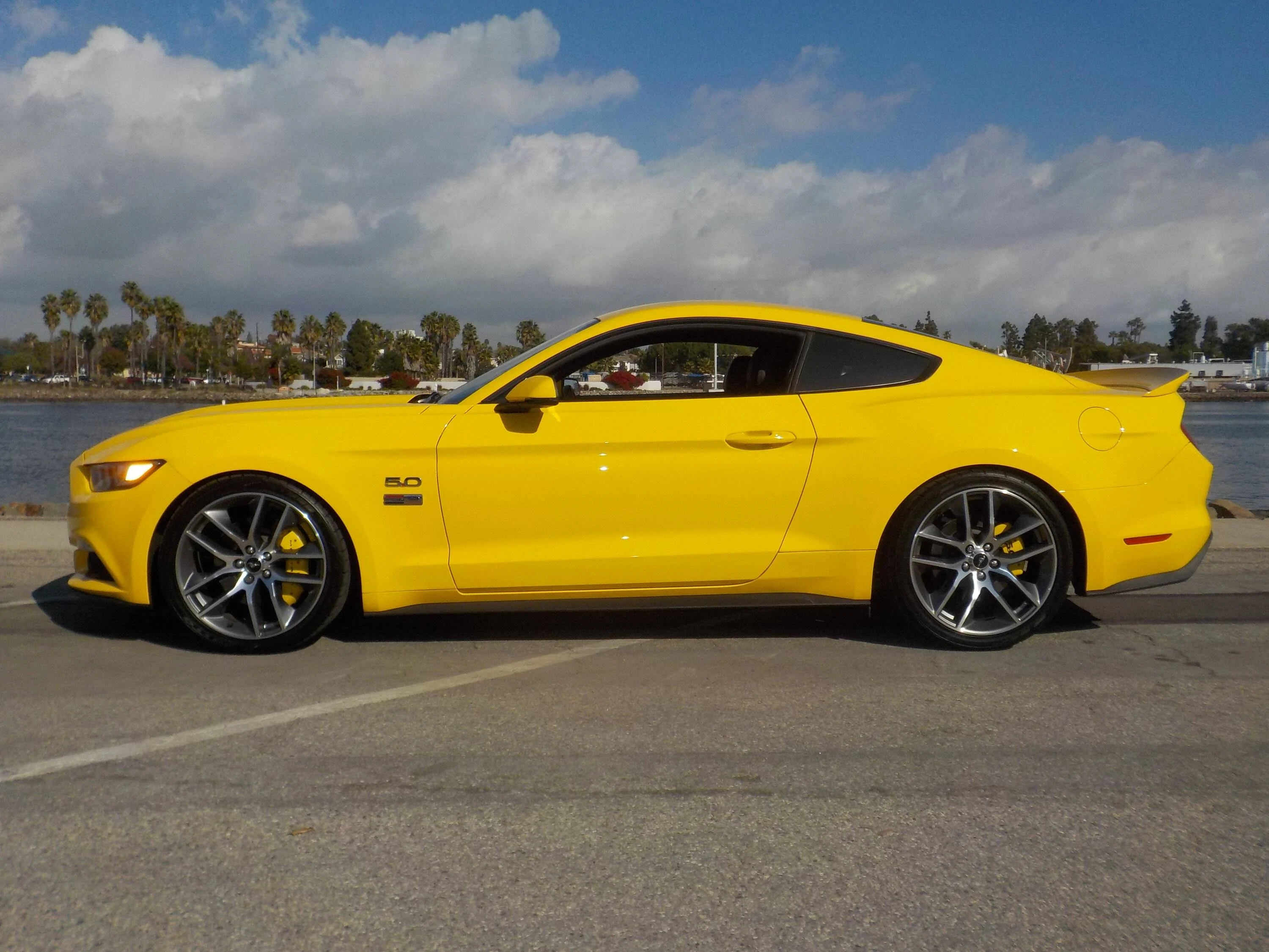

The yellow 2016 GT Premium is lowered using Eibach springs and factory 20" wheels and 20mm Steeda spacers. The 2022 blue GT/CS has factory 19" wheels and the same 20mm spacers but not lowered (yet). Though the difference in 20mm and 25mm spacers is less than 1/8" the 20mm spacers allow the tire to be "just' inside the fender with no rubbing issues stock or lowered. In person the blue car looks lowered because of the spacers though no where near the aggressive stance of the lowered yellow one. Handling is different story with the lowered car....
