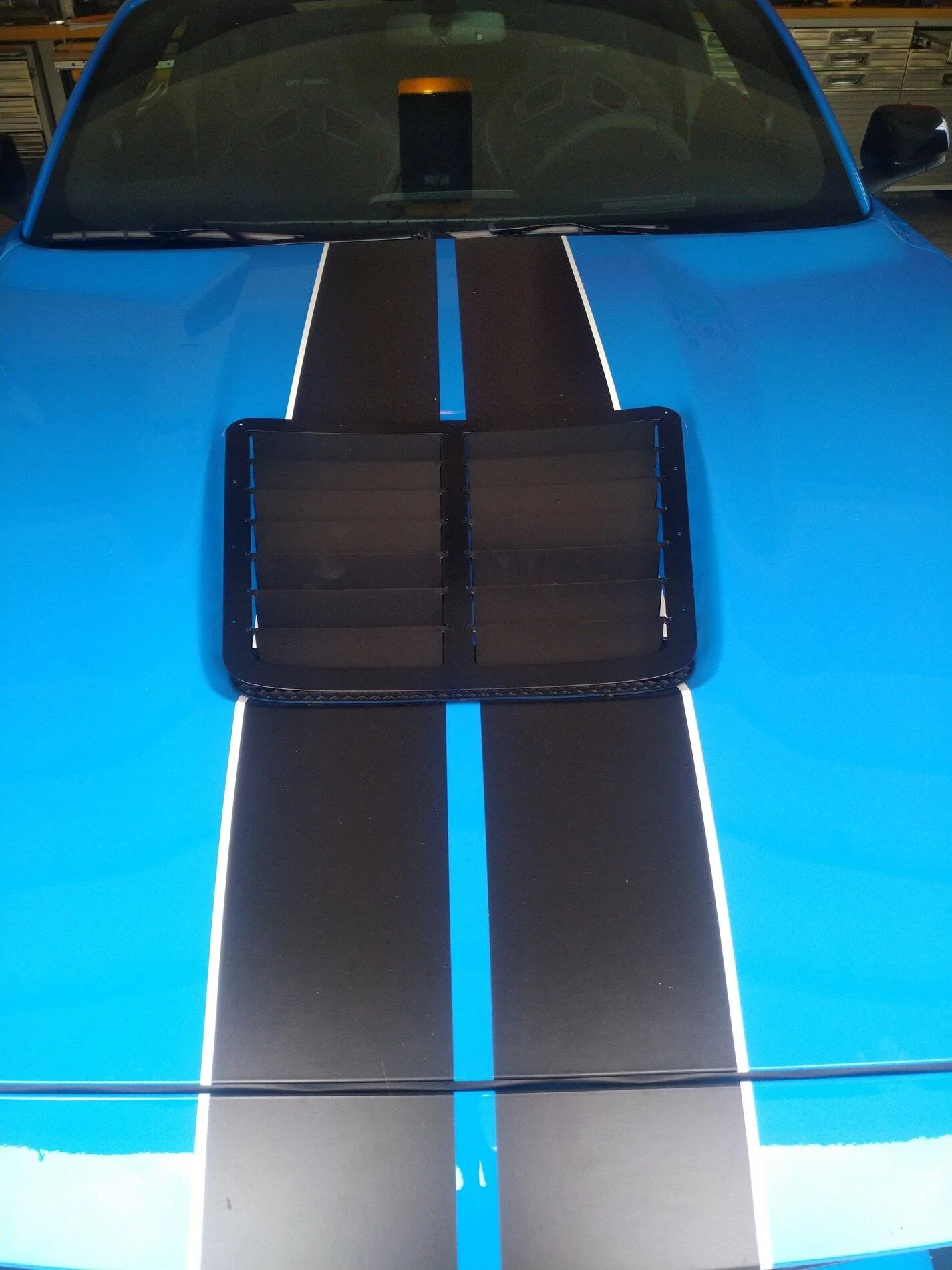

Hey @CarbonZ , may want to look thru the following link to start. There are a few players here who have installed vents on their hoods. flyhalf and Ewheels are a few you can look up who are very helpful. Have you looked into a spare hood. Was really hesitant to cut my original hood for many reason. I installed several vents on my prior GT, see below. Was about to purchase a spare hood for the GT350 but the junk yard just happen to sell it before I got there.

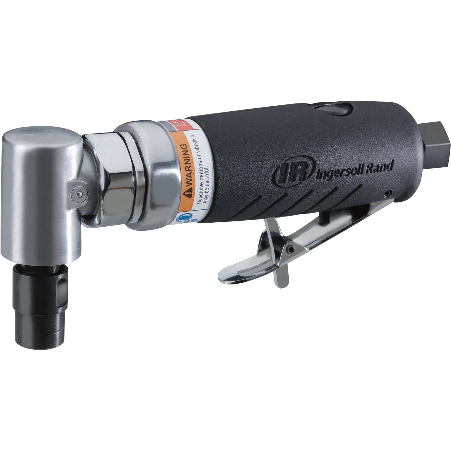

I used a hi speed pneumatic grinder, 90 degree die grinder. Used a metal cutting wheel. I most definitely recommend get some one inch wide steel or aluminum stripes from Home Depot to use as a border. You can tape them down and they’ll keep you honest. You’ll also want to pickup some black matte paint to cover the edges you cut. I know you can’t use anything pneumatic, but that’s what I used. Are you going to take the hood off to install? If not get a big blanket as well to cover the engine bay.
