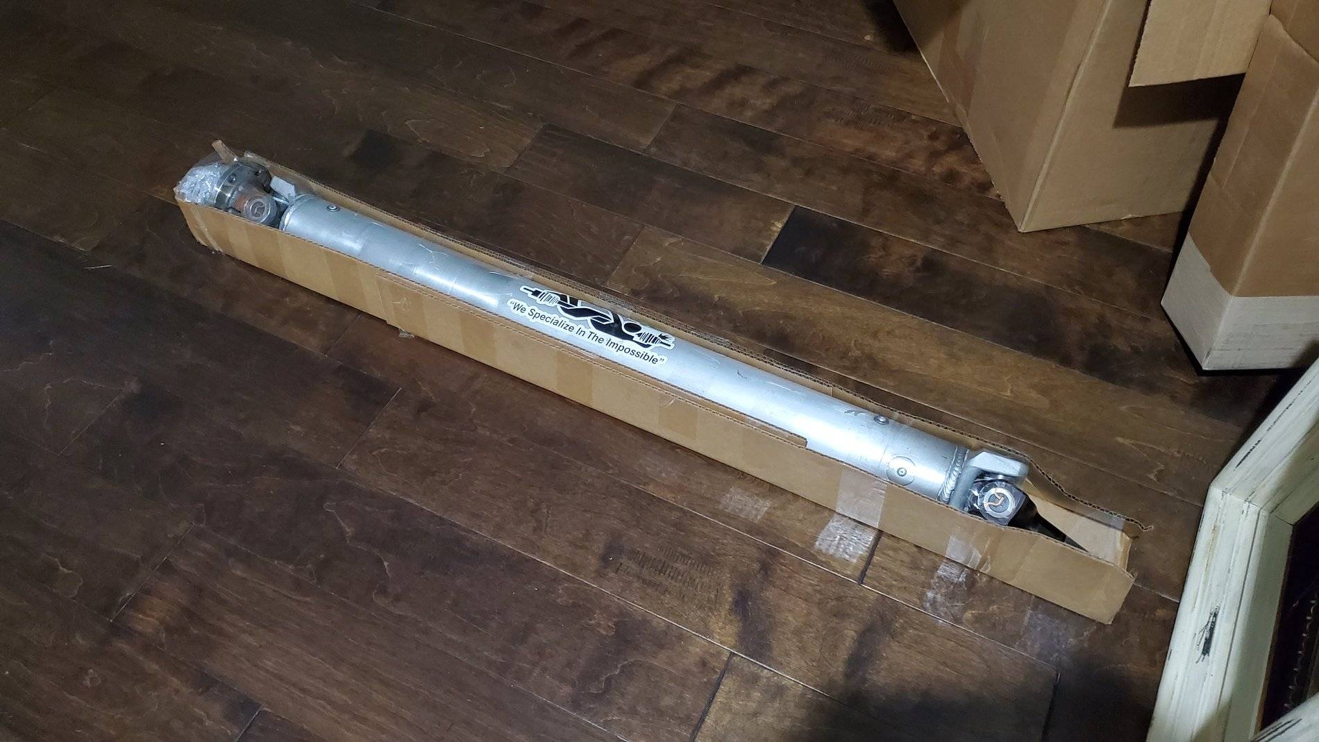

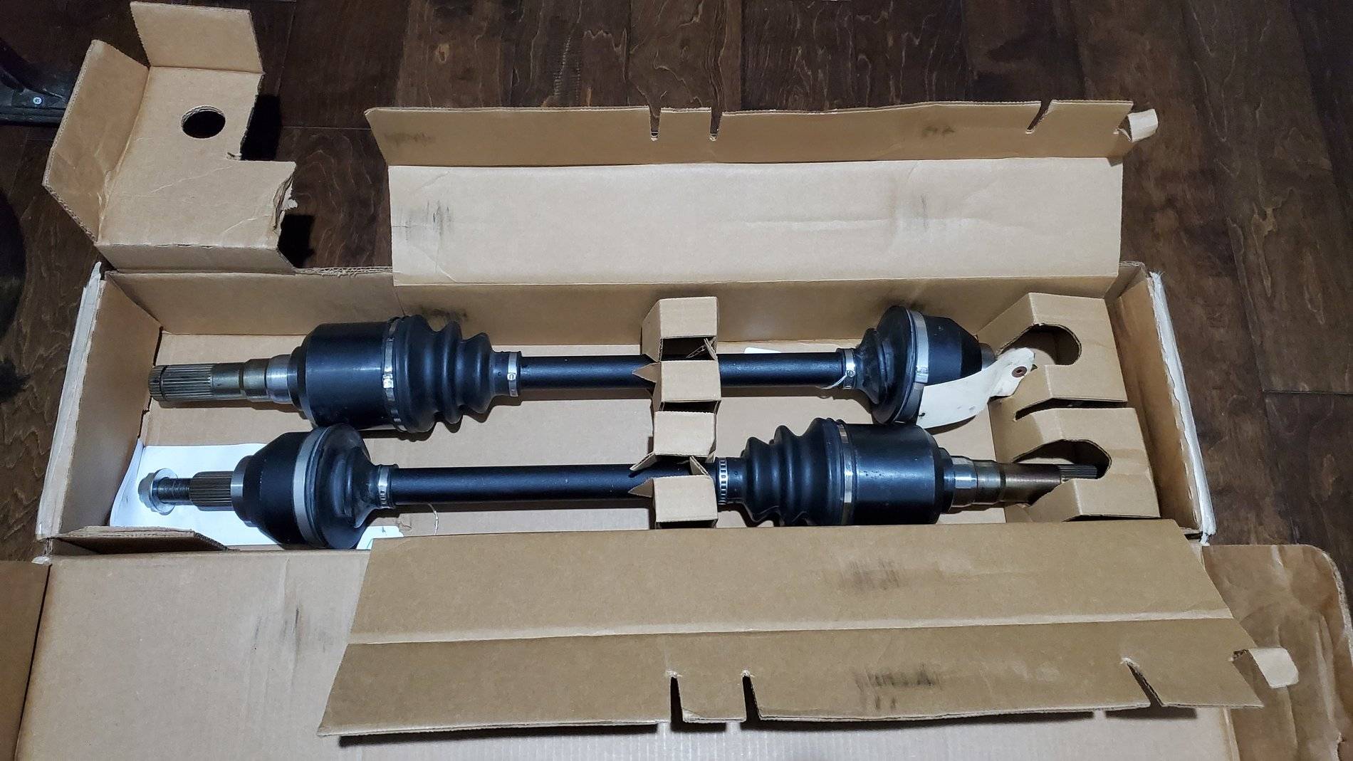

Update:
My axles and driveshaft are on their way back to me. No major damage reported by DSS. Axles were freshened up. Driveshaft was checked, scratch polished up and balance checked good. Should get them this week. $300 total.

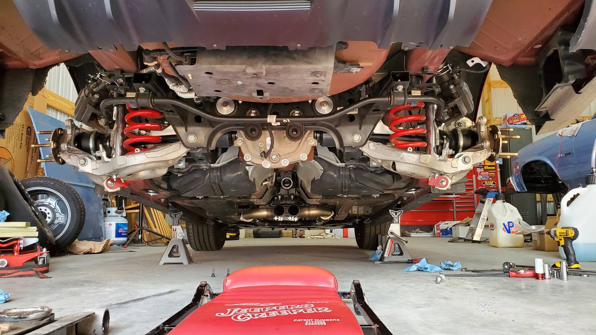

wrap your exhaust before you forget. :)

Outstanding job! Will you need to get an alignment since the subframe was out of the car?
