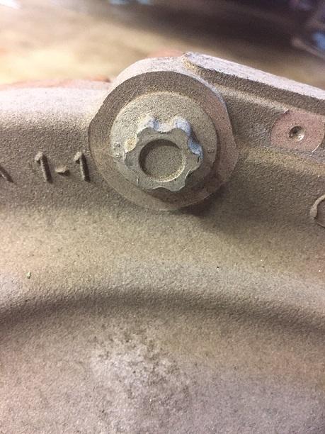

Does anyone know what socket I'm suppose to use to remove the bolts in the rear differential cover? is it a External torx socket? View attachment 364747

I found the correct socket for them. It's a E-Torx socket. I had to buy a set from Home Depot. The socket size is a E-18.

If it is an 18+ it'll be a torx plus which is slightly different. Found that out when I did my rear diff cooler...torx plus is more squared off versus rounded.
