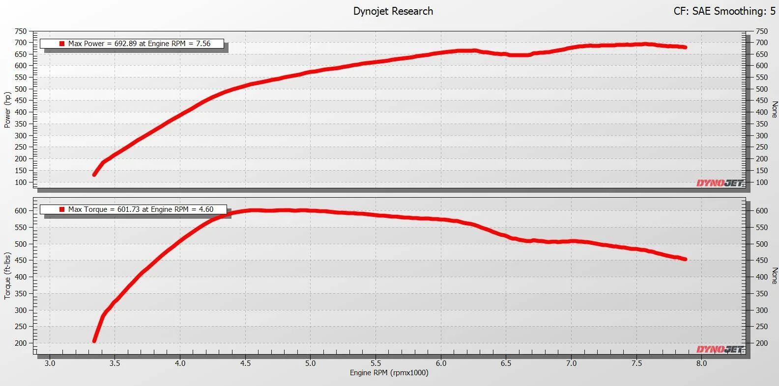

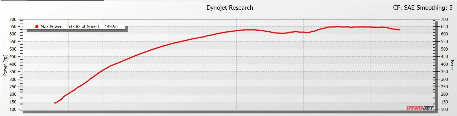

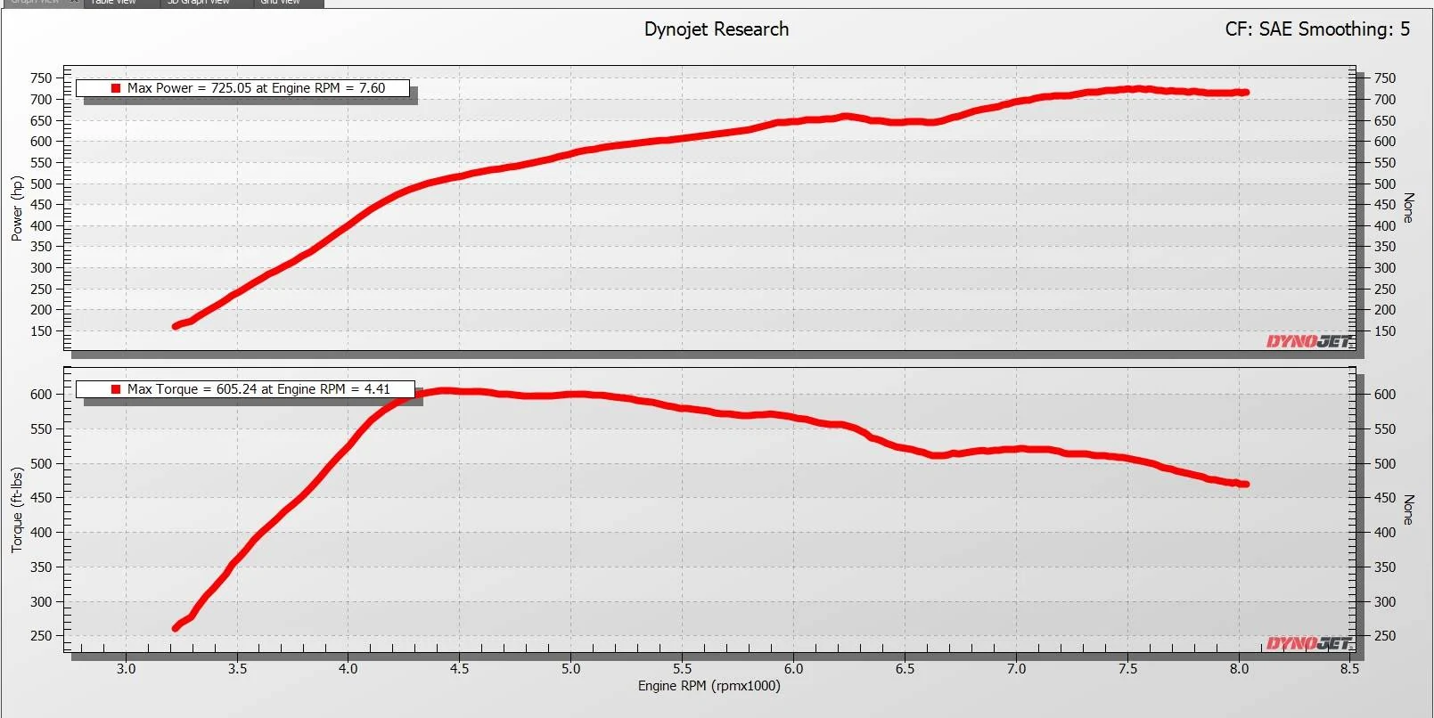

I just got my car back from the shop. I am itching to drive it, but we got another dump of snow, which delayed my first drive.
-Hellion sleeper w/ 62mm ball-bearing turbos
-Hellion 4-1 Headers
-eBoost2
-Lund tuned
-Calimer Stage 3 TR3160
-MGW X-Spec shifter
-Mantic twin-disc clutch
-ID1300XDS injectors
This is only a street car. Pump 93 for now - E85, maybe this summer. Alex at Lund got me taken care of with no hiccups other than needing to replace my front O2s. I am keeping it just below 10psi until I get better fuel onboard.
6.5psi - 647whp
8.7psi - 692whp, 601 wtq
9.5psi - 725whp, 605wtq

Thanks for sharing the details.
Serious question - what’s the deal with the dip around 6500?
I know on some platforms, that’s just a characteristic of the engine. Still learning coyotes s550 engines.

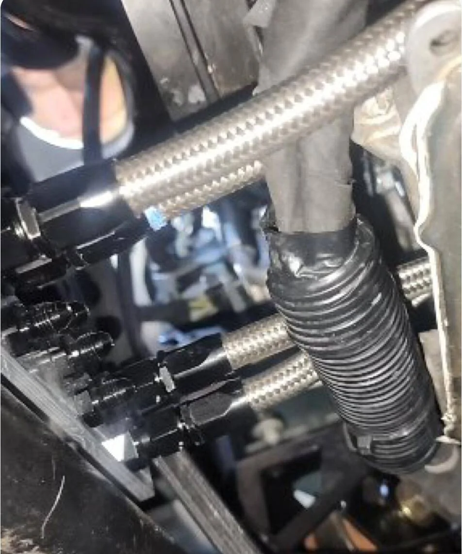

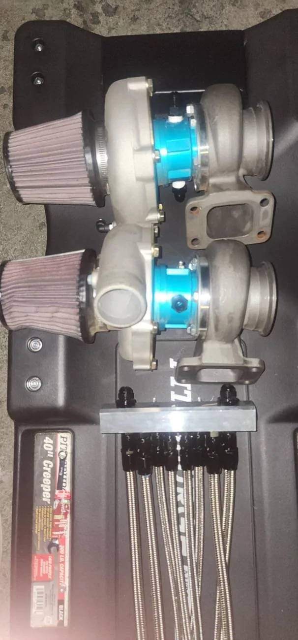

@Boosted350 that' sounds like a very nice setup that you have. Who did the install on it? Did you utilize the water cooling option for the wastegates? My buddy is working on his TT Bullitt right now and he’s setting his up for water cooling using a FatHouse Fab coolant distribution block to cool the turbos and wastegates.
HPJ Performance did the install. I haven't gotten my head in the car yet to answer your question.
I know on some platforms, that’s just a characteristic of the engine. Still learning coyotes.
Not sure, log looks great. When I get my first actual rip in the car I will see if I feel anything, but I doubt it.
lt would be interesting to look at the data log. It'll depend on if they were going for the smoothest power curve or finding where the fuel table is happiest. My guess is they focused on the fuel table and something is causing a small dip - could be you need to add/pull cam timing right there to smooth it out (assuming the fuel table is optimized, they're in the timing window, and there's no weird issue like a bad signal or something that's causing the ECU to compensate for a false positive).
