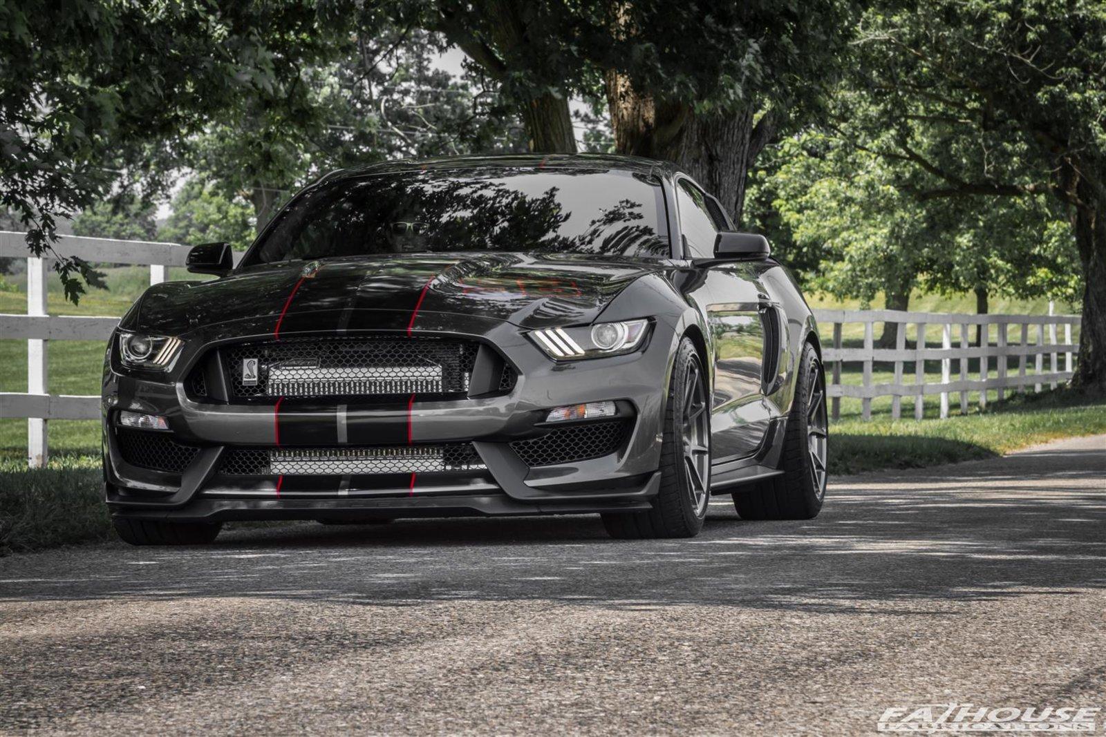

Feel free to call me about Fathouse. I don't work for them, they don't do my work for free either. I just happen to be the first guy to provide them the canvas to do their art! Ill answer all your questions honestly. 317 414-9355
I may need to take you up on that ! The FatHouse system is pure sex. Its just do I want to plop down that much for the sex !!!
