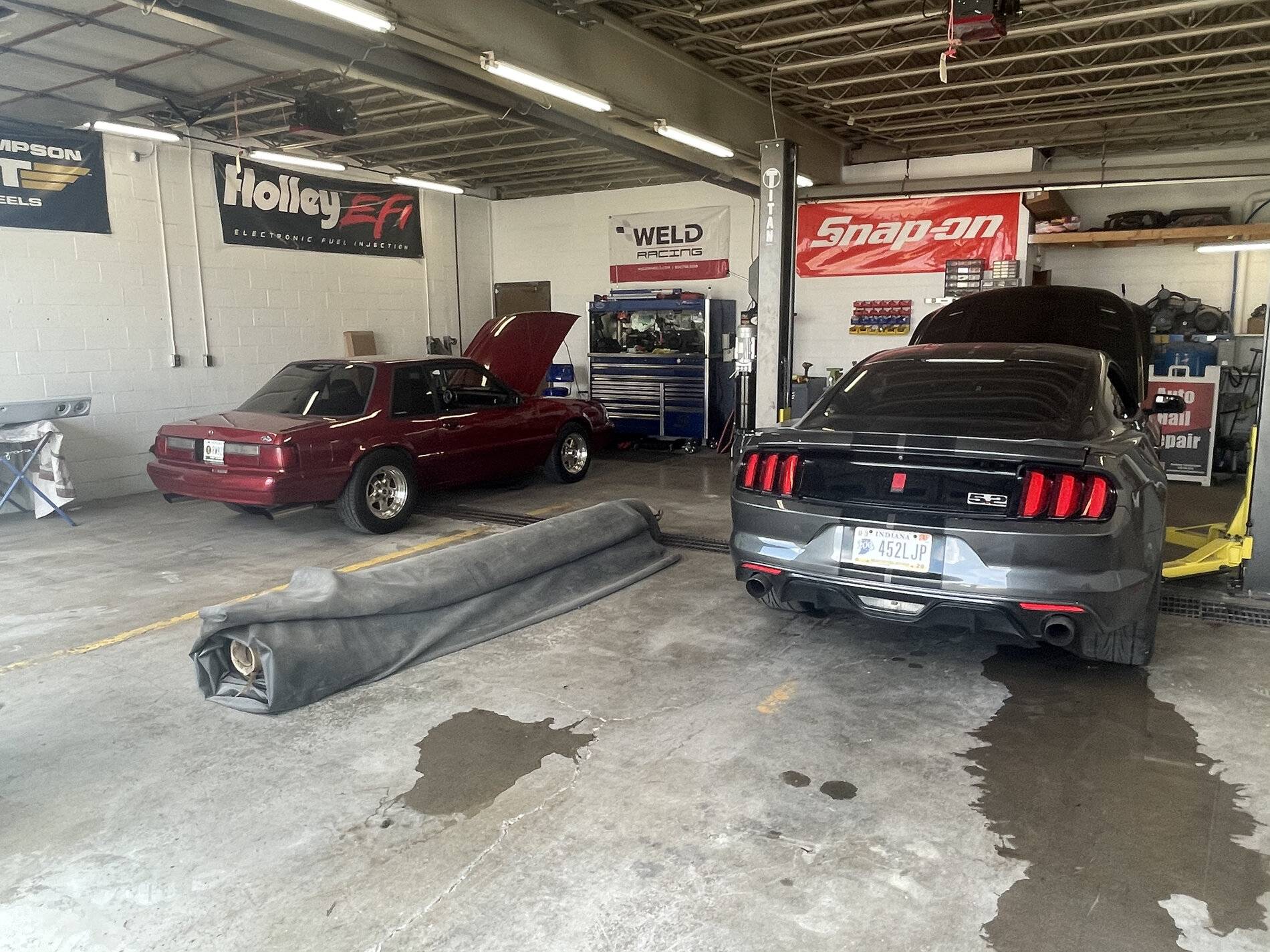

Engine and clutches in transmission broken In (I think ) after 400 miles .
Got logs of WOT pulls after first oil change (driven )
Logs look good . Initially thought I had slip on one pull but looks like wheel spin on the logs .
Also picked up cat less pipes from forum member .
Getting close to to making first pass this year but I may put it on the dyno first .

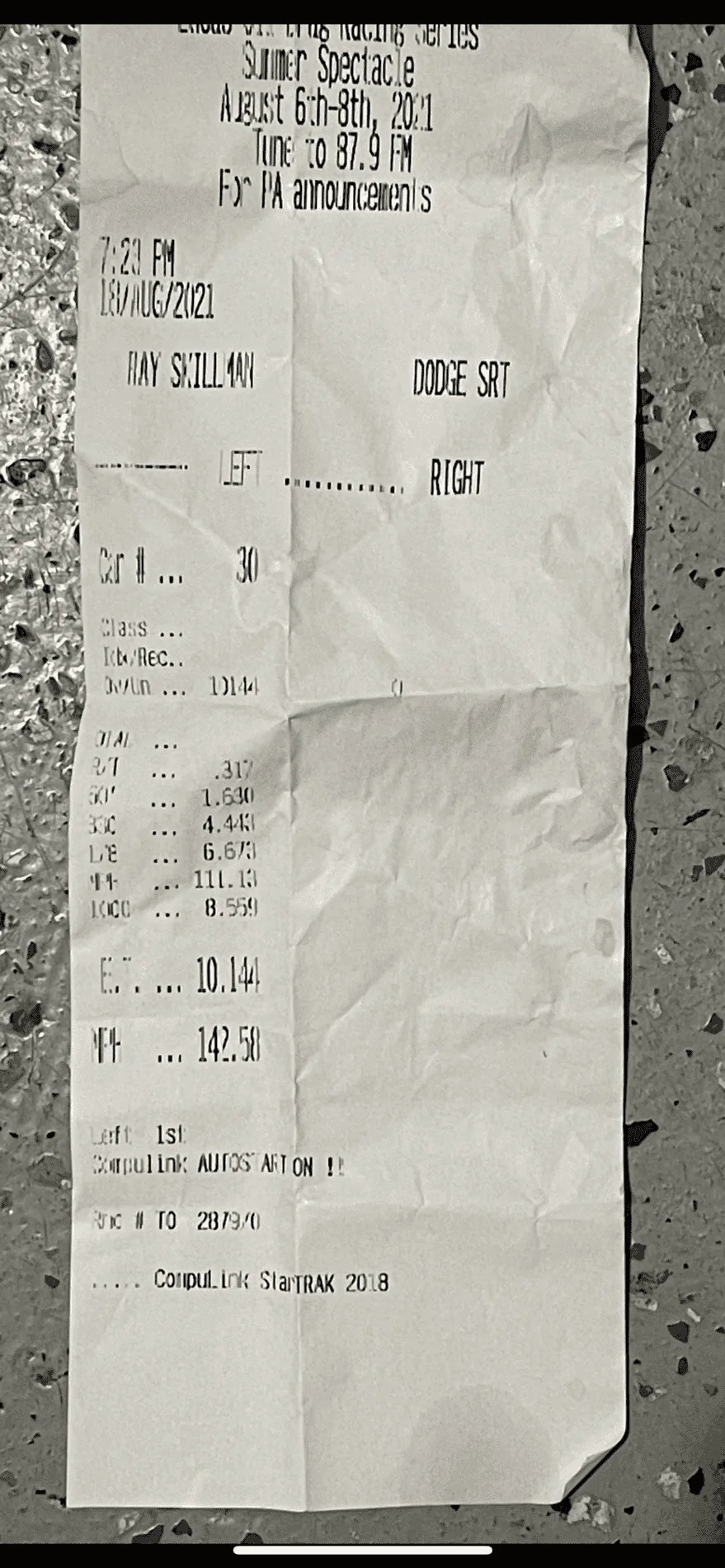

I got a couple of shake down passes last week .
I was hoping to have the cats off before but the v band clamps my guy ordered did not arrive in time ... so I decided to run with the cats anyway ... kind of rolling the dice on melting them but very few days left this year(closed this week ) to run and yet to make a pass this year .
PBD second gear leave tune /3.75 upper .
First pass :
I was not sure how high to stall with stock converter so I left like I do with the first gear leave tune @1700.
Tires spun and had to pedal a bit , car felt strong but it was short shifting @7k .
10.4@143 - 1.7x 60 ft so kind of disappointed but it was hot and humid with DA close to 4000. Active exhaust also stock in normal and cats probably cost 4-5 mph so trap is not that bad . it’s similar to what car trapped 2 years ago with old motor with 3.25 six rib pulley(equivalent boost )no cats in 500 DA .
Second pass .Dropped tire pressure a bit and left a little higher . 60 was a little better at 1.6X and ran quicker -10.1@143 still shifting at 7K
Third pass
went back to first gear leave but just blew off tires, shiort shifted 1-2 and got out of shape so I lifted .
Car felt strong on first 2 passes although they flagged me after the first pass for blowing smoke .
There was nothing in my tall pipe and logs looked really good so i assume it was just oil left after motor failed .
No smoke on second pass .
I noticed it did not run as straight as I remember so may be effect of losing the front sway bar .

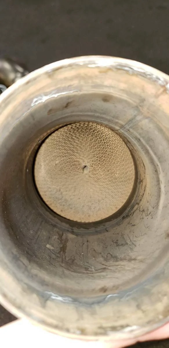

Got revised tune and cats are now off . They looked good when they came off . System. is modular so I can go back and forth easily.
Car sounds so much better now (still not loud ) and my butt dyno tells me it picked up quite a bit of torque .

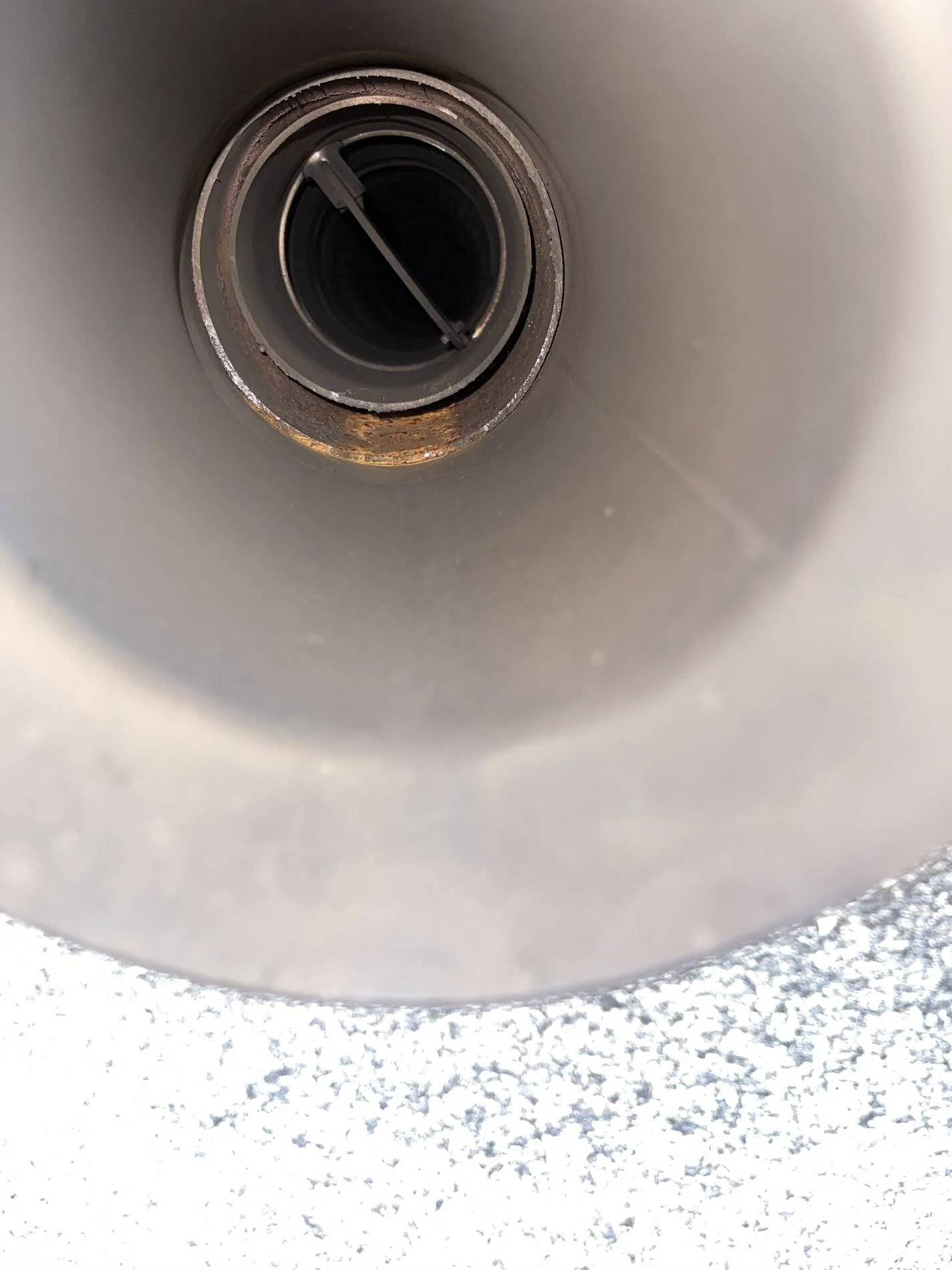

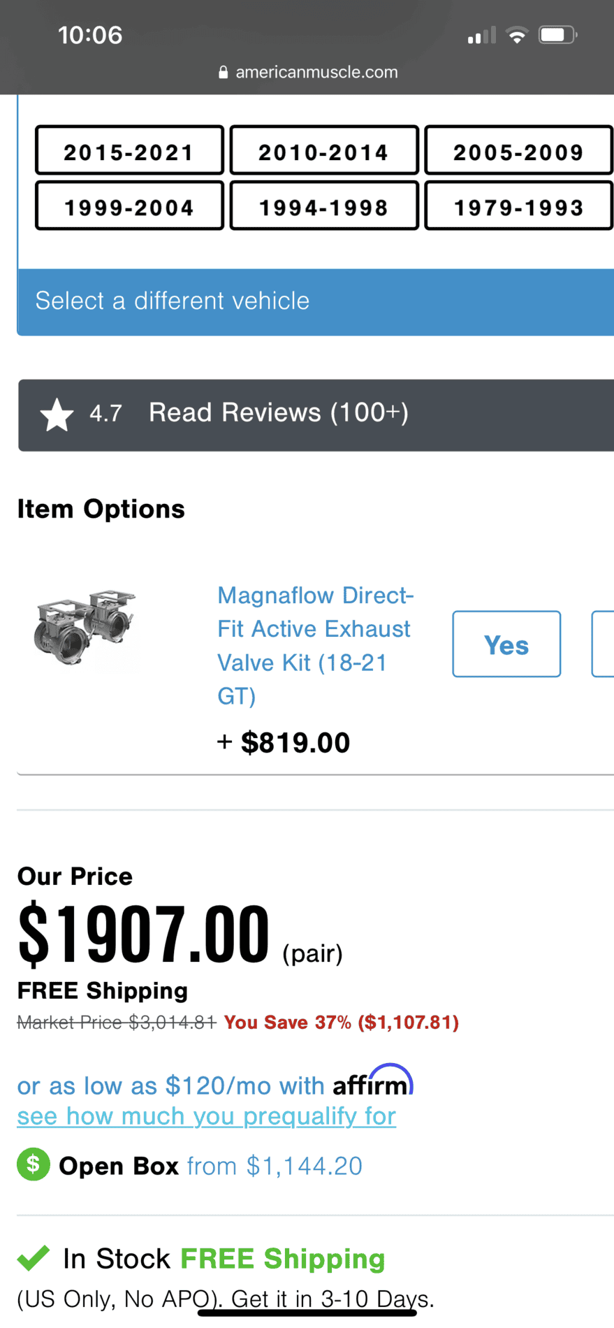

I know the active exhaust does that on the GT350 but i never noticed it on this car .
We checked all the wiring /plugs and it looks like it is the actuator on the passengers side that’s bad . it seems the valve on that side is the one that gets stuck at times then every thing stops working .
I am going to see if i can get it fixed under the power train warranty and if not i will order a new actuator.
We disconnected the active exhaust and found out to my delight when you do that it stays in race mode !

I thought at first it was not too loud with active exhaust disconnected (permanently in race ) but it gets tiring and has a drone at times
I now think it sounded perfect in normal mode (nice and smooth/no drone ) so definitely going to replace that actuator with or without warranty (it’s only $145 and it takes 3 mins to replace ).
I have been looking over the logs of the last passes and not only was it short shifting at 7K , it looks like it may be rich —Lambda is perfect at 0.77-78 but STFT are pulling 12-15%.. The timing also gets ramped by rpm . On the street logs I don’t see 21* until 7500... and considering it‘s shifting at 7000 rpm , its leaving power on the table.
No logs yet of new tune .. but going to ask Rob to make sure those concerns are addressed along with shift points .
