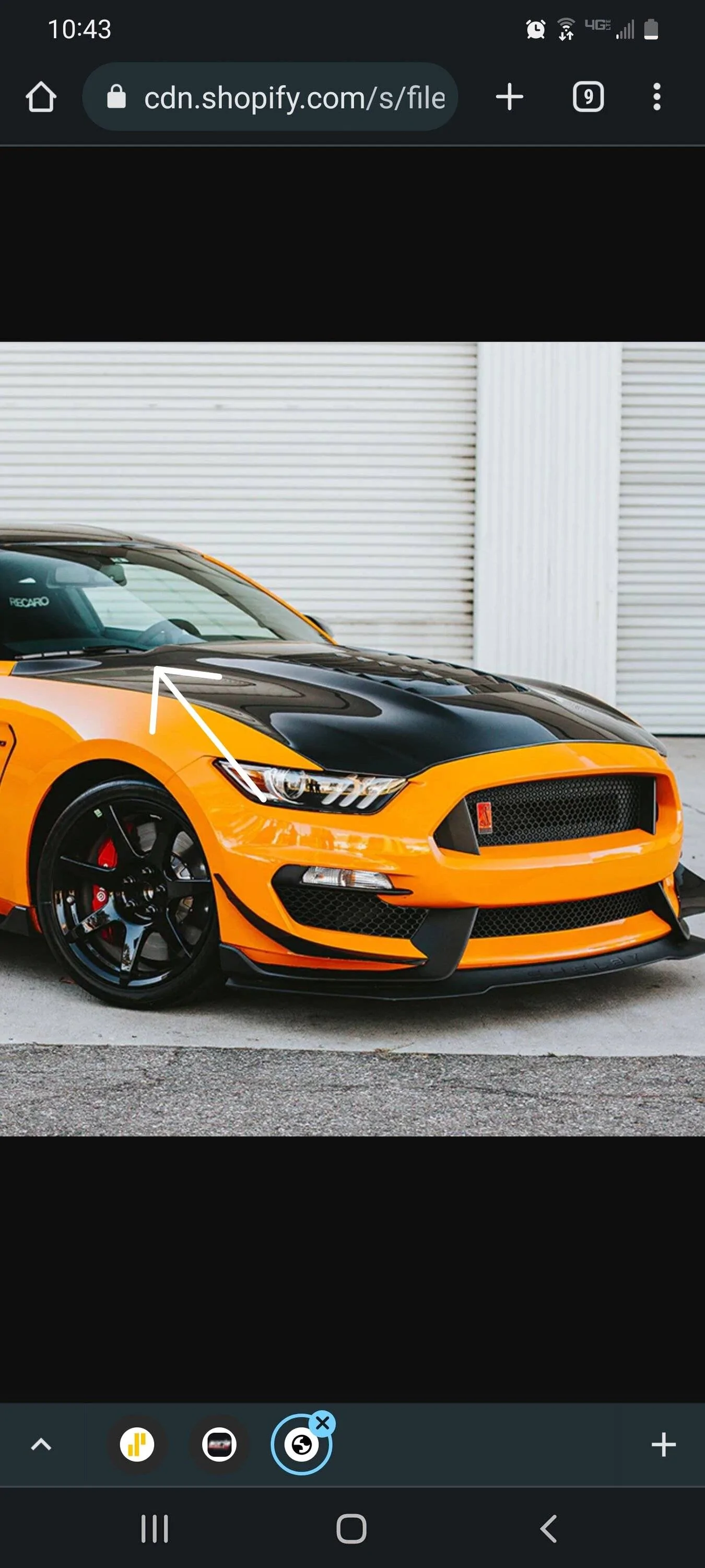

from a couple of pictures it looks like it would have extra clearance but idk

if you have instagram, go to @ibcelln_fords . The orange one you post is his (Christian's)car. You can ask him

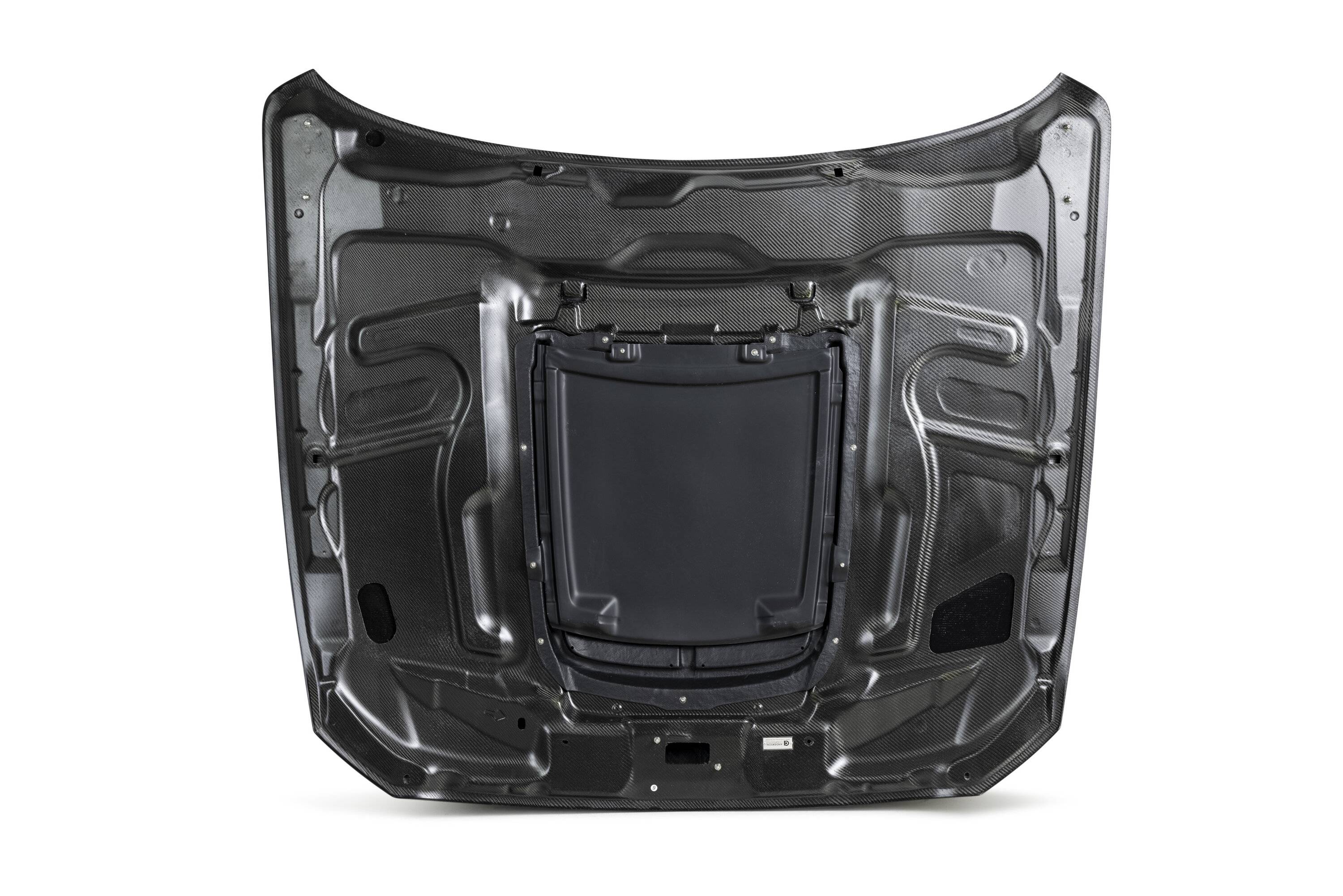

Fundamentally, the question is whether you meant there's 1" additional clearance between strut tower brace and the underside of the hood as compared to an OEM GT350 hood.
The bottom of the hood with the added vent required approximately 1" added to the center to clear the strut bar. So if you changed or added height to the engine intake system over stock, you would technically still have hood clearance issue. See backside image attached.

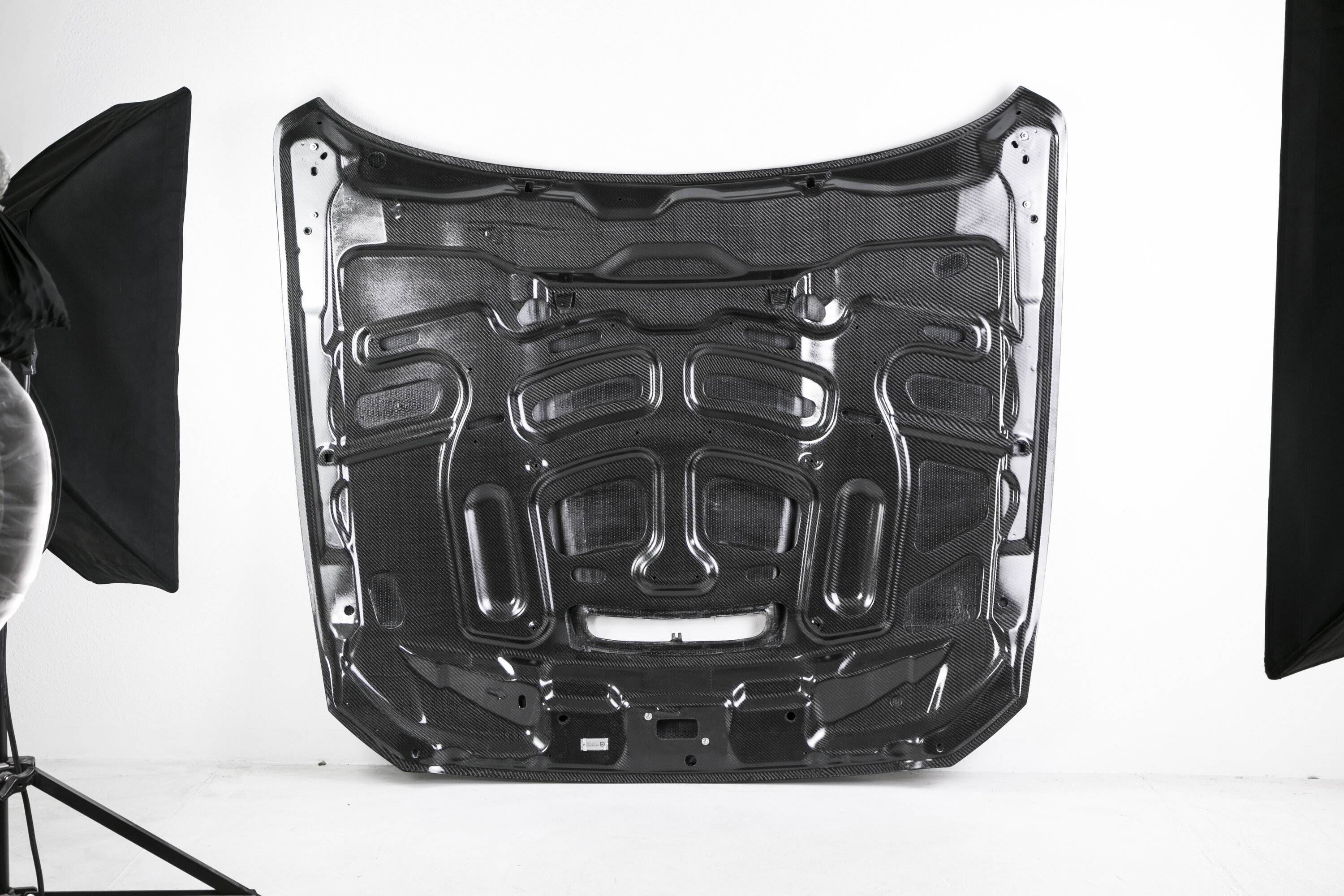

thank you for the picture do you have one of the underside gt350 carbon hood for comparison also how long are lead times on the gt500 style hood very interested
Lead times for in-stock items is approximately 20 business days. GT350 Type OE hood image included here.
