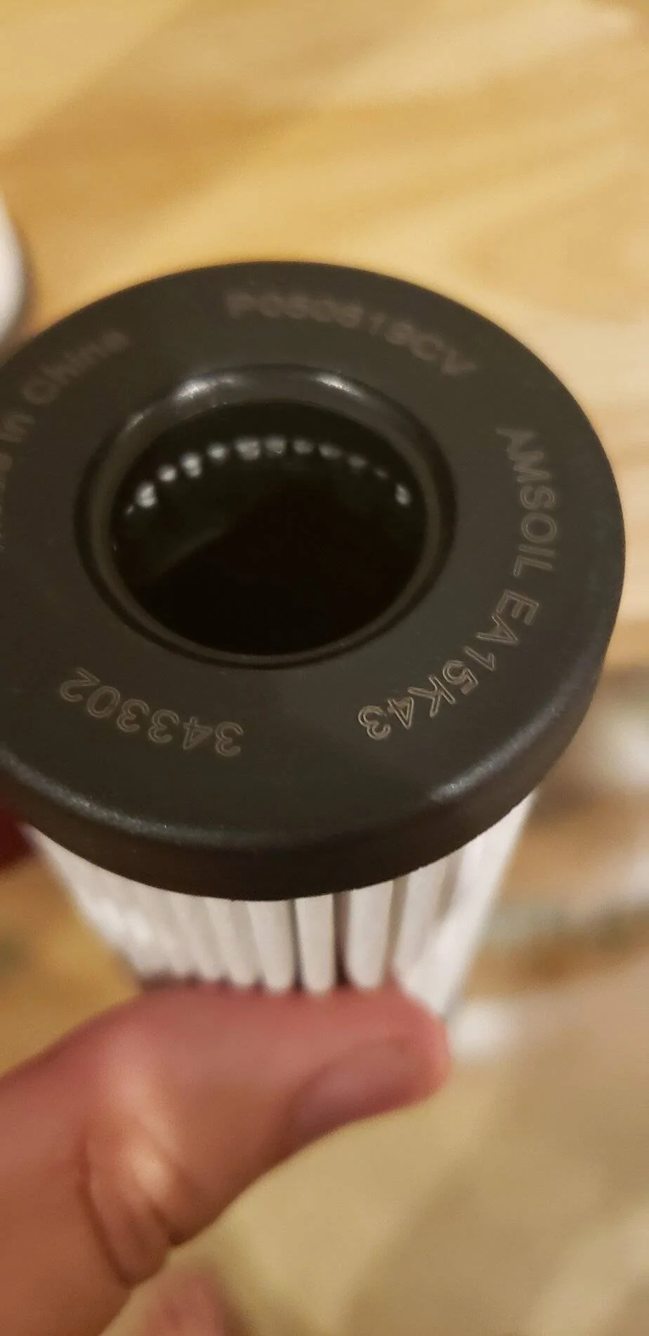

Amsoil does have a filter. EA15K43
It shows up when I search my '17.
It doesn't show up when you search for a 2020 because their part number cross references the 2062. Now, I know what you're thinking "my car doesn't take a 2062, it takes a 2087". It's. The. Same. Damn. Filter. sans the internal structure (for the Ford filter). Dimensions, fitments, media, all the same. Because of this, (last I checked with Amsoil, which was a while ago) Amsoil had no plans to arbitrarily update the cross reference for the 2087. I disagree with this and think they should update the list.
But, their justification is the Ford update to the 2062 to turn it into a 2087 did not drive a change on the Amsoil filter. Why did they not update the cross reference? Liability reasons?? IDK. Just providing the info.

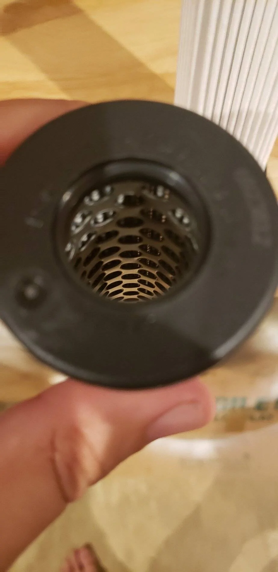

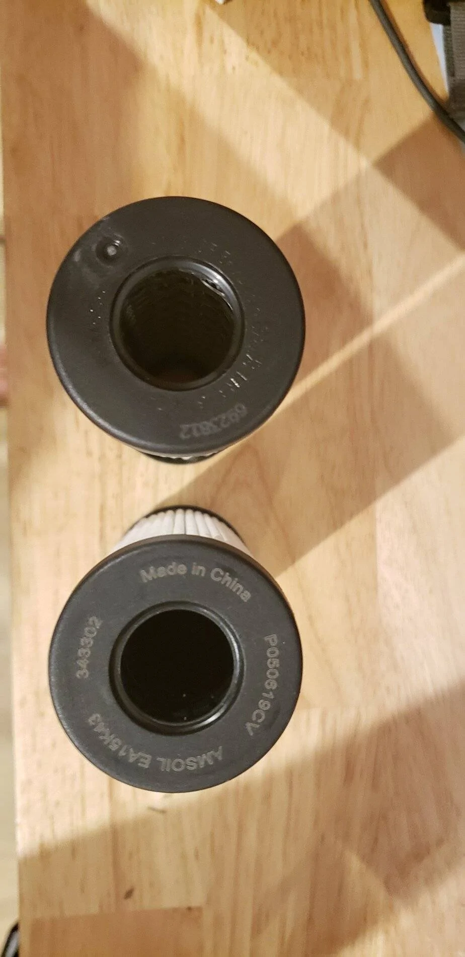

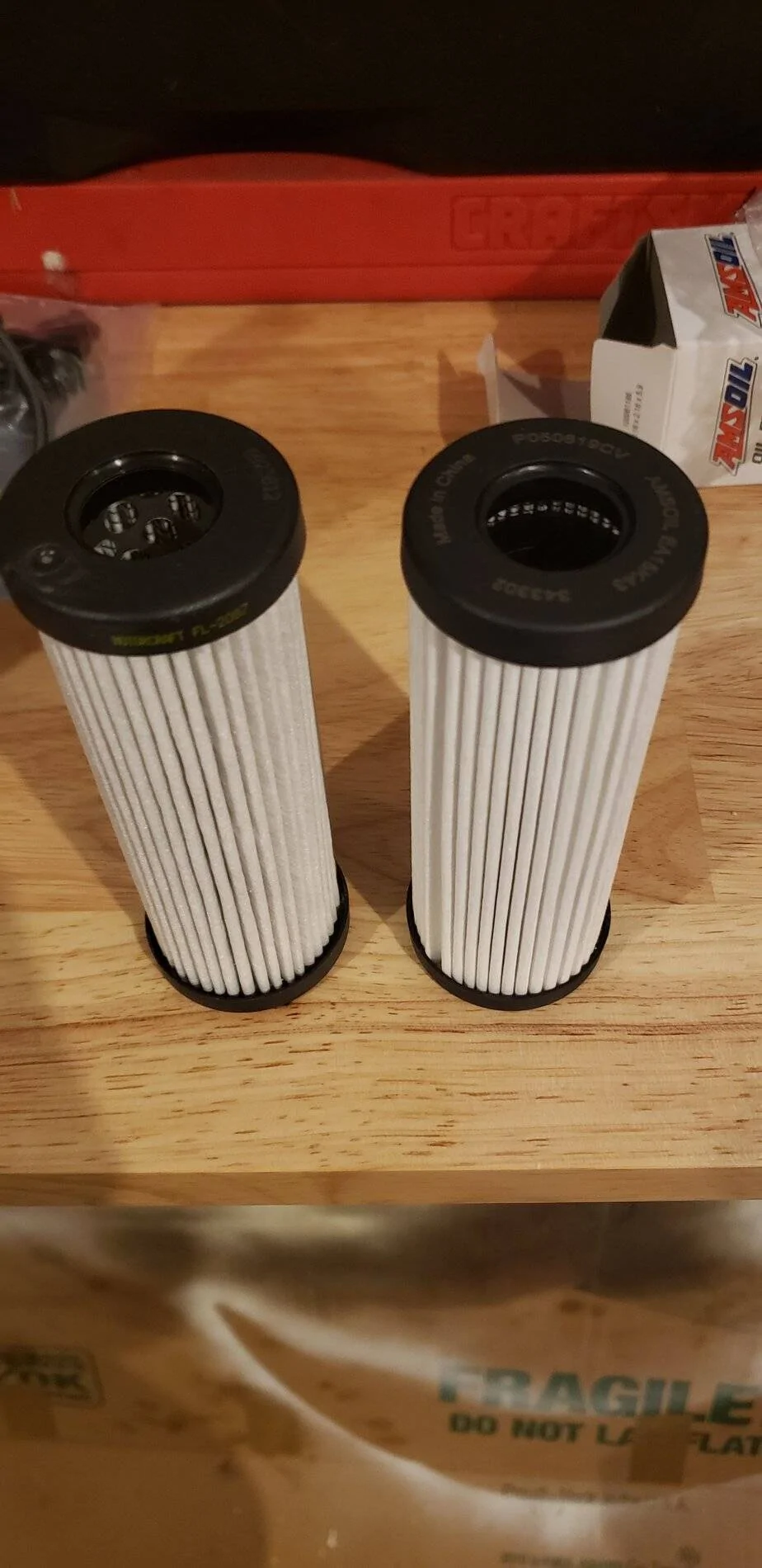

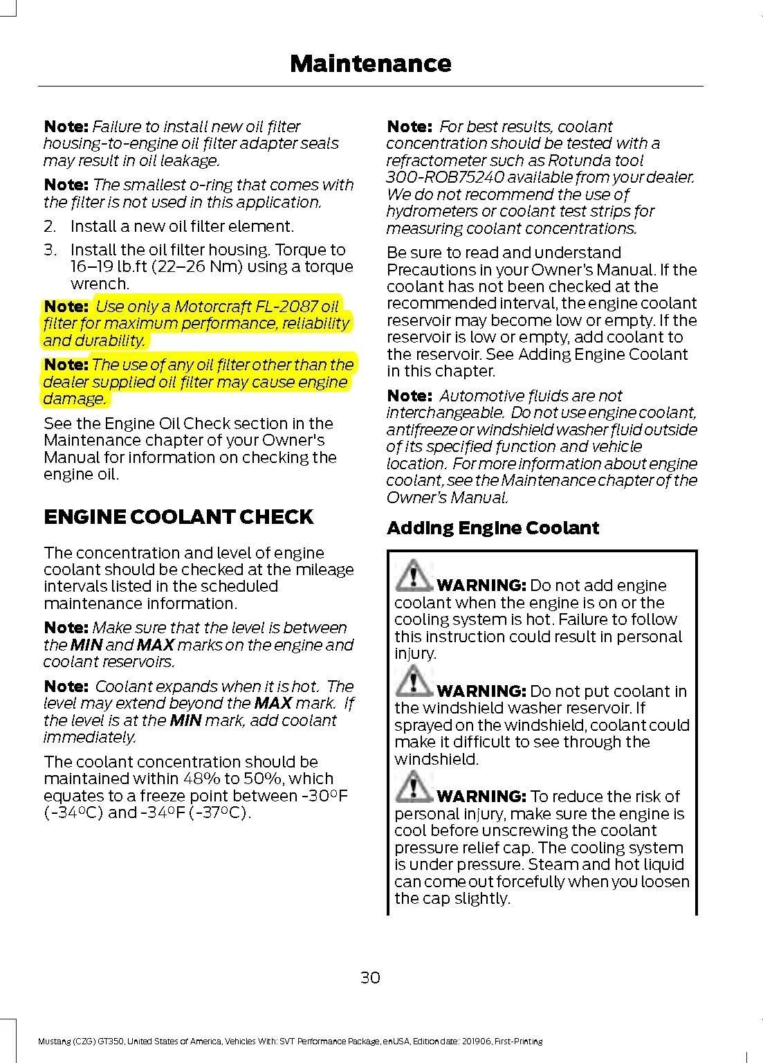

Ford changed the filter design in 2019/20. I purchased both to see the difference. Media now looks identical (synthetic) but the Ford now has a steel liner inside. Additionally, the supplement is pretty specific about using only an FL2087 or damage can occur. See pics for reference. I use Amsoil SS 5w-50 w/an MC FL2087. I feel the Motorcraft filter is a better design.
Again, comfort levels vary, but remember those are blanket statements they make for liability purposes at best, and to try and drive you to use the dealer and Motorcraft products at worst. Those notes are not binding nor mandatory, and no different than the standard oil spec statements. As with oil, some of these aftermarket filters are on par with, if not superior in quality and performance. Your odds of failure or problems with another filter is unmeasurable or probably lower than Motorcraft. Of interest to me is that someone will use Amsoil oil but not the filter based off that statement in the book. One carries no more weight (no pun intended) than the other.
I chose my mix as the manual states you can use an oil that meets wss-m2c931-c spec. It, however, does not say that for the filter.
