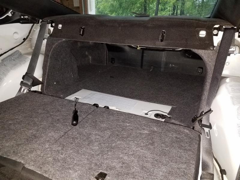

The side trunk liners are held in place by push pins under the back seats. I believe they may be obscured by the plastic in the rear of the car:

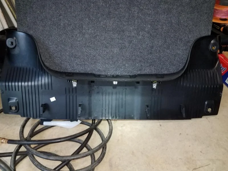

After removing the screw on knobs in the rear, the black plastic piece has to be pulled off of the studs and then up and forward. See the fingers and clips in this picture of the rear of the black plastic rear trunk liner. When reinstalling, you have to tilt the four bottom hooks into the holes while trying to seat the three clips and get the holes over the studs. You can see on mine tht the holes are pretty chewed up from the three or four times it has been pulled off and put back:
thanks again.. I was able to get the piece off using your advice..Getting it back on was a bit of a task. I had the inner clips on, but when I would push down to seat the top plastic pieces into the holes they would pop back out... not sure if it was becuase of the adding dynamat under the liner? was finally able to get it to snap in..then put on the connectors
