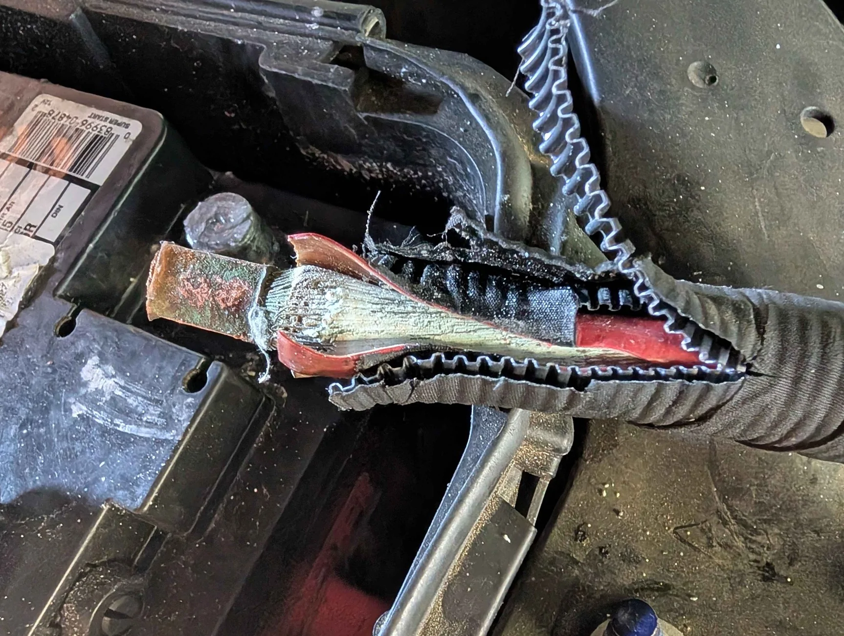

Hi, im new to car audio systems but want to learn, i was wondering if anyone knew what size amp for a single sub can be installed on these cars and not cause any issues with stock electrical components. i have a 2015 gt premium with the 200amp alt. but last time i added a 800W rms amp and sub the cars battery while running would dip into the mid - high 11v and ended up cause misfires and other problems. had the same problem happen with 2 different setups. is there a different way you need to wire an amp and sub up with the BMS in these cars? any help would be greatly appreciated thanks in advance.

the set up i had before was 800rms at 1ohm and i made sure it was wired for 1 ohm, i recently found and fixed my positive wire going to the battery in the factory harness as it was super corroded about 5 inchss down inside the wire so im hoping thats what was causing the poor electrical and misfire situation. im still iffy about adding a subwoofer just because i dont want to cause any more misfires though. fingers crossed that was the issue.
Im betting this was your problem. In the future, try using some dielectric grease and a piece of wire shrink. It will help to keep the moisture out. Thats what I did with mine

That definitely didn’t help. The condition, size, and length of the wiring is critical.
