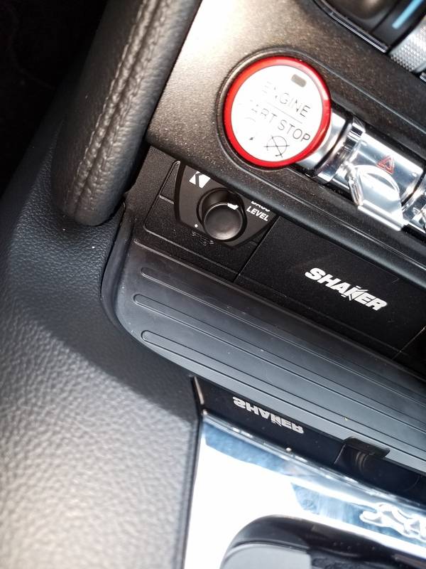

@Boggus : Pics of knob mounted in console? I just found out that the "Shaker" plate right above the coin tray is hollow behind it (suspected that) and just pops out without having to remove the center console. Did not know that part. This was a :doh: moment b/c I could've mounted my remote gain knob there rather easily. That location is really the only one I preferred. Easy to get to, yet out of the way. The first area I thought of was the plastic panel under the steering wheel, right above your knees, but there is an airbag there. :eyebulge:

I would have mounted mine in a different spot but the knob shaft was not long enough (heard that before). So it ended up in the console. Rather have it on the shaker plate.
mine is mounted down there, but not in the center, knob would be too hard to reach, so I removed the usb port (which wasnt working since I replaced the console port with a dual port

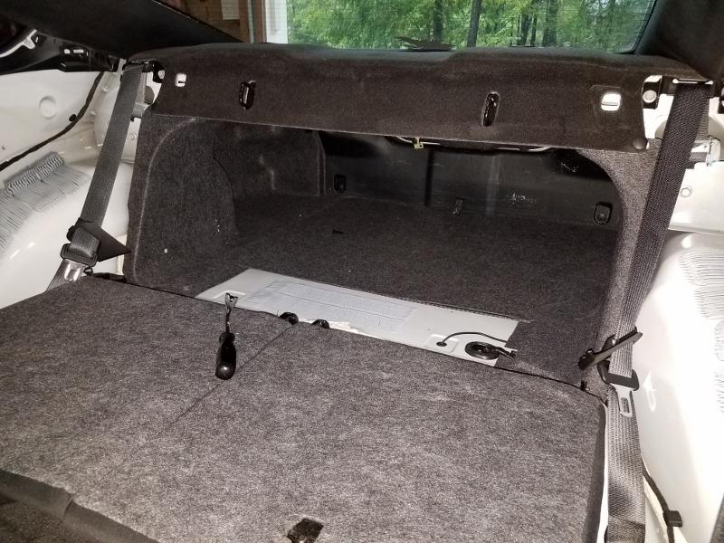

Curious what "hump" you guys are referring to in the spare tire well? Are you talking about the upside-down u-shaped bracket the spare tire bolts down to? :eek:
This thing?
I would think the force needed to hammer that flat would distort the spare tire well pretty badly. If it was really in the way, you'd be better off using a cutoff wheel to just cut it off as flush as possible and grinding the remainder down flat. As I found out when Dynamatting it, the spare tire well is pretty thin-gauge metal, as compared to the rest of the body. Me leaning my weight on certain sections made it "pop out" towards the ground. Scared me a little the first time it happened.

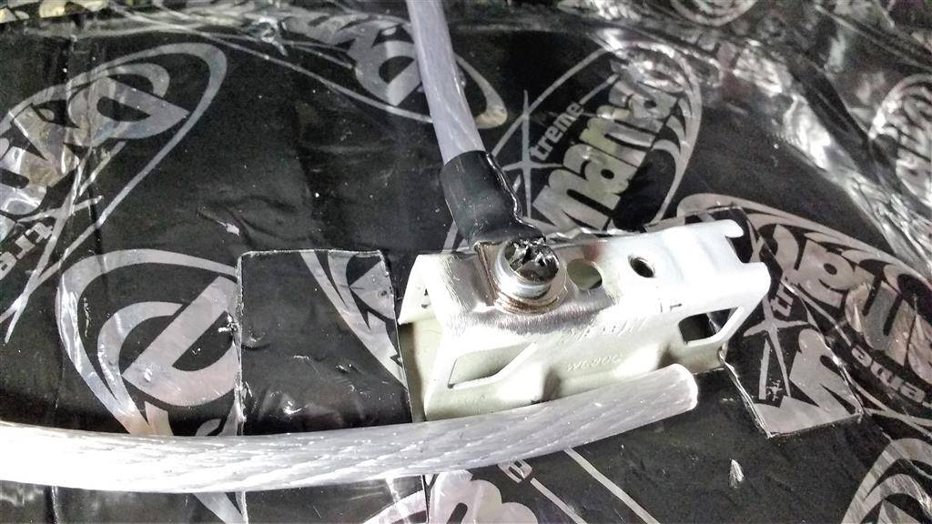

Just wanted to check back in with a few more questions. I finished my install today using a Rockford Fosgate R500x and an old sub I had lying around to test the system. Unfortunately the amp starts up in protect mode but it does turn on, the remote and power seems to be ok. However I believe my ground is whats causing these issues for me. Whenever I connect my DMM across the power leads while the amp is off I'm reading around 11.5V-11.9V but once remote power is applied I'm dropping like 3 volts to ~9V.
Could this be due to my ground? I don't really trust the connection, I used the bolt holding down the back seats but only had fine grit sandpaper. It's ground down as good as I could get it but obviously something is up. Is there any other good grounding points other than the one holding the spare tire? I don't have the hardware to bolt it there and I don't particularly want to go searching for that stuff.
Also did you guys ground your LOC? It says in the manual to ground if the amp doesn't work but most installs I've seen skip that step.

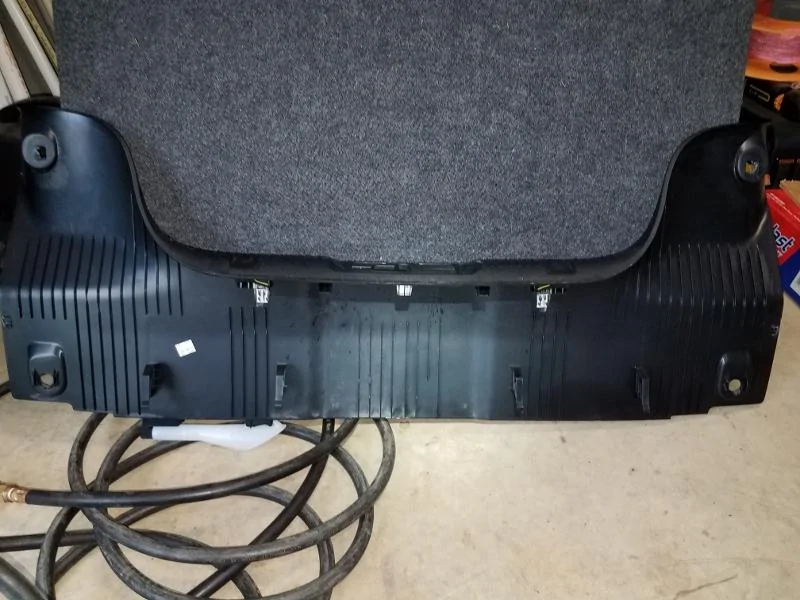

Hey, I am going to by dynamatting my trunk this week.... I am trying to find a video that shows how to remove all of the side panels from inside the trunk but cannot find one... I removed the push/snap in pins, but I am not sure how to get the trunk coverings to come off of the bolts that are sticking out on the inside by the tail lights.. I removed the plastic screw cap, but cannot get the liner material removed without the plastic molding getting in the way..any ideas?? Thanks...
wjfawb0
Jul 16, 2016
35
Chattanooga, TN, USA
2015 Mustang GT
The side trunk liners are held in place by push pins under the back seats. I believe they may be obscured by the plastic in the rear of the car:
After removing the screw on knobs in the rear, the black plastic piece has to be pulled off of the studs and then up and forward. See the fingers and clips in this picture of the rear of the black plastic rear trunk liner. When reinstalling, you have to tilt the four bottom hooks into the holes while trying to seat the three clips and get the holes over the studs. You can see on mine tht the holes are pretty chewed up from the three or four times it has been pulled off and put back:
