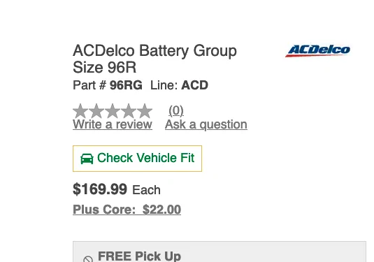

Before you go auto zone check out ORilleys and look at this battery. A 10-year-old AC Delco, was not giving any problems, just changed it because of its age.
This is the Mustang direct replacement 96R, ORilleys may change it, I remember seeing some signage saying they were doing some curbside work. Cause I trust my skill sets I did not pay attention.
