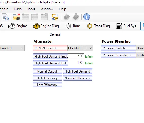

The alternator's output is PCM controlled... meaning it will not output full power unless commanded. There is also a battery management system that manages charging to prolong battery life - it may need to be reset since you've changed the battery.
I have an aftermarket stereo - 800W and 1500W amps - and the alternator could not keep up .. I was experiencing major voltage drops when I turned the stereo up past a certain level. I spent months searching for a reliable fix and pretty much just gave up... I was going to install a second battery in my trunk this spring to see if that would fix it. A few months back I had the car tuned and after that I noticed that I could crank the stereo without any of those issues - looked at my voltage display on the dash and it was pegged at 14.6V, never moved.. I am assuming my tuner disabled the PCM alternator control/smart charging... not sure if this would help in your case, but figured I'd share my experience.
EDIT: The sensor that was mentioned a few posts up is what lets the PCM know how much electrical draw there is so it can command the alternator accordingly. Definitely have to run your additional grounds from the Big 3 through that somehow or disable the smart charging system. The sensor looks like a plastic loop around the negative battery cable with a small wire coming off of it -- if you look in the battery box area you'll see it

Here's a screenshot from a sample file - PCM Alt Control. I don't have the ability to open my tune from PBD as its in nGauge format, but this is what I am assuming they disabled.

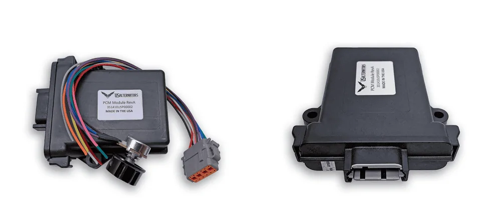

You could always get a PCM Voltage Control module from US Alternators http://www.usalternators.com/pcm-module/ (They are about $220)
The PCM module gives you full control of voltage and keeps voltage at a constant number. The newer cars come with a smart charge system which raises and lowers voltage to save fuel and to extend battery life. This PCM Module system works with that system to deliver a higher voltage all the time when aftermarket electronics are added.
They also have high output alternators for the 2017 Ford Mustang Ecoboost
Large Case Hairpin Line
- 285A Peak -- 250A HOT - $499
- 320A Peak -- 270A HOT - $599
- 410A Peak -- 390A HOT - $699
