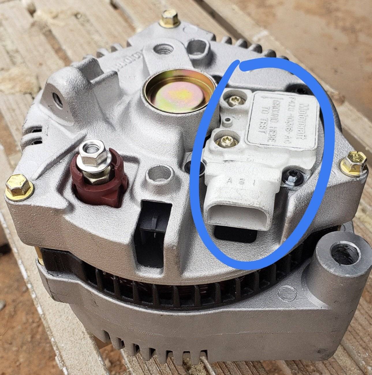

This is a totally random alternator image pulled offline to show the placement of a modern voltage regulator (circled). You need a security Torx bit to remove it. Voltage regulators are available at many parts stores (brick and mortar or online places like Rock Auto)Super easy to replace…
I believe your initial problem with the stock alt (before you bought a replacement) was a failing voltage regulator which costs far less than a complete alt replacement. This is where many (dishonest) Servicing Dealers and private garages rape people by telling them ā€œyou need a new alternatorā€, because they know the voltage regulator costs far less - but they can ā€œka-chingā€ the customer with a much larger bill for a complete alt replacement.

We aren’t dishonest or raping people for not replacing a voltage regulator. The part is not available from ford only the complete alternator. Im looking right now and cant find it. Sad fact is that was long ago and if you can find one on the internet it’s probably a knock off and won’t work. Its not the mechanics its the big corporations squeezing every ounce of profit they can while reducing quality.

I believe the voltage regulator is part of the PCM on the S550 mustang and not on the alt.
Skye
Jan 18, 2022
3,009
4,205
ā‰ˆ39N
"Skye" Mach1 N2144
From the readings I have, the regulator is integrated into the alternator.
"414-00 Charging System - General Information Description and Operation"
"The PCM controls the voltage regulation setpoint and communicates this information to the generator internal voltage regulator over a generator communication (GENCOM) communication circuit. "
"The PCM controlled Smart Charge charging system determines the optimal voltage setpoint for the charging system and communicates this information to the voltage regulator. This system uses 2 communication lines between the PCM and the generator/voltage regulator: A generator communication (GENCOM) line communicates the desired setpoint from the PCM to the voltage regulator, and a generator monitor (GENMON) line communicates the generator load and error conditions to the PCM ."
