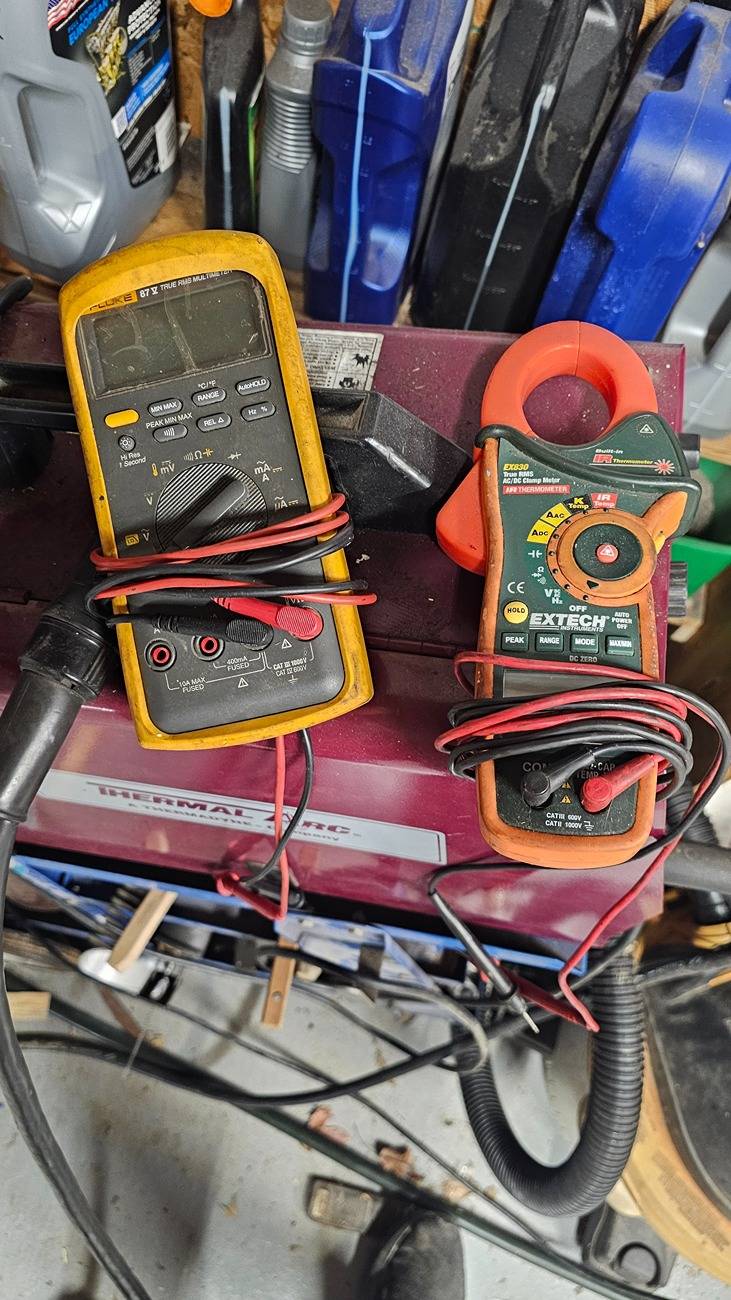

I use clamp on meters. The days of having to wire in an amp meter are long gone.
K4FXD & Garfy. I'd REALLY love to have a high quality inductive current probe for my meter. Sensitive from 100s of Amps to a few uAmps. Where can I get a "high value" probe? Most that I've come across are a few hundred bucks. They also have a VERY limited current range. I'd need to buy several to cover the current range I'd like to. Too rich for my blood.

I got mine at Granger, does AC and DC. I really wanted a Fluke but I don't use one enough to justify the 800 bucks.
Yea looking at 100 to 200 for one. This is orange I forget the brand.

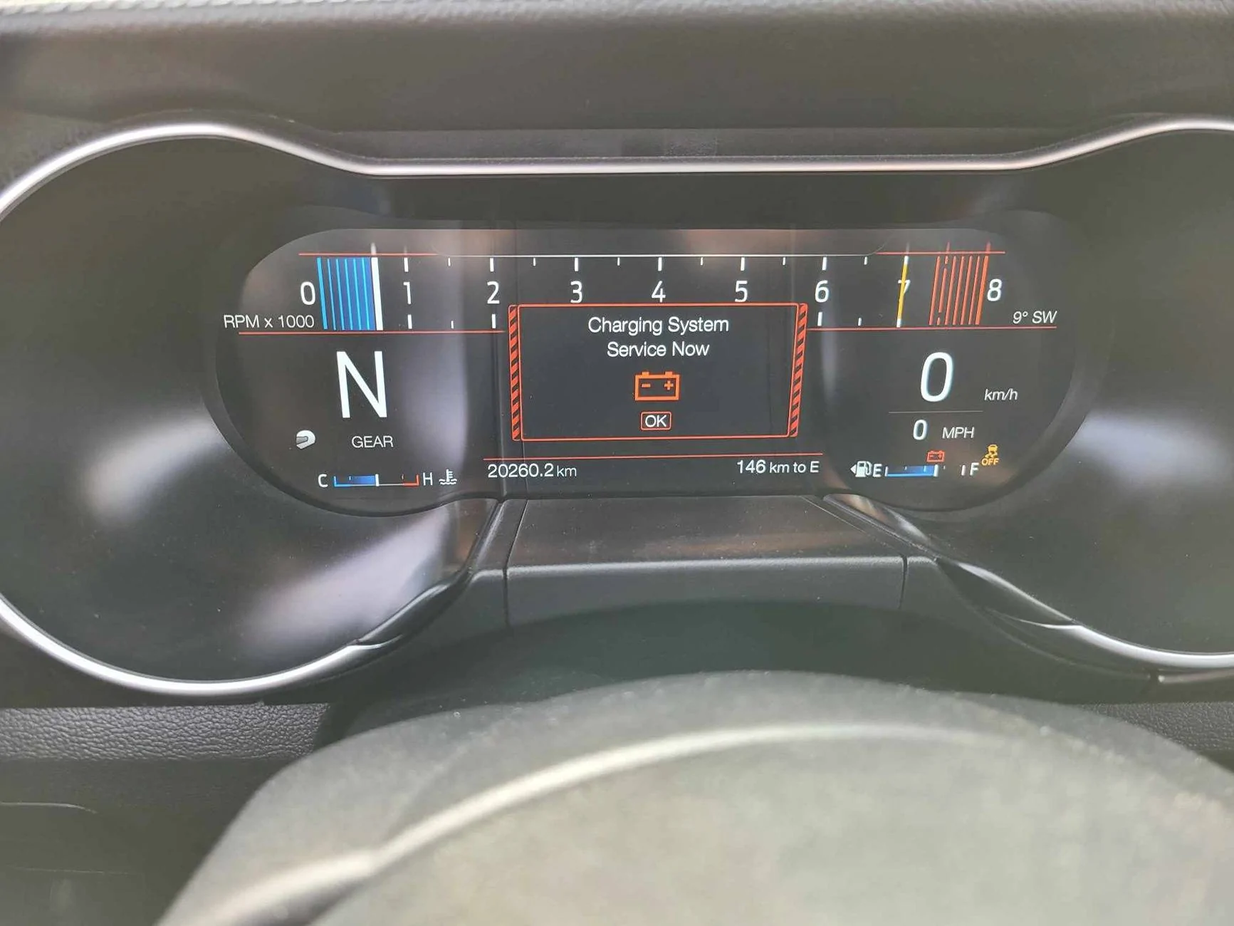

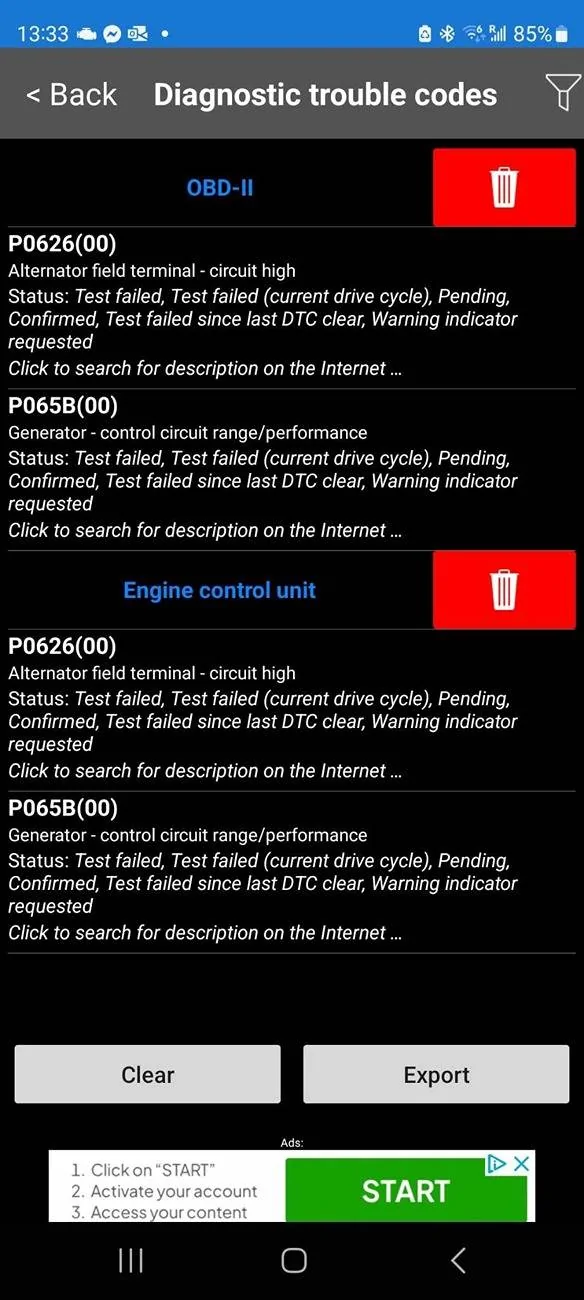

It’s my guess they don’t like the 8000rpm haha. I wonder what everyone else is using that is revving high. I did accidentally rev this one to 9000…
I ran my 2022 Mach1 at it"s 7500 RPM redline a few times at Watkins Glen International Track back in October 2024, because, who wouldn't at this awesome track. I ended up overloading/over-revving the OEM alternator internals. This led to a red error message popped up on the dashboard while I was still sending it on the track. In the paddcosk, I read and cleared the OBD codes, but they kept coming back. I opted not to test my faith further, ended my track day early, and headed back home. My dashboard indicated a constant 14.5V on my ride home. I apparently burnt the control module attached to the alternator (my speculative personal diagnostic). I got the alternator replaced under warranty.
I am getting an underdrive alternator pulley custom-machined, to avoid this from happening again out on the track this year ...
Also installed a chemical Fire stick in the car ...
