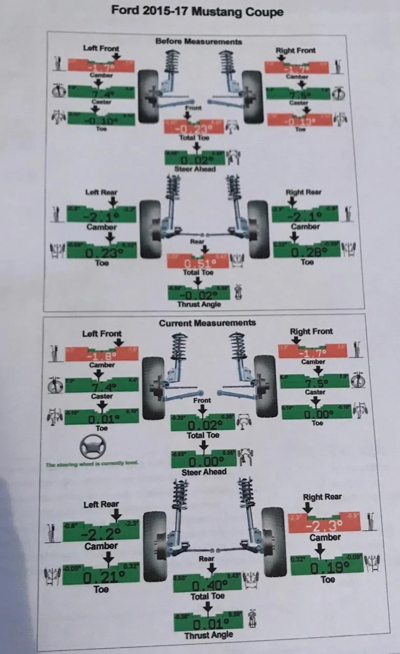

I just got my car aligned after installing Steeda progressive springs and they said on the front alignment it was the best they could do. I already communicated with Steeda but wanted to see if anyone was able to get it aligned within OE specs without caster camber plates. I just don’t want to wear my tires any faster due to alignment.

A tad high on rear toe and camber but overall looks good. The front camber isn't anything to worry about, particularly because you have no appreciable amount of toe. They should be able to get the rear camber to about where the front is if they push hard to move it outboard.

Looks pretty good to me, besides yeah, maybe more rear camber than I'd like. Toe on both ends looks good, and front camber is what it is. FWIW, I'm daily driving on a lot more front camber than that, you should be fine.

Thanks for the input I feel better about it. I was just concerned because I just bought new tires and was thinking they was going to wear fast.

That alignment looks pretty good to me. A lot of rear camber but it'll corner like a friggin' beast. :headbang:
