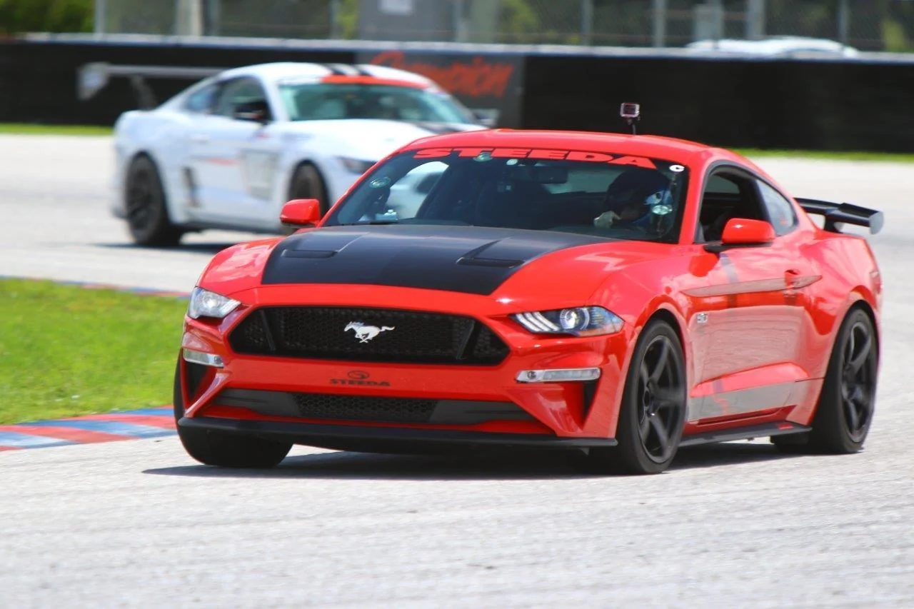

We have the Steeda Camber Plates on our HPDE and #20 car with outstanding results! Just over 2 degrees with standard strut mount opening and over 3.6 degrees neg camber with enlarging strut opening!
Fastest lap times on track this weekend at PBIR! Final testing was completed as well with our Road Race K-Member!
