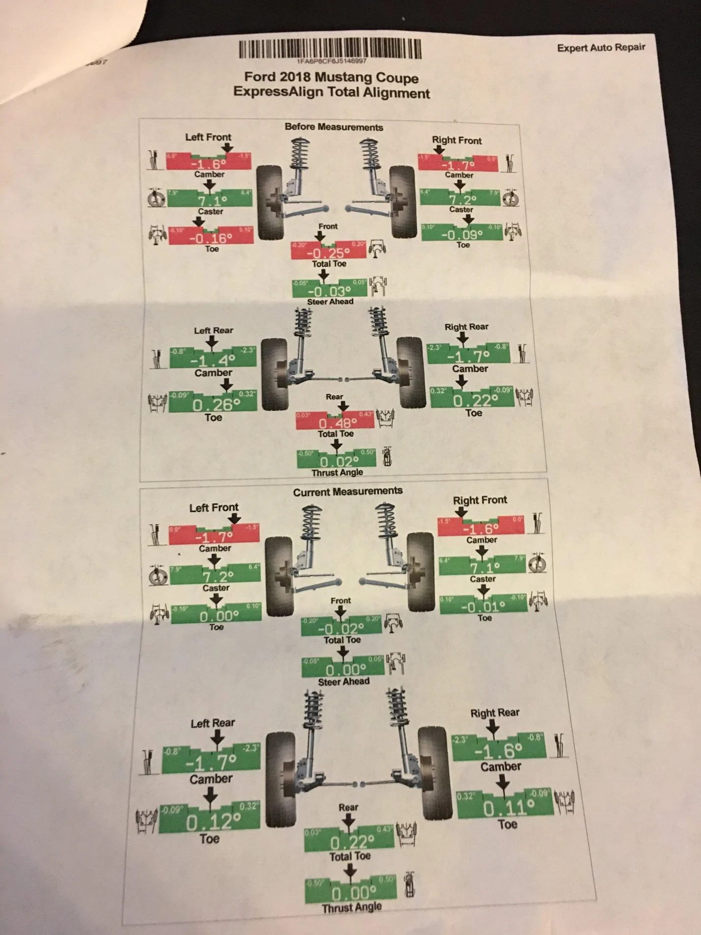

Is this alignment good for street/spirited driving? Lowered on BMR SP763 with CB010. Bushings were not clocked as they don’t provide that service.

Probably a little more camber in the rear than I'd suggest but fine. -1.3-1.5 would be better.

Thanks, I’ll bring it back and have them adjust it. Hopefully they won’t give me a hard time.

Yeah seems basically fine

Id be pretty happy with that. I tend to do my own string alignment because most shops shoot for the green range but those guys hit it pretty dang on the money with equal measurements on all 4 corners.
How does it feel driving?
Not much to clock if your PP. 3 or 4 bolts in the rear and 1 or 2 in the front iirc

It drives pretty darn good. Extremely happy with the set up. No more floaty feeling on high speed! The car just feels perfect.
Installed the BMR Sp763, cb010, PP shocks and struts, Gt350r front and rear sway bars, steeda IRS and G trac brace.
