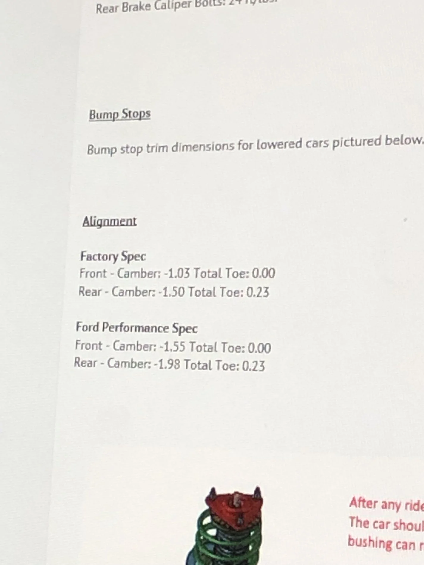

I have, essentially, a PP1 and will be putting on the parts in my signature soon. FP Magneride handling kit, with Steeda 4pt G-trac and IRS braces. I daily my car and only attend a few events a year. What so I look to get my Alignment set to after the install?

Look through BmacIL's post history. There's a bunch of posts where he's listed recommended alignment specs.

Reach out to Steedatech, he is a wealth of info.
