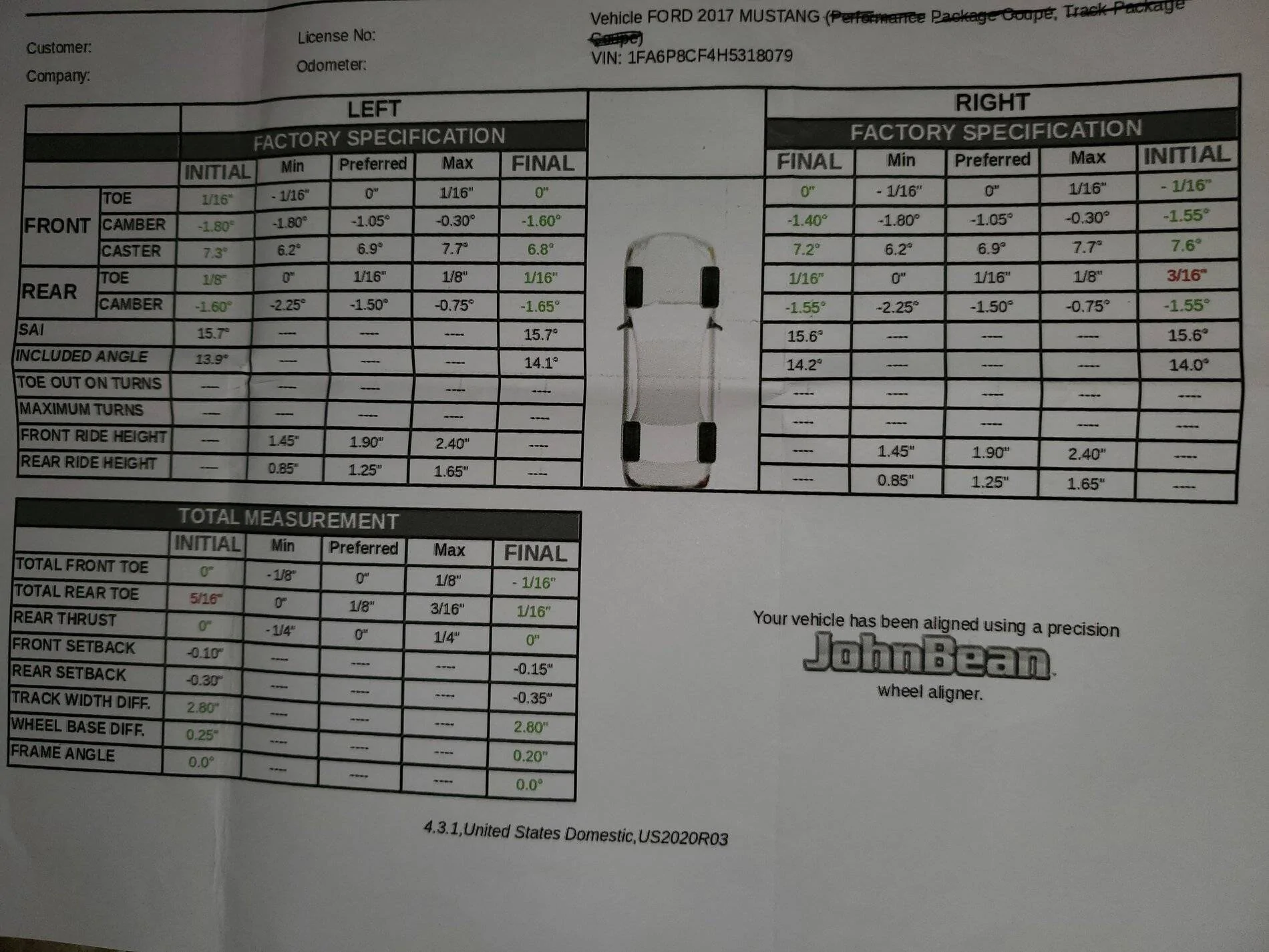

My back end jumps to the right when going over small bumps(manholes etc). It's getting worse and almost feels like something is broke the deflection is getting scary. And when I went around a corner under throttle and hit a little bump It felt like it was ready to jump right off the road. I've had it inspected and aligned.
Nothing was found but since the alignment it feels worse. Can any suspension gurus give me any advice on what this may be? I put my alignment sheet up because I can't figure it out. And the alignment tech might have thought my car was a PP would this make a difference? Can anyone make sense of it? Oh and it only deflects to the right rear never left.

Looks good, actually someone did a nice job (assuming alignment rack is properly calibrate). It sounds like a blown shock in the rear from what you are describing.

Your alignment looks good.
in addition to the above, I'd remove and inspect the rear shocks, a 2017 that's been driven a lot may need the shocks replaced by now. Inspect the bushings in the rear suspension for tears, and rear hubs for play.

Alignment looks great.
What’s the width and backspacing on your wheels? You have pretty large diameter tires and may be rubbing againt your struts, shocks/mounts, or fenderwells.
