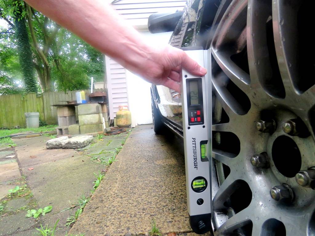

How curious?
This curious, under $50 for something you'll most likely use more than once and maybe for other things besides this?
That, and the right wrenches is all you need for setting camber yourself. Any resulting toe change can be measured using parallel strings and a small scale.

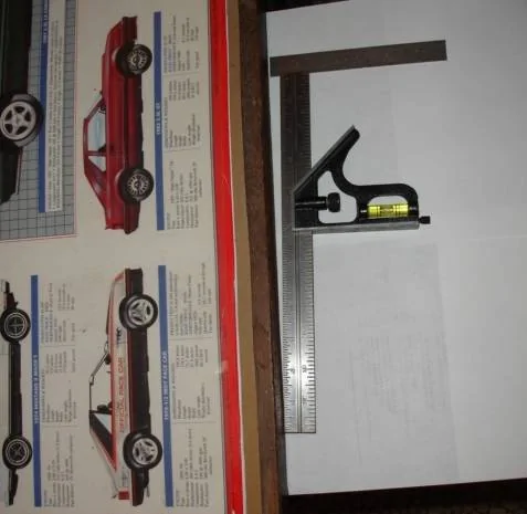

But you need a perfectly flat floor.
There are ways to determine flatness, and ways to correct out-of-flatness / out-of-level. Or you could measure the out-of-flat / out-of-level and account for the "out-of's" as corrections to your actual car measurements.
Since my car feels great now, will wait until either that changes, or need new tires. Then once I learned the current settings, depending on tire wear, we can modify it accordingly. Remember I don't have any shops I trust here, so not going to bother. The last time I check alignment here was on supposedly the best machine in town, and they managed to scrape both wheels and spoiler on the new Nissan GTR, but I had to do it to keep warranty.
There's no reason you can't make the best measurements you can, noting where you set the car's wheels. When I first started to do my own alignments back in the early 1980's, I was using this because nothing better was readily available.
