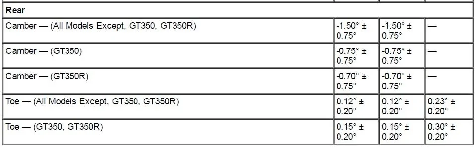

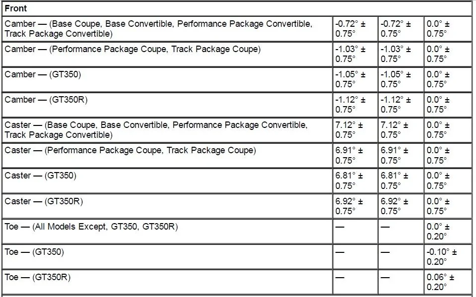

I have a 2016 GT PP with GT350r springs being installed. I want to align it to 350r specs, but can't seem to find the OE spec, does anyone know it?
If the 350r numbers aren't readily available, I'll go with -1.5 camber, 0 toe up front; and -2.0 camber, 1/8 toe in at the back. Any thoughts on that?
