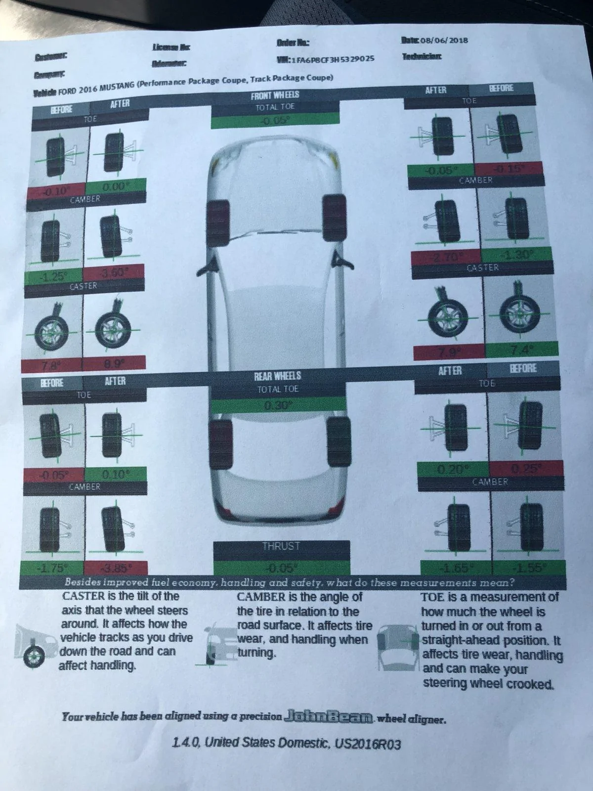

Hey guys,
I just put some BMR sp080s on my 17 GTPP along with some camber bolts. I brought it over to an alignment shop but it looks like the camber is way out of wack. The BMR springs have a very minimal drop so I’m surprised it’s so far off. Am I wrong, or is there room for improvement without buying any additional parts?

Am I reading it right? -3.6 and -2.7?

There's no way your Front and Rear Left camber is that high unless something is broken.

-3.85 and -1.65 in the rear sounds wack. You should be able to eyeball that difference. -3.85 is massive. If its true, thats a 1" difference at the top of the tire from left to right side in the rear.

It is actually visibly off. I will be taking it to another place Friday to get it sorted out by someone that knows what they’re doing. Thankfully I only drove about 15 miles a day until then. I’m going to contact their corporate office for a refund too this is horribly done

Take your car to Jeff Capelo at Westshore Automotive. Tell him to align the car and call me.

Good call. That is the worst alignment sheet I've seen (less cars that have been in an accident). Not only are your numbers off, but the sheet itself is a headache to read.

My suspicions are that your original alignment shop just didn’t get a proper reading. Sounds like the next shop you go to you’ll be in better shape.

If I’m reading that before and after correctly, that shop just made your alignment worse.

The "best" (perhaps most popular) alignment shop in the Atlanta, which was tasked with setting my front camber to -2.4 even on both sides, actually set my driver side front camber to -1.5 and passenger to -2.5. Naturally, my camber plates weren't even close in alignment. No accidents. No reason for that kind of difference. Took it to two other alignment shops just to validate that their machine must be out of calibration as I as worried something happened to me car... and after proving that was not the case, they told me that their machine is not wrong and that I don't know what I'm talking about. Stopped going there and later heard similar stories. I now take the car to either Steeda or a trusted friend at a Ford dealer.

Or learn how to do the job yourself. You could make adjustments based on just sighting down the sides of the car with no measuring equipment of any sort and do a better job on the cambers than what OP got.

I have BMR 81s up front and 88 (drag springs) in the back. I recently replaced my factory Pirellis with Firestone Indy 500s and I had camber that could not be adjusted out. The guy doing it worked at a frame shop and knew what he was doing and he showed me his adjustment was maxed out and he elongated the holes in the struts and got it right.
