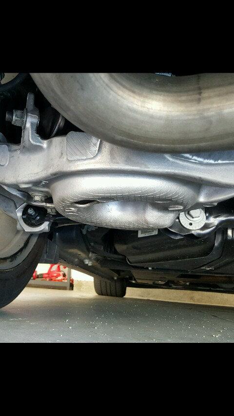

Hey guys. Just put the Eibach Pro on my 15 GT. First, do the attached after numbers look good? I ask because it feels fine, but sometimes when I nail it, it seems to ever so slightly feel like it has a momentary pull to the left. Not bad enough I can't hold the wheel with even one finger ;)
It's really tiny, and, seems more obvious if I'm in D vs S when flooring it, from a roll. I just don't wanna keep dishing out coin if these look acceptable. Otherwise feels great. Thanks all!!

Went to the orig install shop to have stocks put in, but thought hey lets first make sure all was tight, everywhere. Turns out, left rear lower control arm was loose!! Not hand tight, or even garage tool loose but long wrench on a lift loose. I had my doubts but it made sense ... torque, freeway, lots of weight was enough to effectively have "dynamic" toe and camber!
Crazy, and enough to almost make me go back to stock! So if u have it done, or do it yourself make damn sure that those links are extremely hand tight :)

Thank you for sharing. Which bolts?

Very happy to run down n snap one off :)
So its the 2 big bolts, to the left n right of the silver H arm craddle. What's crazy, is that I think one is for toe, so even if the install doesn't require it be loosened, alignments would, so I'm gonna be really anal about it from this day on!! Hope that helps :)

Oh just to be clear, they're the verticle bolts ... Left black, right silver

Ok just curious. Thanks for taking the picture.
I highly recommend the threaded toe links. Steeda and BMR both offer a set.
You can torque both those bolts and adjust toe similar to the front. Never have to worry about the cam adjuster slipping on you.
BTW: Your alignment settings are good enough. However if you had to tighten the cam adjuster (silver bolt on right) there's a very good chance you changed the toe on that side. If it drives straight don't worry about it. Otherwise check it again.
